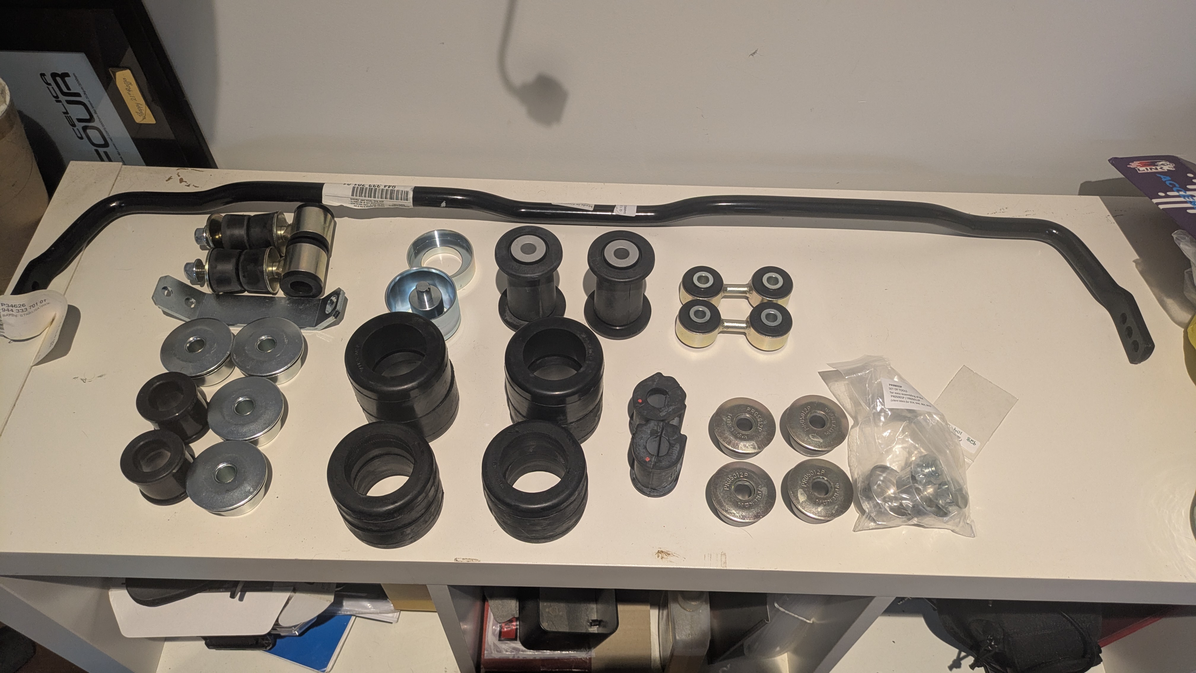

Prekom sports hardess bushes and M030 rear sway bar have arrived. I assume these are the same as what Elephant Racing sells, from what I've read Prekom was the OEM.
