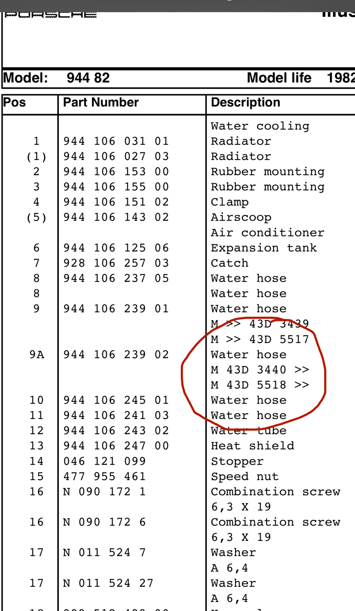

After inspecting a pretty bad coolant leak, I noticed my upper radiator hose (944 106 239 02) had been rubbing against a pulley wearing a groove/hole into the side of it. As I replace it, can I trust a Lindsey racing or hamburg technic part rather than oem? I’m also curious as to what these numbers and letters represent in the description

The numbers outlined in red are the break points in the production. In this case, the 01 hoses are used up to the 3439 and the 5517 VIN numbers; the 02 hoses are used in cars more recent than that.
Note that the D in the VIN is for 1983 models, so may not play a factor in your car.
