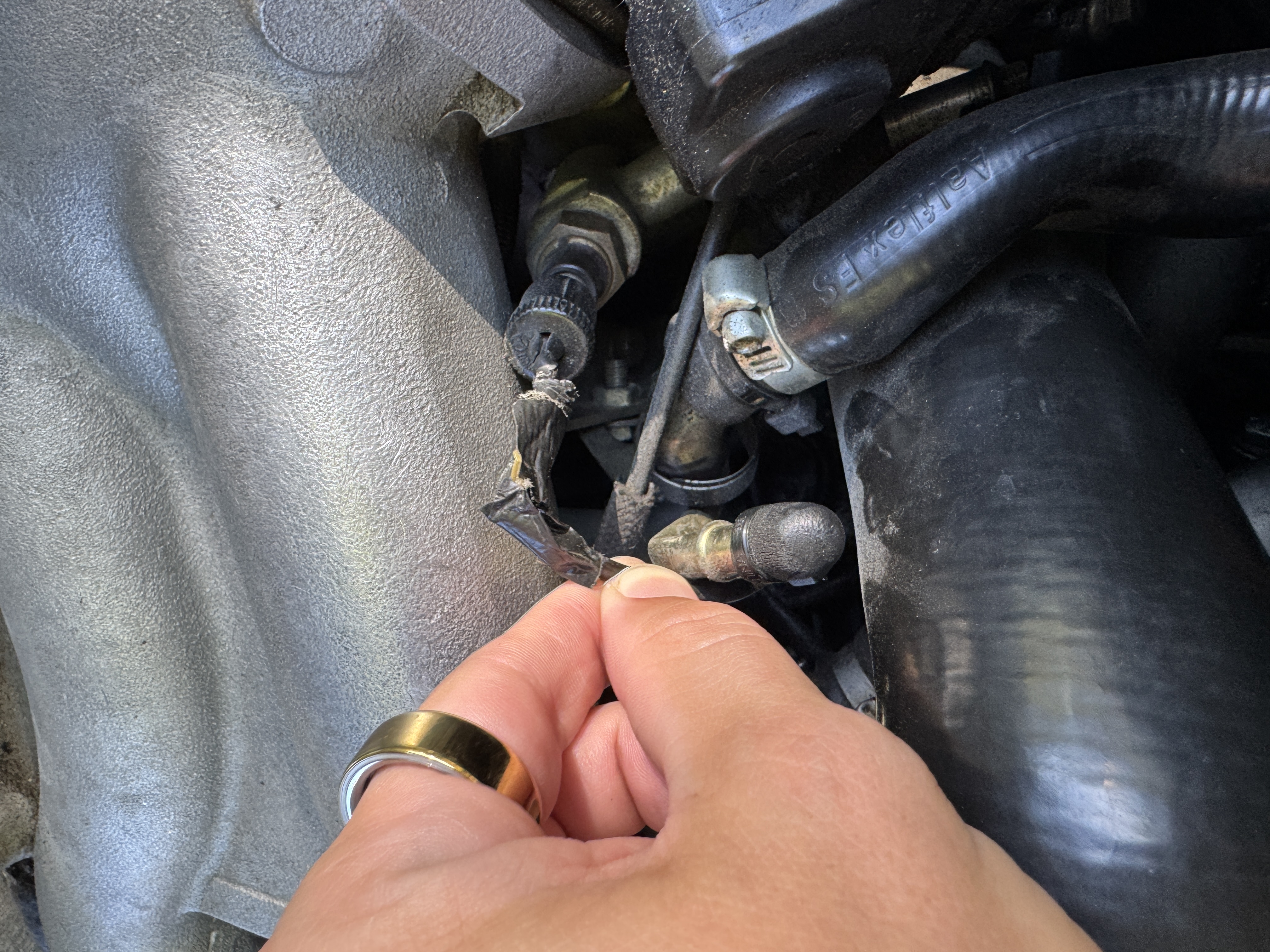

So this evening I went to start the car and it fired right up without struggle which was odd. It was about 82F out so maybe that I checked battery connections which were solid, found that there was this kink in the temp sensor seen in the photo below. This could be a culprit to cold starts? Regardless, drove 20 miles on a mountain road (quite bad road conditions which could help shake up sensor connections). The car didn’t skip a beat, deepening my confusion.
That kinked temp sensor hose is a classic vacuum leak. It would absolutely cause cold start problems. The rough road probably jostled a bad electrical connection loose, which then temporarily fixed itself. You found your culprit. Replace that hose.
That was my thought. I was reading up on hard cold starts and this was the easiest part to change out buuuuut I wasn’t expecting this haha.
What I meant on the rough road was that it should’ve had jostled some parts but it drove great with no issue.
