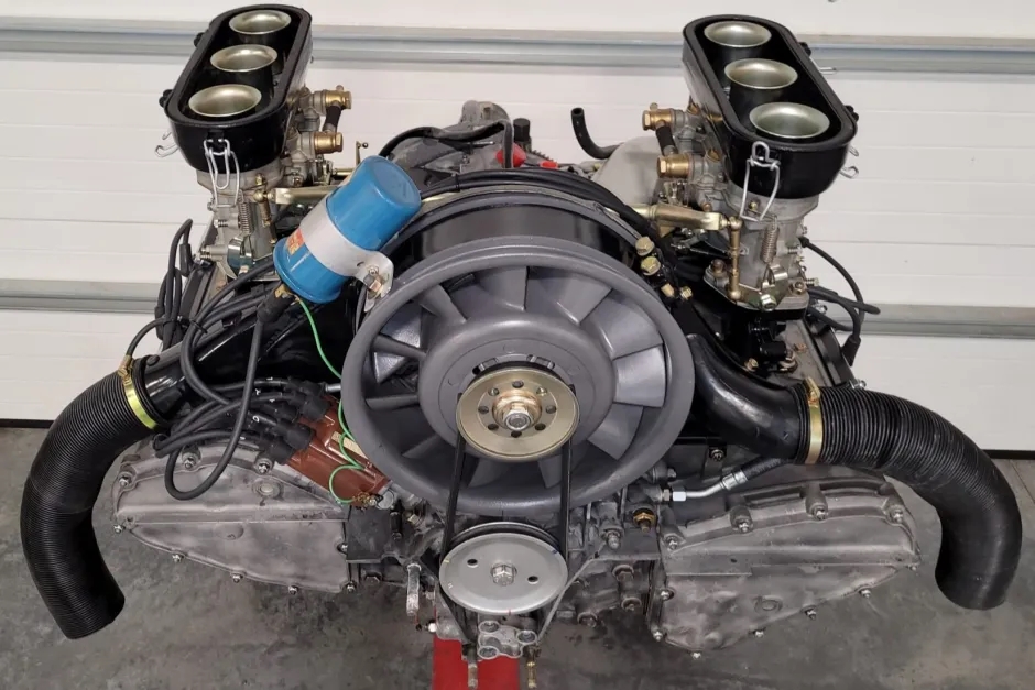

III. The Porsche 911 and 914/6: The Flat-Six's SOHC Valvetrain
3.1. The Engineering of the SOHC Valvetrain
The Porsche 914/6 and the 911 models of the 1970s featured a completely different valvetrain design from their four-cylinder counterparts. Instead of a pushrod system, they utilized a Single Overhead Camshaft (SOHC) architecture. This design places a single camshaft directly on top of each of the two cylinder heads, where it can directly actuate the valves, either with or without the use of rocker arms. This eliminates the need for the long, heavy pushrods required by the cam-in-block design. The camshafts themselves were driven by a single intermediary shaft located below the crankshaft via a chain-drive system, which also powered the oil pumps.
3.2. The 914/6 and its 911 Heritage
The 914/6 was a testament to Porsche's engineering heritage, as it was equipped with the 2.0-liter flat-six engine from the 1967–1969 911T. This engine, a detuned version of the 911's core power plant, was engineered for a more relaxed character. Its camshafts had "less lift and relaxed timing characteristics" compared to other, more aggressive 911 engines of the time, which inherently reduced the stress on the valvetrain components. The engine also featured robust iron cylinder barrels, contrasting with the iron and aluminum "Biral" barrels used in the more powerful 911S and 911L models. This deliberate design choice demonstrates that a form of "special protection" was built into the engine's engineering to prioritize durability and reliability over peak performance.
3.3. The 911's Valvetrain Evolution (1970-1979)
Throughout the 1970s, the Porsche 911's engine saw continuous development and increases in displacement, moving from the 2.0L unit to 2.7L in 1974. The valvetrain, however, maintained its core SOHC architecture with two valves per cylinder throughout this period. The system was refined with technical updates such as the introduction of Bosch K-Jetronic CIS fuel injection in 1974.
The SOHC design itself is a form of inherent protection for these engines. An SOHC system, with its camshafts placed in the cylinder heads, has fewer and lighter moving parts compared to the pushrod system of the VW Type 4 engine. This reduction in reciprocating mass—the mass of components that change direction rapidly—is highly advantageous, especially at the high RPMs these engines were capable of. By eliminating the long pushrods and relying on a more direct actuation, the SOHC design reduces valvetrain stress and mitigates the risk of "valve float" (a condition where valves fail to follow the cam profile at high speeds). Consequently, the Porsche flat-six's SOHC valvetrain can be viewed as a more refined and robust system for performance applications than the VW's pushrod design, directly answering the implied question about superior components.
