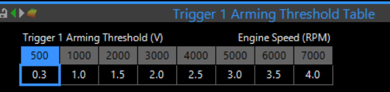

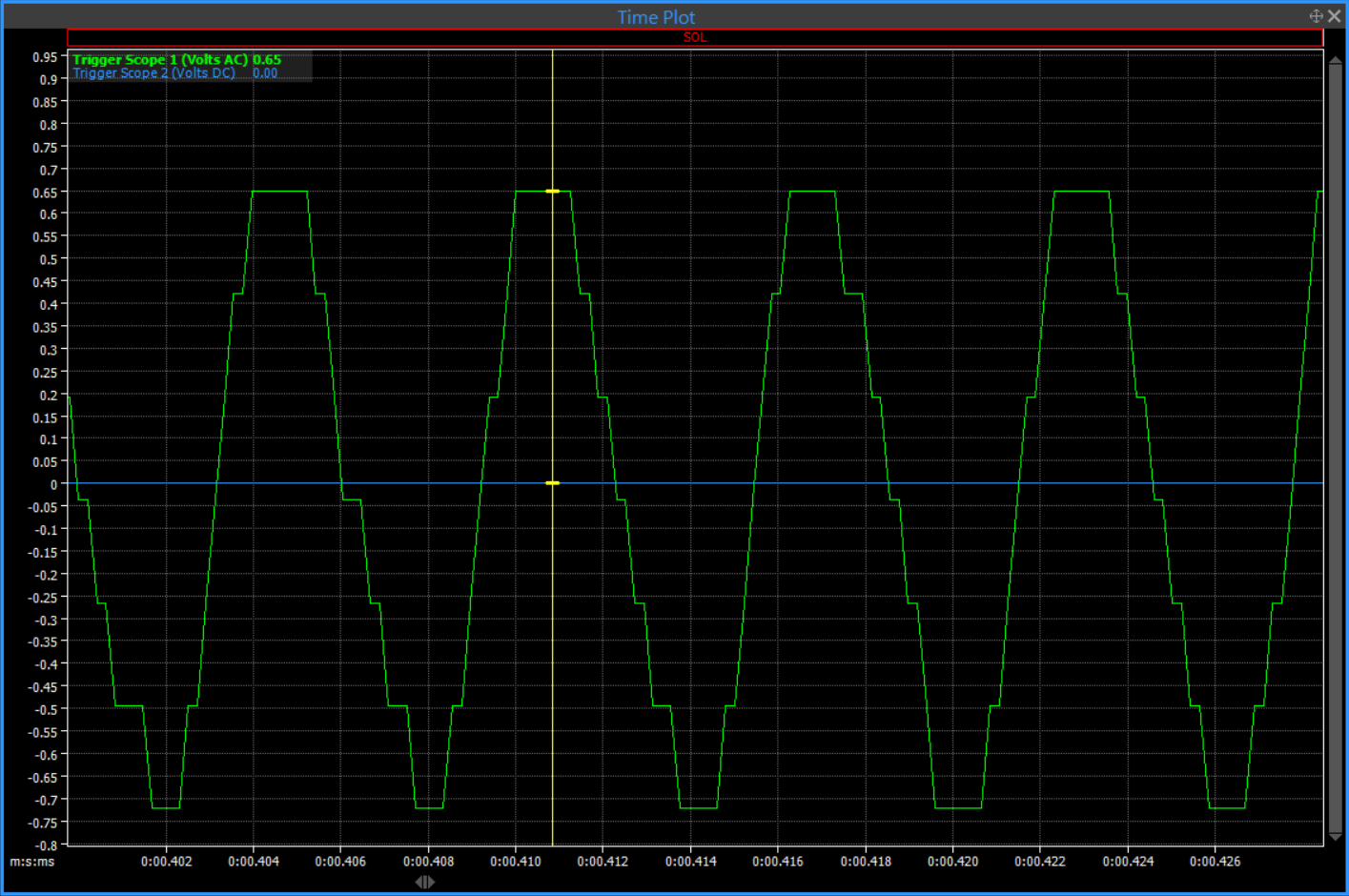

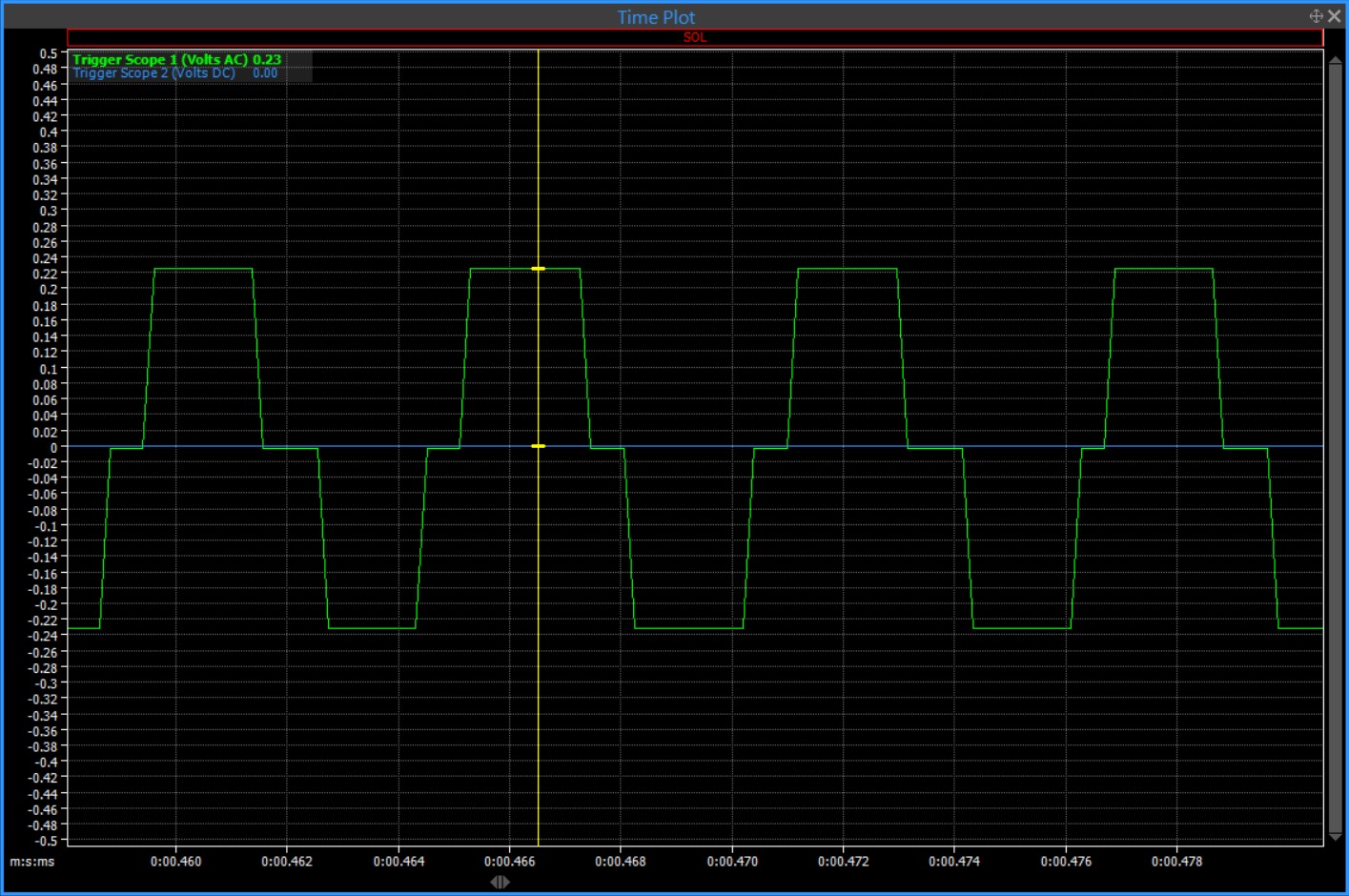

Here is an example from my ECU when I went through this process:
Crank sensor gap was 0.89mm. Peak amplitude was ~0.2V. This was so low that with an arming voltage at 0.1V (50% of 0.2), the ECU had a hard time properly calculating engine speed, and as such would not start. Crank sensor gap was 0.5mm. Peak amplitude was ~0.65V. With an arming voltage of 0.3V, the ECU can properly calculate engine speed no problem. My current arming voltage calibration table for reference. I get no trigger errors with these settings, but I would not necessarily copy paste to your ECU's calibration table. For reference only: As FYI, in the above screen shots the trigger scope logging function actually has a pretty low logging rate, so this is why the waveform doesn't look as pretty as a traditional A/C waveform. At higher engine speeds the trigger scope does look more like you'd expect, but since we're talking cranking, the point comes across I think..
