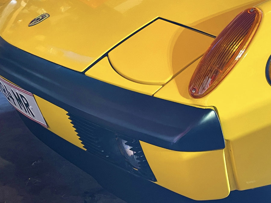

My Jezibel (a '74 914-4) came to me with fiberglass front and rear, after-market (916 type) bumper replacements. Over a period of time, I became uncomfortably aware of the fact that the F-glass replacements didn't seem to be fully satisfactory in terms of their fitment. That is, the fit wasn't perfectly congruent along the left and right sides with the indentation space on the metal body shell.
As a 'compleat perfectionist' (sic), this gradually began to irritate me and finally pushed me to attempt to make the fit smoother. I had an opportunity to do so when I reinstalled the driving lights and fitted dual Hella 'Hi-Tone' horns, and removed the front (F-glass) bumper. That was a real challenge, in that the four-bolt hardware used (with the rubber dogbones) to fit the front bumper assembly had some corrosion and posed a bit of difficulty removing them (as you all likely know, this requires loosening the driving light mounting bolts so as to be able to give yourself enough 'wrench-room' to hold the anterior bolt head or nut in place), whilst removing the bolt from the front fender-well with a racheting wrench (that in itself is a pain, when there's corrosion on the bolts). At any rate, after a battle royale to remove those four rusted bolts, I installed the new horns, readjusted the driving lights and replaced the F-glass bumper.
It's hard to imagine my frustration when I noticed that the fit of that F-glass bumper was STILL not perfectly aligned, but not eager to repeat that whole exhaustive procedure, I left the situation as it was (slightly less than satisfactory) until a future, as-yet-undetermined opportunity presented itself.

After a final tweak of the ratchet (on new SS bolt hardware), work completed, the bumper fitment was better but still not completely perfect that way a stock metal front bumper would be on a virginal, un-messed-with 914 (which would have no side-gaps, no matter how slight). The top alignment of the bumper with the car's hood was perfect but the left and right side-gaps were still not to my liking, alas alack!
Thereupon a brief period of contemplation ensued, from which I concluded that Realised Fact #1) there is no such thing as any "perfect" after-market replacement part for our beloved 914 cars. No matter what all the recognised and reputable 914 parts suppliers say about their 'custom' parts, a significant amount of 'reworking/fitting' will be required to make everything fit your car perfectly.
I know what you're thinking (to use Thomas Selleck's favorite MAGNUM P.I. sotto voce aside): That this should be instantly obvious to all but the least mentally astute individuals. Well, I clearly belong to that last category of the population, since in my sophomoric enthusiasms, I have always assumed that after-market parts suppliers are as fully and reliably honest as George Washington was after hacking down his cherry tree (as apocryphal as that historic event obviously is), when they say 'a perfect replacement fit'.
Friends, I now share with you the observation that there is no 'after-market' part made by ANYONE that is a perfect fit without some adjustment/modification required. Get used to it!
Since so many P-car parts suppliers provide a similar "916-type" fiberglass bumper replacement part for the 914, it makes me wonder if they ALL have such ‘some adjustment required’ characteristics...or if it possible that SOMEONE makes a fiberglass part that IS indeed a perfect fit (with no work required except to bolt it on).
At any rate, I twiddled, tweaked and 'modified' a few edges and such and I am finally ALMOST satisfied with the result, but Apparent Fact #2): Don't ever count on a completely perfect fit, fresh from the box!
