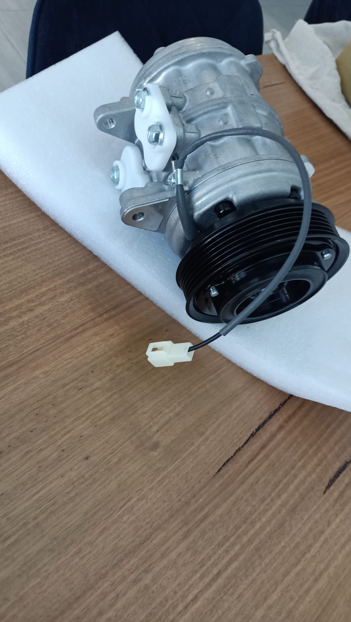

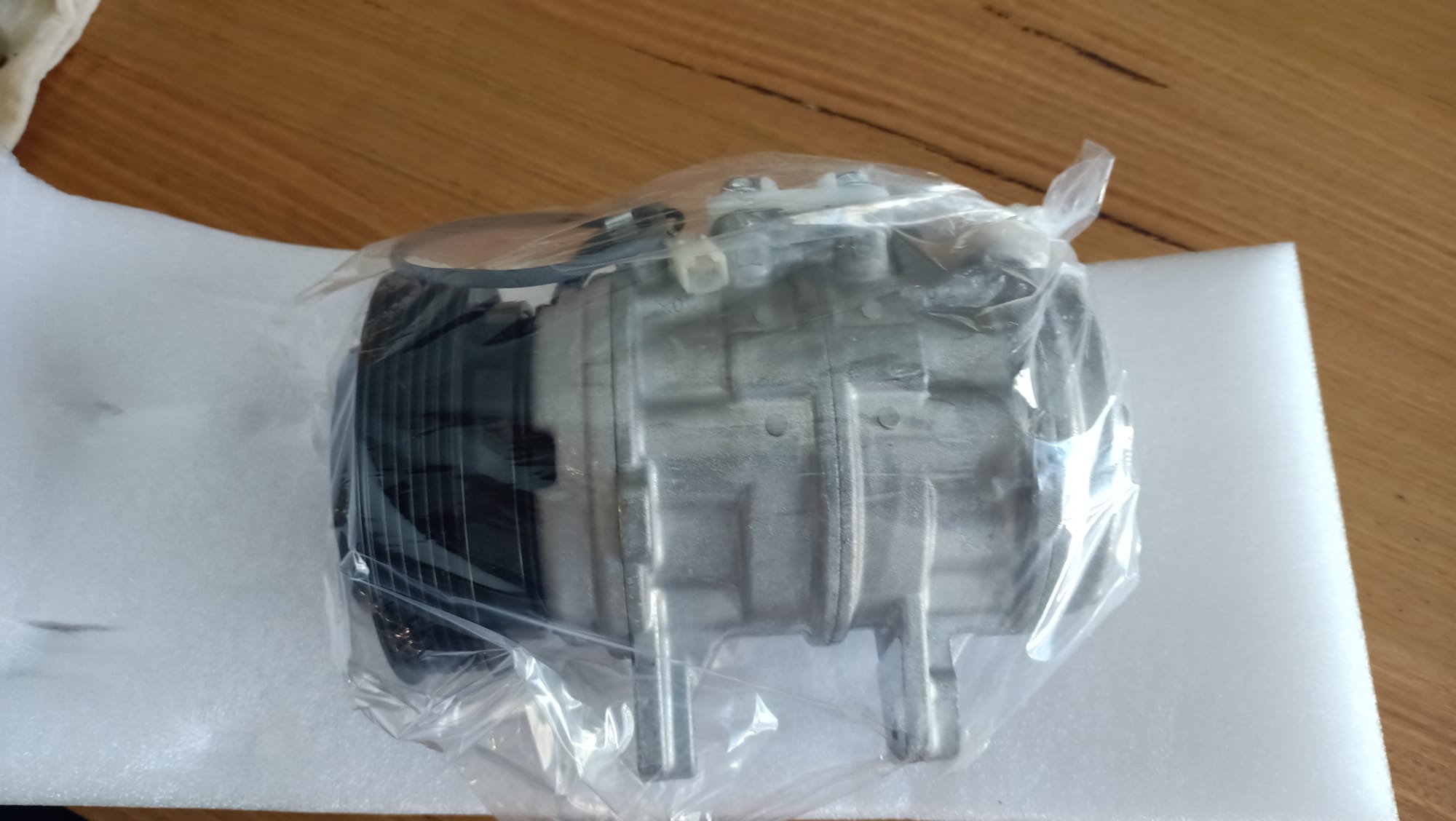

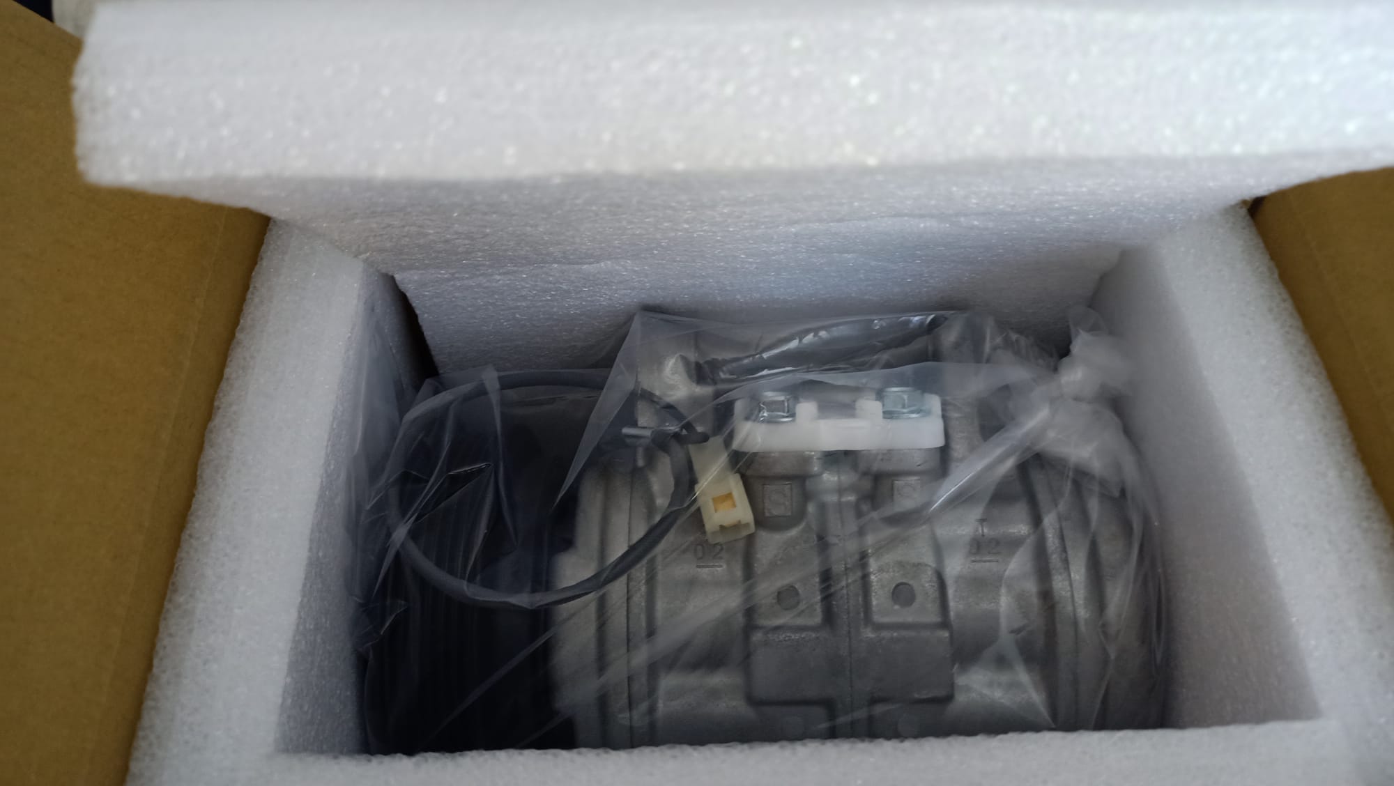

Quick update. A new A/C compressor was going to cost me $1800 AUD. Found a new one on Aliexpress for $300 AUD delivered to Australia (approx $185 USD). Ordered on 8/Jan and arrived 15/Jan. Had it fitted today and appears to be working perfectly.
Thanks again Tom and dr bob. https://www.aliexpress.com/item/1005006728935559.html

Ali Express you say. Looks good. Who knew! Glad you got it sorted and cooling your car again!

Great find on that compressor! Report back after some time with it and help me decide if I need a spare for the shelf.
