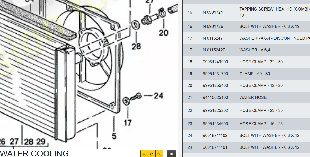

I'm looking for parts 24 and 17 in this diagram for my 1983 944. They're nothing special so I'm hoping someone can tell me the specifics and I can just pick them up at Home Depot instead of ordering them from Porsche. I think the shroud has 3 along the top and 3 along the bottom, all of mine are missing.

Only #24 is needed, most of the info about the fastener is in the description. It is an M6.3 (diameter) and is 12mm long with a captured washer. It is a special fastener, and it is unlikely that HD will have anything similar to this (or any other parts of a Porsche).
Belmetric has them in 16mm length (same as the fasteners used to secure the fenders) but they must be shortened before installation or damage to the radiator is possible.

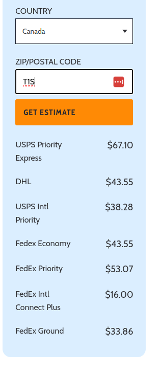

Not to Canada.
