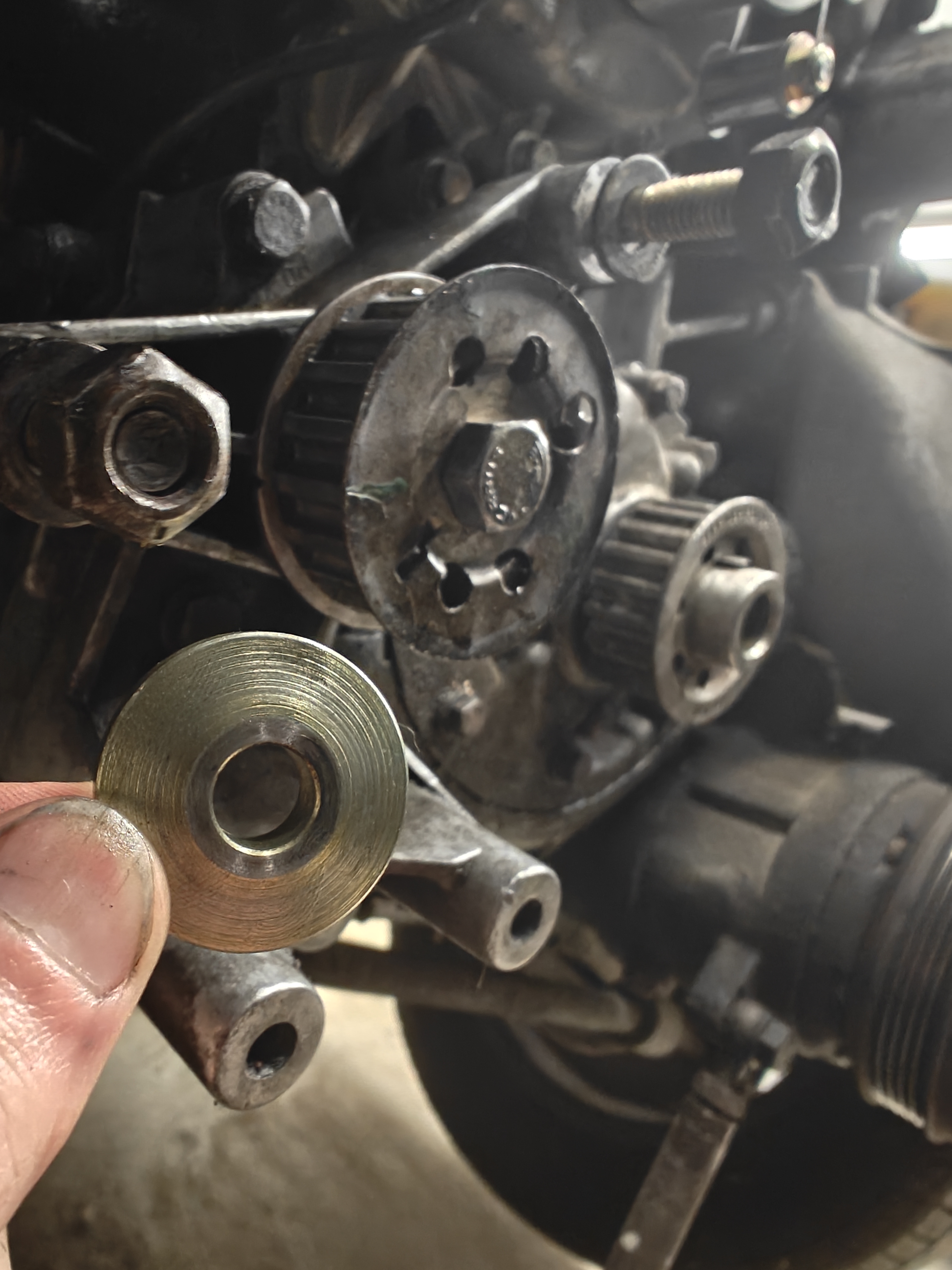

Maybe post a picture of your assembly so we can see what you are up to. Pictures worth a thousand words and all. What bolt are you tightening that makes the shaft tighten up??
I highly doubt you bent the balance shaft, but if you remove the front carrier and spin the shaft, you should be able to see any run-out (bend). You might check the bearing in the nose piece too, just to make sure you didn't knock it out of position (which seems unlikely).

This is the balance shaft pulley and the gold washer I mentioned. You can see the pulley here without the washer and I can spin this fine. Add the washer and it locks up.

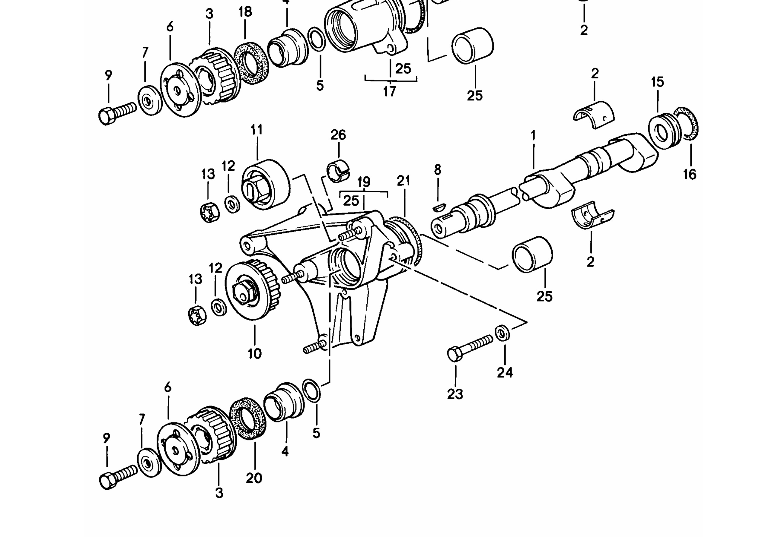

Here is a diagram of the lower balance shaft assembly. I would take yours apart and make sure every piece is in place as shown. Maybe document it with pics here in case we see something you don't. I would also loosen the front carrier to finger tight, then torque the pully bolt and see if it still binds. If not, the carrier just needs to be installed carefully, as I mentioned above, to avoid the binding.

Tom wrote: Sun Nov 10, 2024 9:10 am Here is a diagram of the lower balance shaft assembly. I would take yours apart and make sure every piece is in place as shown. Maybe document it with pics here in case we see something you don't. I would also loosen the front carrier to finger tight, then torque the pully bolt and see if it still binds. If not, the carrier just needs to be installed carefully, as I mentioned above, to avoid the binding.
Thanks, I'll remove the carrier and see if that's it, it's possible the previous owner didn't properly assemble it. I don't have a torque wrench to properly put it back on but it's not working at the moment anyway. I'll borrow one before I reassemble everything eventually.
Where is the carrier? Is that the 4 bolts at the front of the long plate on top of the shaft? I see 4 bolts right behind the assembly, I think they're 10mm or 12mm. I'll try that today, I'm just about out of options at this point. If I can't figure this out, I'm taking it to a mechanic to figure out and that'll probably cost close to the entire value of the car. I'm willing to try anything you can suggest.

By carrier, I meant the part shown as 19/25 in the diagram above. If you don't have power steering yours will look different, but it's the part the oil seal sits in. Take lots of pics when you take it apart. If you haven't taken it apart to see what's back there, that's a must!!
