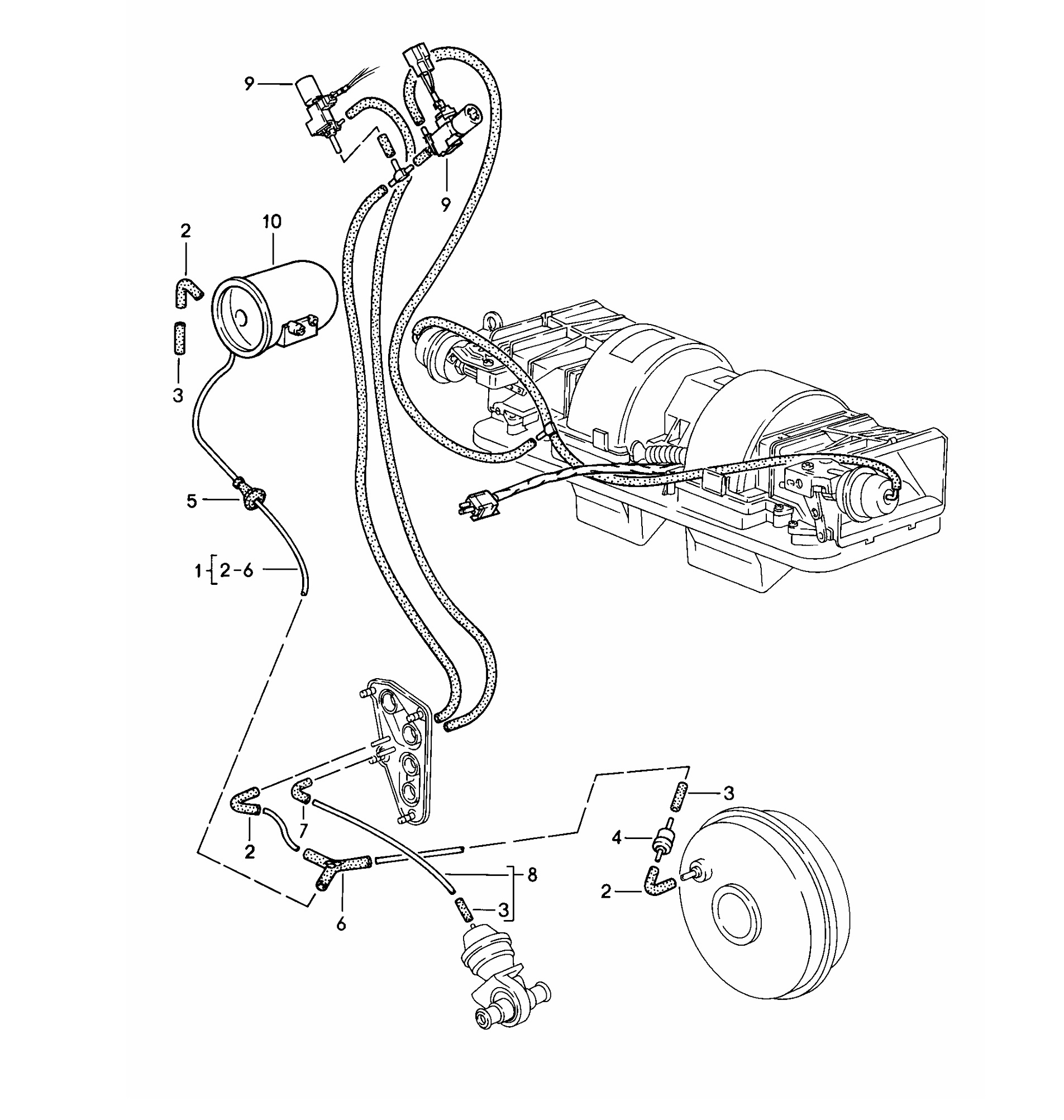

You're welcome. :) The solenoid is on the side of the heater core console under the dash, as shown in the factory diagram below. Keep in mind, however, that the sole job of the solenoid is to actuate the plunger in the heater valve under the hood. So the first things I'd do is set the cabin to max heat with the car warmed up, and then go look to see if the plunger is in (cold) or out (hot). Assuming the plunger is sucked into the heater valve (in/cold), I'd remove the vacuum hose and see if the plunger pushes out to allow hot coolant into the cabin, and confirm the vent temps are then hot. If so, then you just need to figure out why the solenoid isn't shutting off vacuum to the valve -- due to a bad solenoid, control unit, vacuum plumbing, temp sensors, etc. That's where the tests in my chart will come in handy. If the heater valve is in the open position (plunger out) when the cabin is set for max heat, then you have to figure out why the vent temps are not hot even though hot coolant should be flowing to the heater core -- due to a bad servo or linkage, air in system, etc. Another possibility is that you remove the vacuum line from the heater valve, and the plunger remains in and the valve remains closed. That would mean the heater valve is stuck closed.

It tool me 23 minutes, and many brain cells I'll never get back, to sketch that out and see your logic. Well done. The vacuum hoses are tightly routed and organized on the side of the heater console, so highly unlikely they are mixed up there (see picture above), but certainly possible the hoses are switched at the firewall (see picture below). If so, and if my remaining brain cells are still functioning, I think that would mean the recirculation solenoid would only work right when the heater is on (which may go unnoticed).
The more I think about the oddball symptom @Fejjj951 describes -- making no heat under vacuum but full heat under boost -- that's what you would expect if the heater valve were connected directly to manifold pressure. The solenoids are not designed to deal with boost, since they should never see boost, so hard to know if it would allow boost to pass through when de-energized. (I might test one later.) If everything else checks out, I'd be inclined to pull the vacuum line off the firewall (see picture below) and hook it up to a vacuum/boost gauge to see if it just follows manifold pressure due to some fault with check valves, vacuum reservoir, etc.
All that said, I'd still start with the very basics as outlined above -- i.e., see if the heater valve opens and closes as designed under vacuum/atmosphere; see if you get heat when the valve is manually opened; then run the diagnostics in the chart if the heater valve is working right. If all that checks out, then start jumping into these rabbit holes. :)
