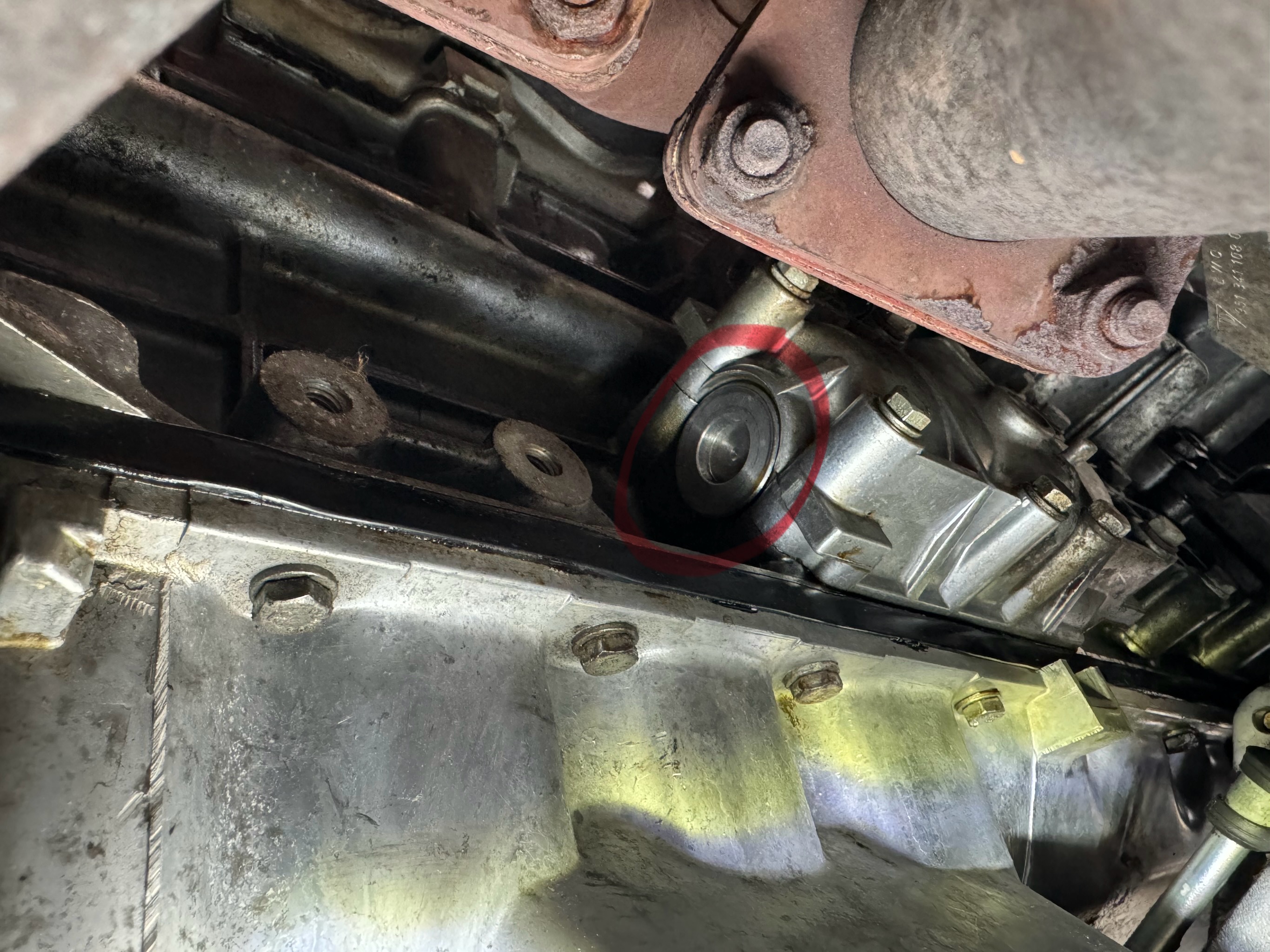

Hi,
I have an 86 944 n/an and am trying to find an oil leak or two. I think the dipstick tube is leaking and also the part in the picture. What is the part in the picture?
That pic is from behind the passenger wheel.
Thanks
Posts: 9094
Been thanked: 4080 times
That's the lower balance shaft rear seal. It's a big o-ring that goes around that disk you circled. Pelican and Clark's have write-ups on changing it. Not a lot of expensive parts, but plenty of labor time....
