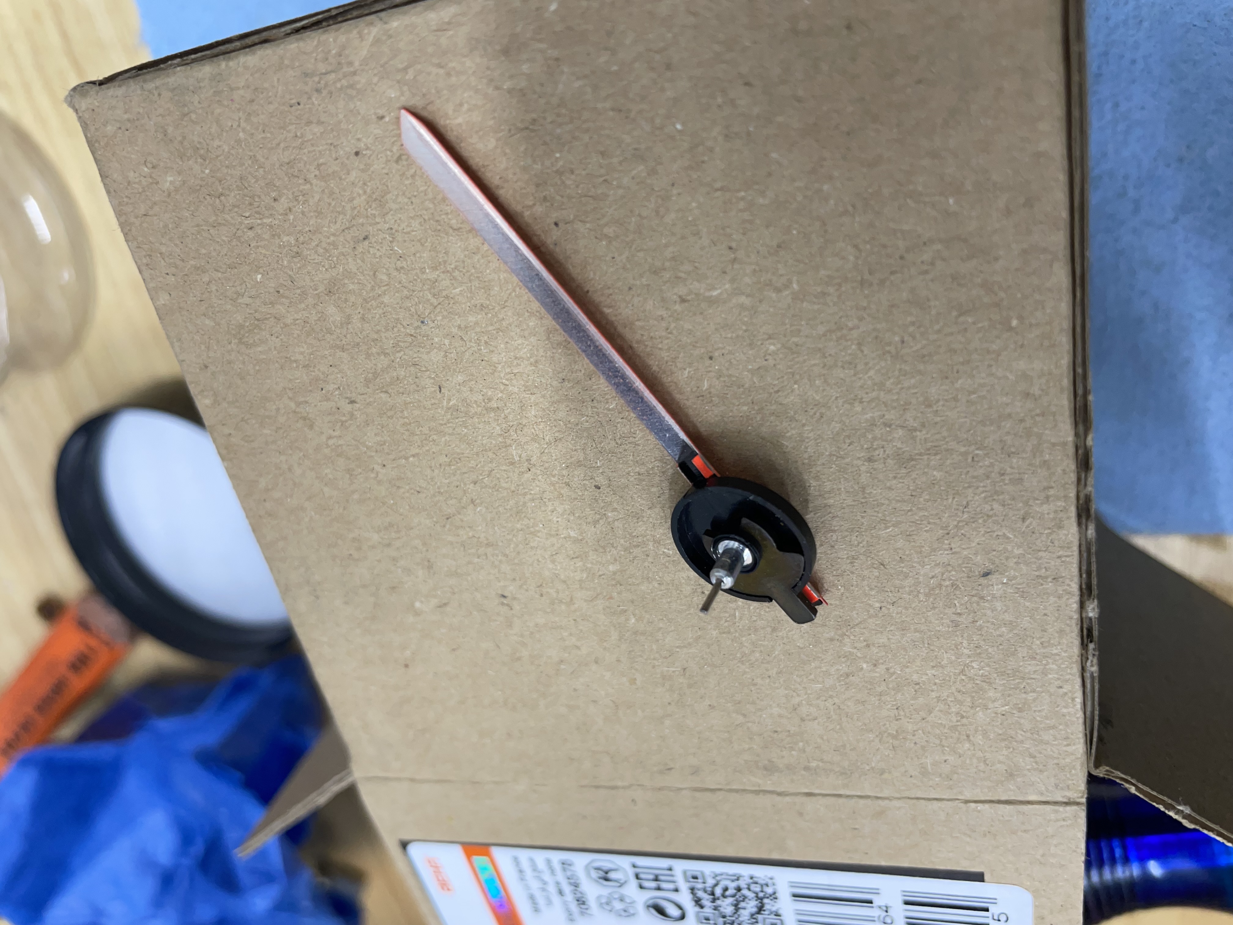

I took apart my speedometer to replace a failed gear and have put it back together except installing the needle. My speedo look a little different than the picture in the gear replacement instructions as I don’t have a little metal piece sticking up (see hand drawn arrows in pictures). Also here is a picture of my needle. I align the needle pin with the hole but it doesn’t stay in. Any ideas on what is going on.

I hate to be the bearer of bad news, but I suspect you broke the little axle shaft on the speedometer. When you remove the orange needle, it needs to pop off the metal piece shown in your first picture. Instead, it looks like the shaft broke on yours. That's why the guide looks different. Kind of a long shot, but try pushing the shaft back in and see if it seats securely. If not (as I'd expect), the path of least resistance is probably a new-used speedometer. Look at the end of the little shaft -- does it look snapped off? Can you see the other side of the broken shaft in the little port in the center of the speedometer?

I tried pushing the needle in and it does not stay in. I was thinking of trying to bond it on and see if that would work. I will start looking for a replacement.

zooklm1 wrote: Mon Mar 18, 2024 6:20 pm I tried pushing the needle in and it does not stay in. I was thinking of trying to bond it on and see if that would work. I will start looking for a replacement.
Thanks
Can't hurt to try, but I wouldn't get your hopes up too high. :( If you find a replacement, I've learned that you can set the new odometer to match the old one by loosening up the mechanism. (And ever since, I've taken odometer readings with a grain of salt on these cars.)

I would try a very little dab of JBWeld (or similar) on the tip of the broken shaft and secure it in the correct position until cured.

I will try the jb weld and reach out to Plyhammers.
