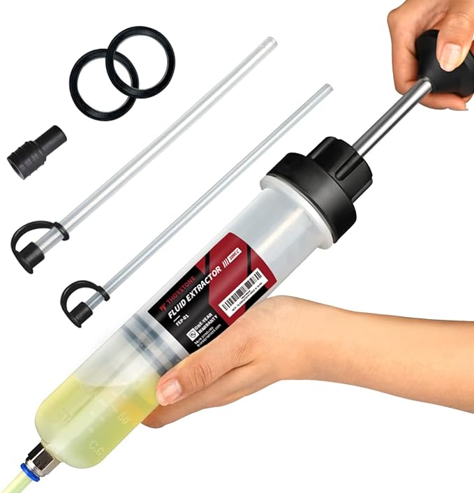

When you remove this bib from the oil filter console, what will prevent oil from dripping down into the wormhole down there?
Boston-area, MA
Posts: 8988
Has thanked: 947 times
Been thanked: 4040 times
Great question. I originally thought it would drain into the console, but no such luck. The oil just pools in the bib and goes nowhere. Seeing that confirmed why poking holes in the filter doesn't work to drain it like on some other cars. So at first I just sucked it out using a turkey baster, but that made the stuffing taste funny, so picked up an automotive fluid sucker similar to the one below. It sucks out 95% and then I use a paper towel to sop up anything that might otherwise dribble out.

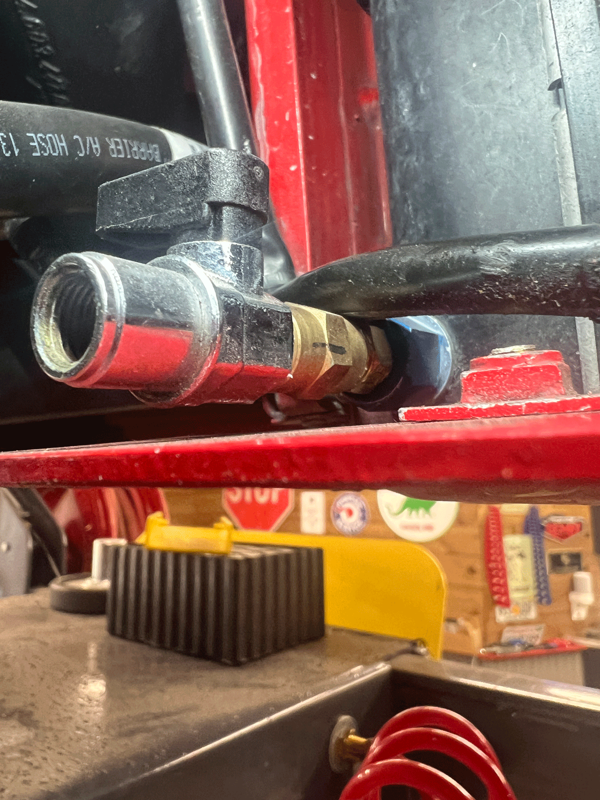

whalenlg wrote: Sat Jan 20, 2024 12:10 pm This Lindsey radiator drain hose has worked like a charm for me.
https://www.lindseyracing.com/LR/Parts/944RADDRAIN.html

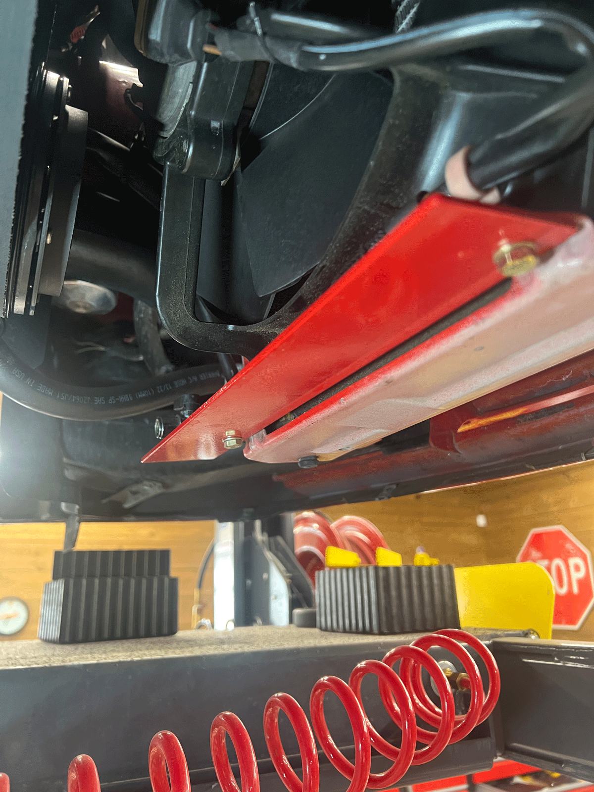

I did something similar, but wasn't thrilled about having the hose just sitting there. I ended up making my own two-part drain. The fitting and valve mount permanently to the radiator, and the hose screws on when I need to drain it. I added a little skid plate under it out of an abundance of caution. :)
