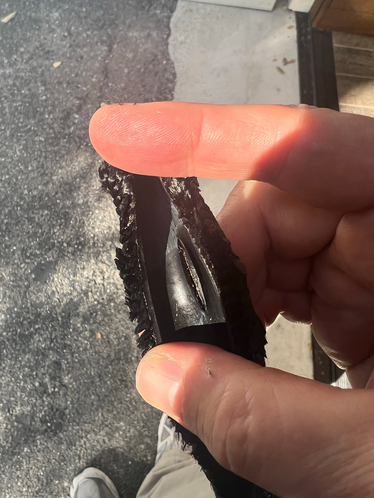

The pump and hoses are full of fuel, so you will always see some fuel drip out when you undo the banjo bolt. You could plug or clamp that line, but the amount of fuel 'should' be small enough to catch with a drip pan or rags, and some is going to drip out the pump no matter what you do. (Disconnect the battery first, have fire extinguisher nearby, and no source of sparks, etc.) The short hose on the fuel tank side is open to the tank, so if you don't block that one, it will keep draining gas until the tank is empty. That's why most instructions say to block that one, or better yet start with an empty tank. Personally, on older cars like this, I don't like to clamp old rubber hoses. That might work fine on new pliable rubber hoses, but on older, harder rubber lines, clamping the lines puts them at risk of cracking. Even if you can't see the damage, they can start cracking on the inside and eventually fail. I'd run the tank down to a gallon or two, then drain it into a bucket to do your work, and I'd still probably replace the tank-to-pump hose it's original.
See the leak on my '86 944 below, and note how the crack/leak started on the inside of the hose....
