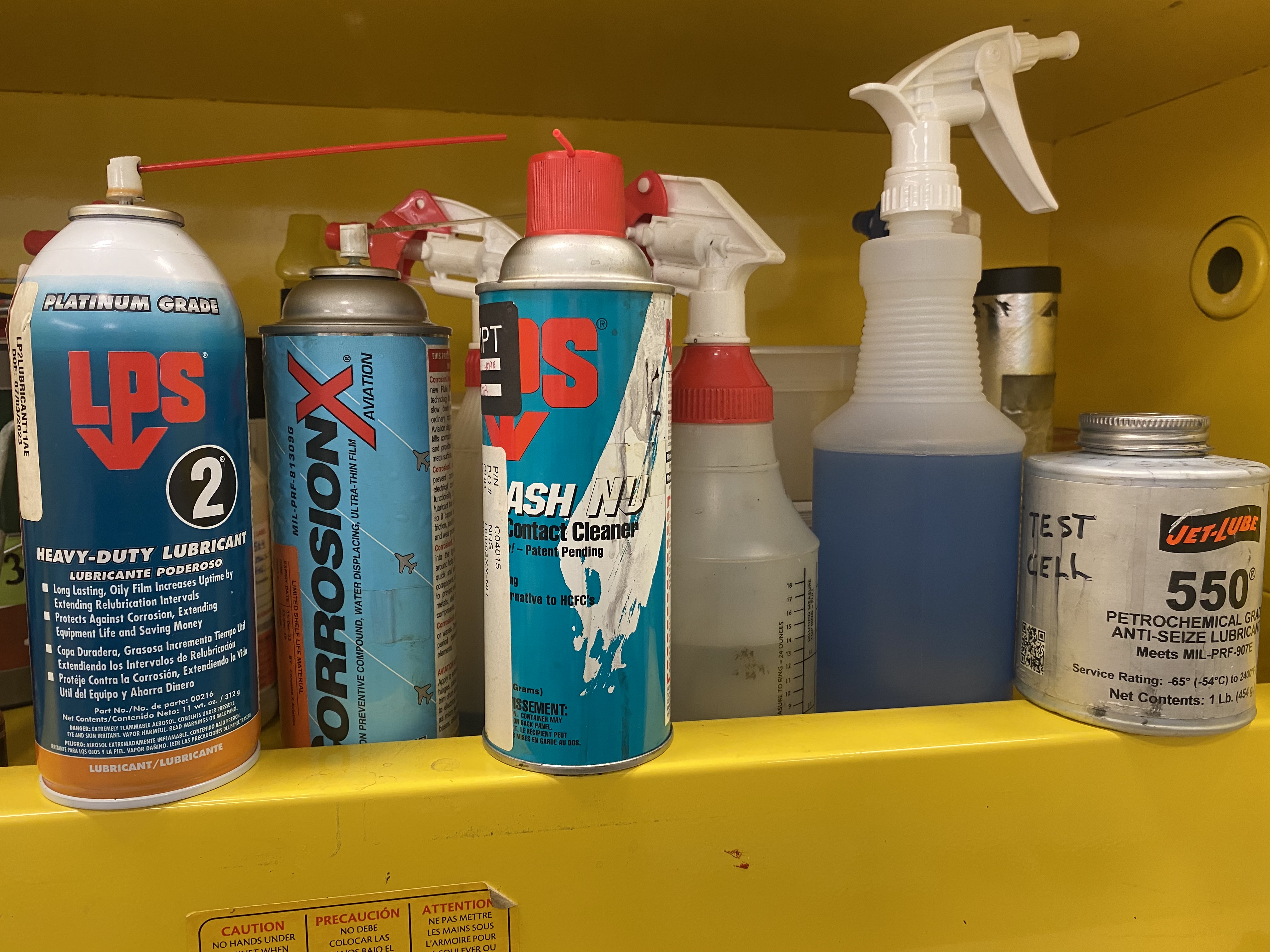

If you can find a can of this No Flash contact cleaner it’s the best thing I have ever used to clean out a throttlebody.
Blasted the bearings spotless and that was looking through a magnification scope at my work.

So correct me if I’m wrong here, I will need 1 large O-ring, 2 small O-rings, no flash contact cleaner, and 2 small circlips?
