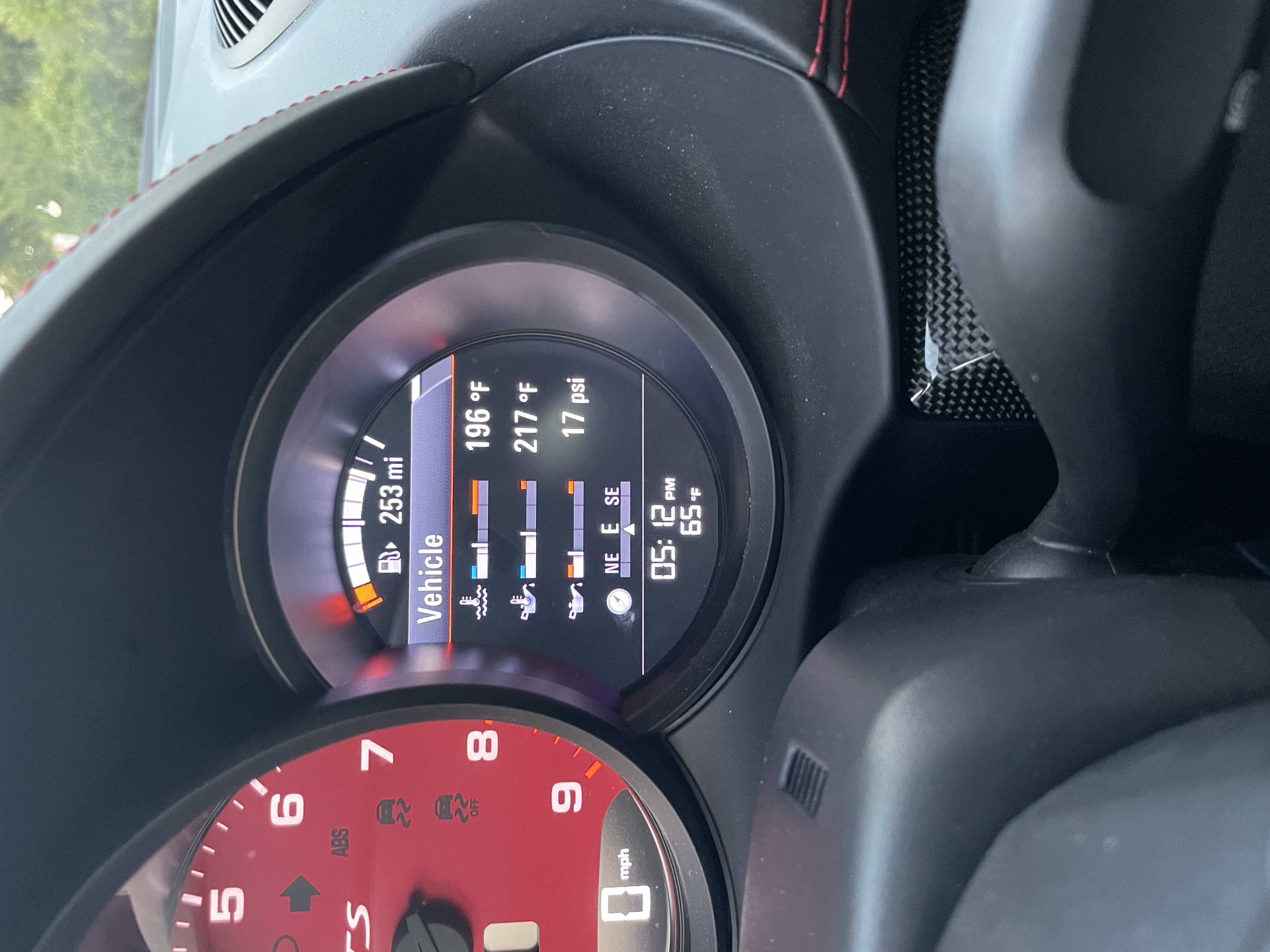

I don't understand the reasoning from Porsche. If you see the temperature go up from 194 to 239. It might be already too late Here is a screenshot of my Coolant gauge now

If @blueline and @Tom are interested in Full Matrix coding. Let me know.
