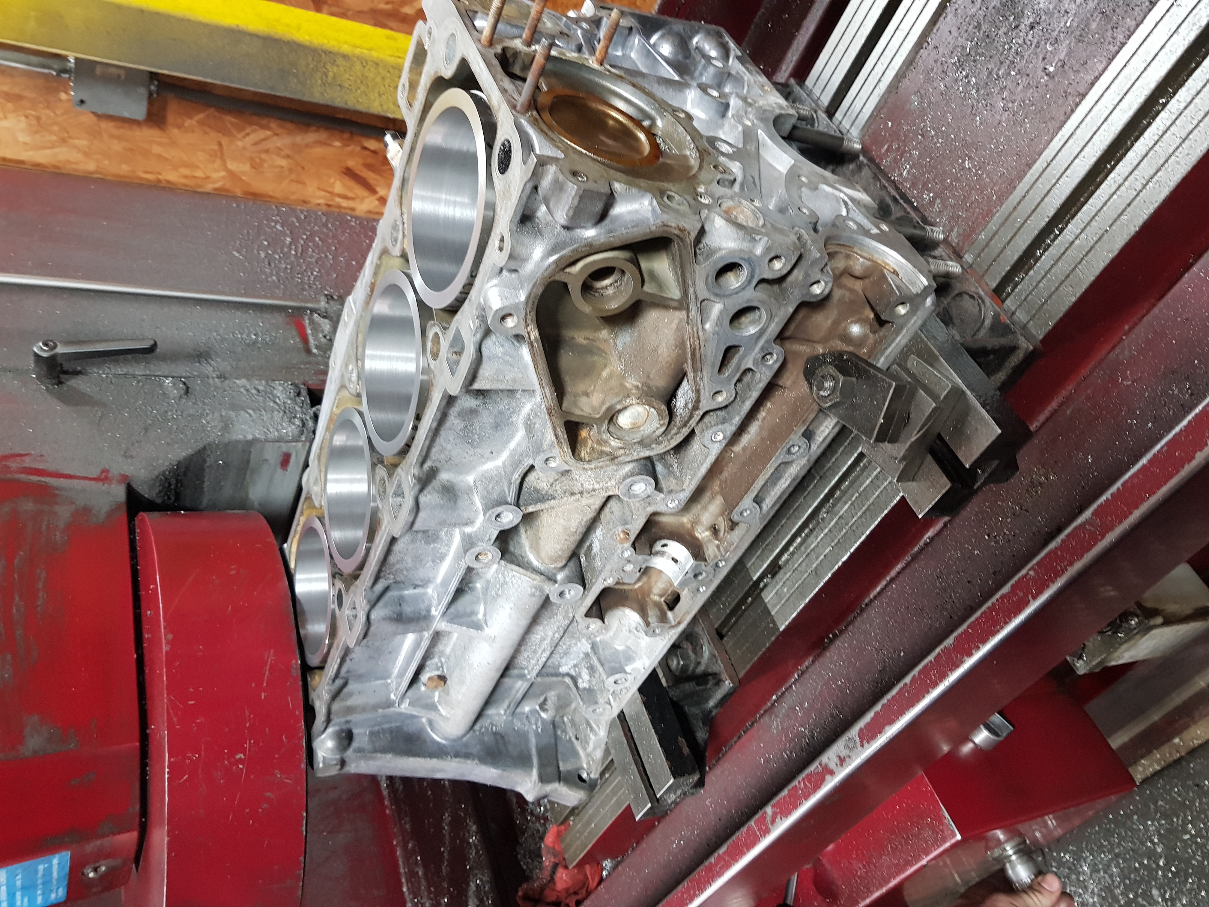

Decking the block after the flanged sleeves are installed.
