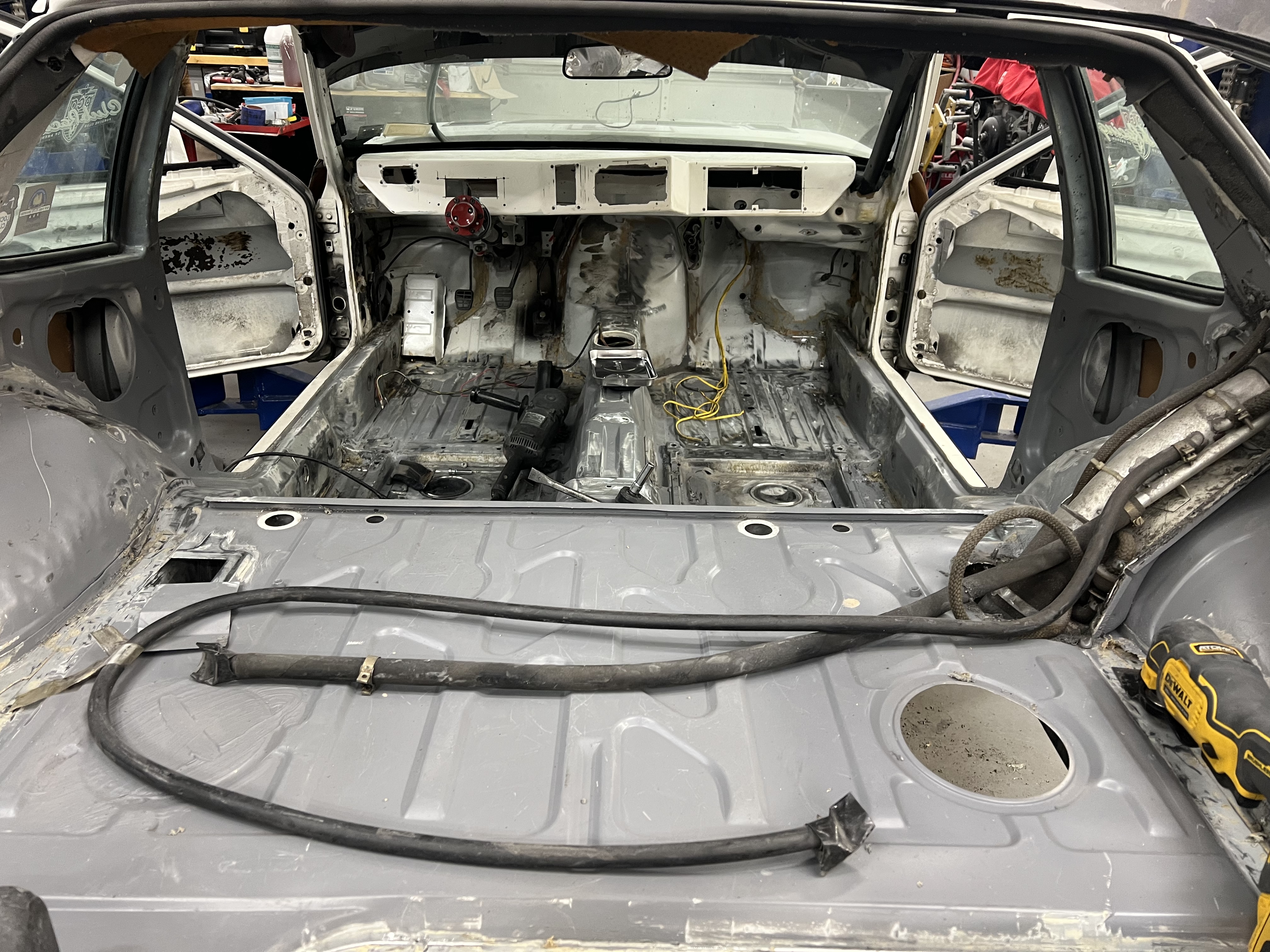

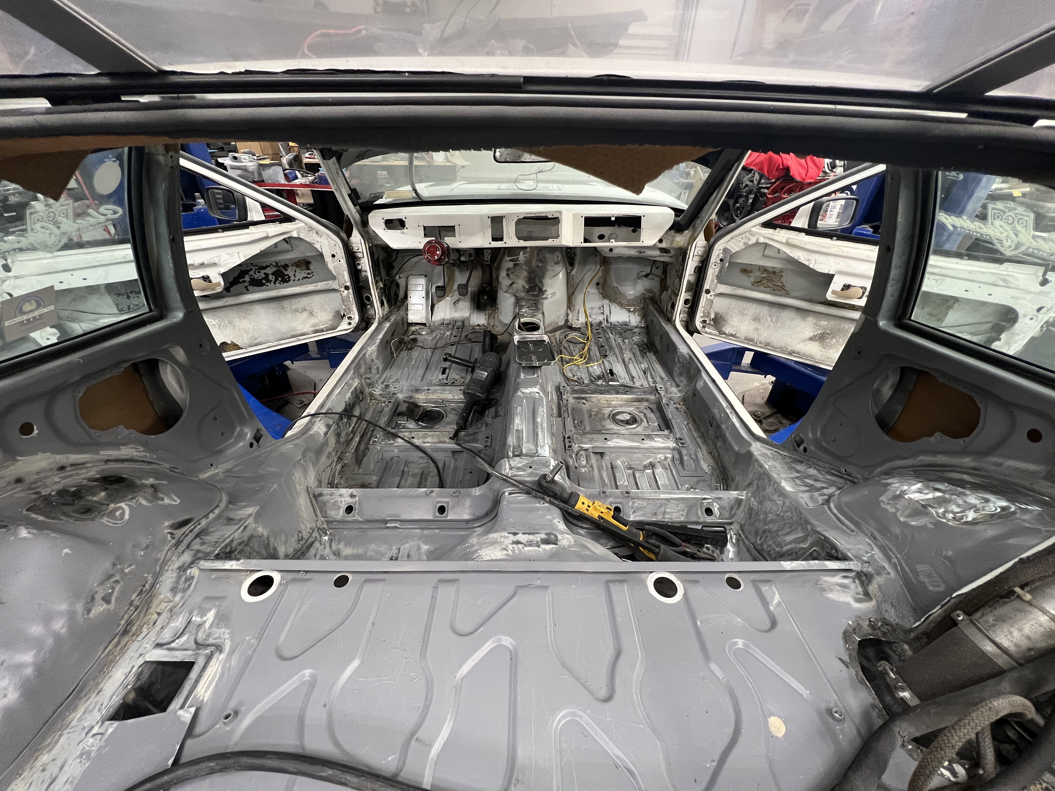

I’m always amazed how flexible the stuff is 35 years later!
BTW- the vibratory tool with a wood blade work pretty well in the tight areas.

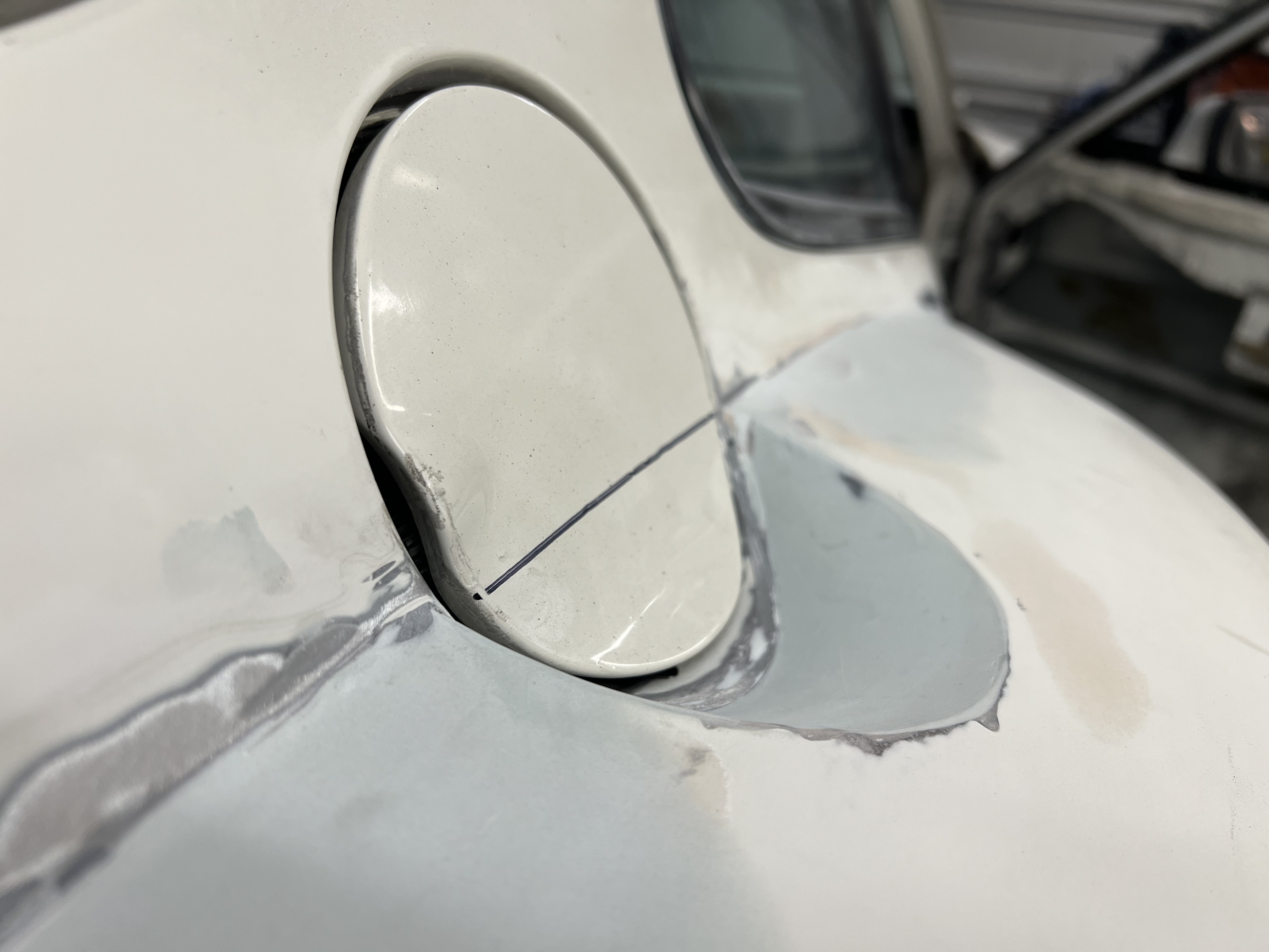

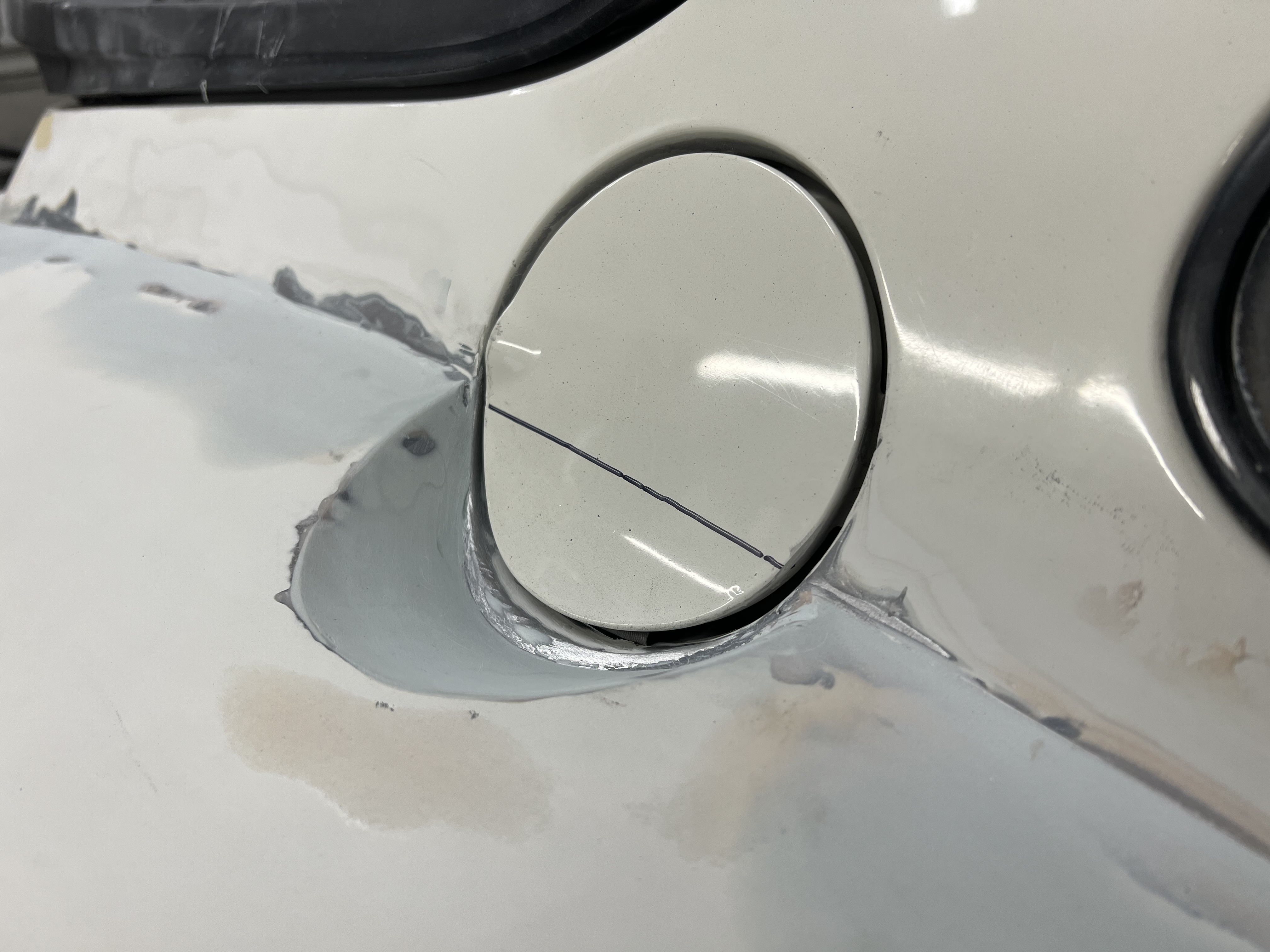

Some fun details that had to be fabricated!
