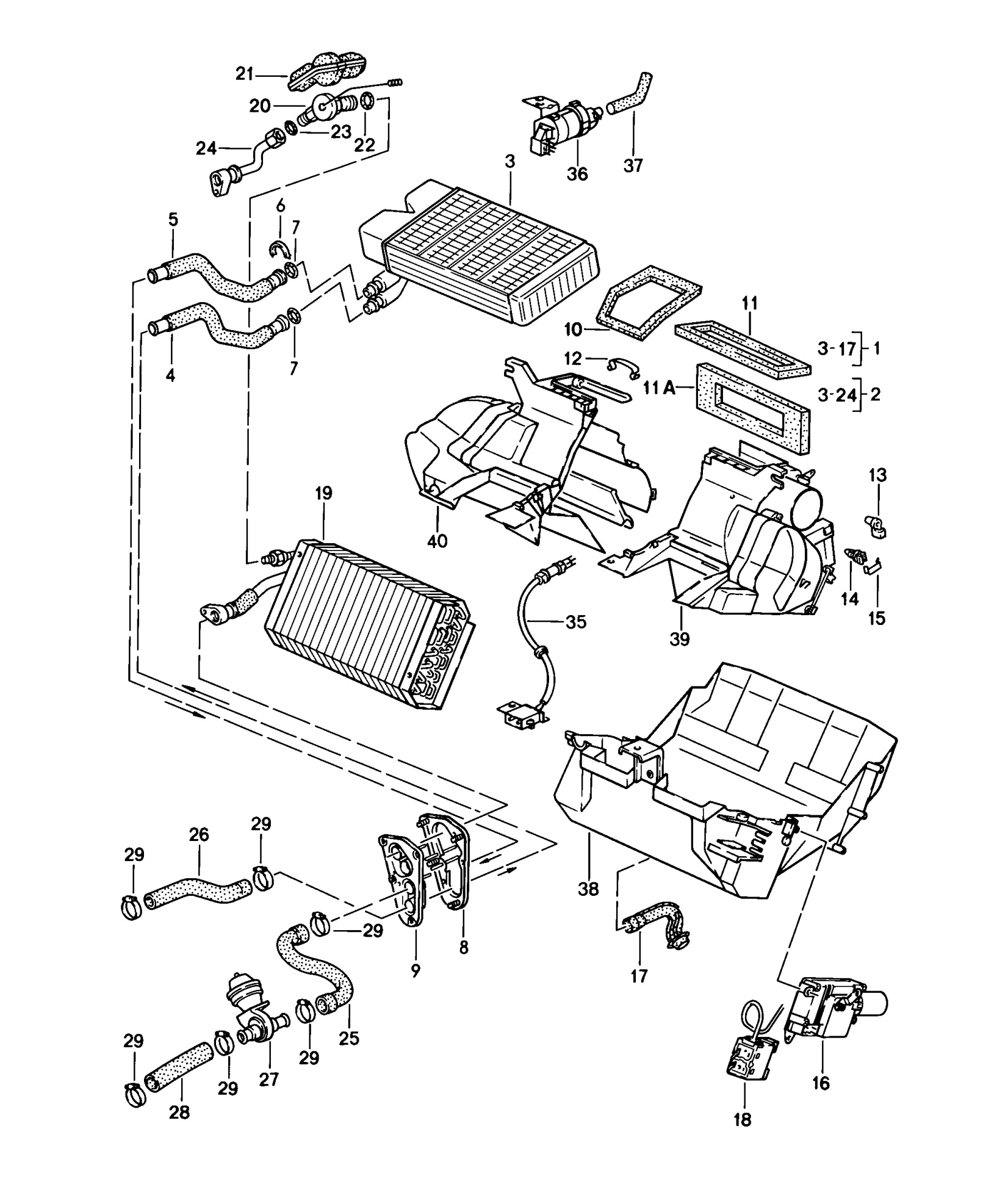

So my question, and the main reason I joined this forum, is whether the evaporator can be replaced without taking out the dash and HVAC box or not. If the only way to accomplish this is to remove the dash, is there a way to successfully flush the evaporator with it still in the car? The hot and humid Georgia summer weather is already knocking on the door here so I am really in a quandary now with this project.

On the oval dash cars, I believe the dash needs to come out to replace the evaporator, unfortunately. We have a comprehensive guide for that here:
viewtopic.php?f=19&t=341
It's not as bad as you might imagine. However, I wouldn't do that unless/until you are absolutely sure the evaporator is plugged and after you've tried everything to clear it out. I used A/C Pro Power Clean and Flush (big aerosol cans) when I updated my A/C, as recommended by Griffiths.
See the diagram below. If you get the hoses off the evaporator, you can check it for obstructions and go to town with the flushing agent. I'd also quadruple check all the other components in the system to make sure they are all working. While a blocked evaporator is logically possible, I can't say I've ever heard or seen that happening on a 944. (Although your car is unique, so future performance may not equal past results....)
You can also use an infrared temp gun to follow the heat on the high pressure side, and see if you can pinpoint where it suddenly goes cold (after the block).
