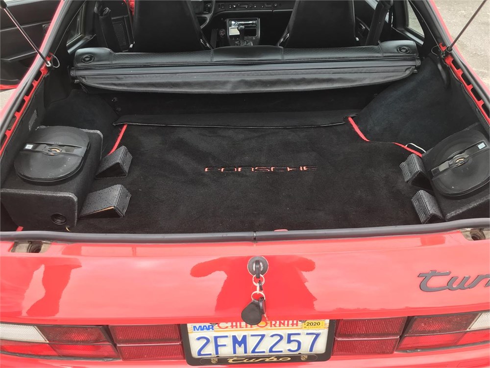

I just did a quick google search, does this help?
2012 VW Tiguan - Kinda stock

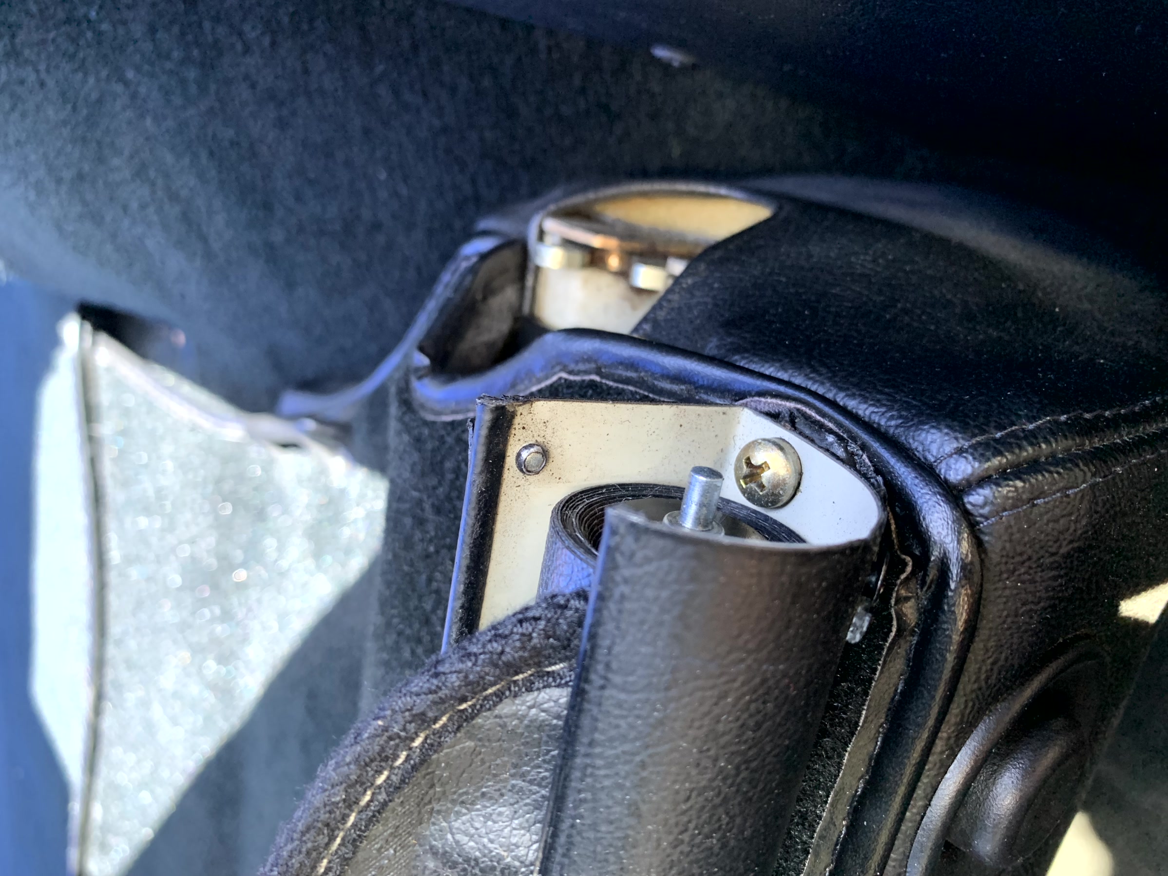

Here's a picture of my S2, with the broken end cap missing. I have new plastic ones from Porsche but might opt for the aftermarket aluminum variety. It's just one screw on each side.
- 20220908_211452282_iOS.jpg (610.28 KiB) Viewed 996 times
