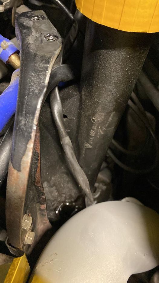

I wish that I would have seen this thread earlier....

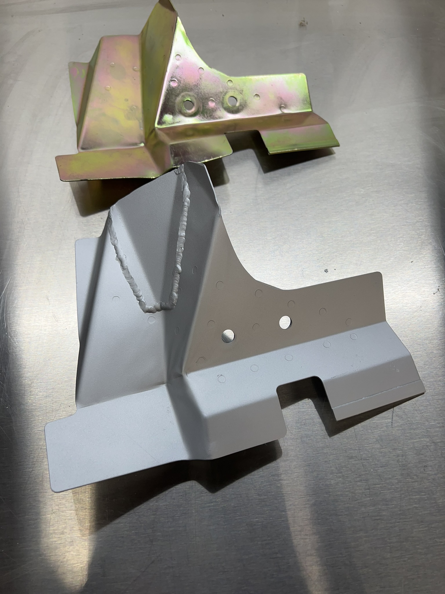

Tom, what material/metal did you use on your insert to the shield?
- Posts: 9098
- Has thanked: 952 times
- Been thanked: 4085 times
Steel. Needs to be steel if you want to weld it. You can get small sheets of steel at Home Depot or Ace, etc. They sell it in various gauges (thicknesses) so shoot for the closest they have to the original shield (which usually means the thickest sheet they sell). For welding, don't get galvanized or zinc-coated steel, just a raw sheet. Like this:

Working on doing another modified shield to clear a 3" downpipe.

Here's the new shield modified and ready to go, with a factory original next to it so you can see the corner that gets cut out to make room for the 3" downpipe. I TIG'd the patch on (one side only) and then painted it in silver High Temp POR 15. I'm a POR 15 fan, and this high temp version is rated to 1200F, so "should' hold up in this location....
