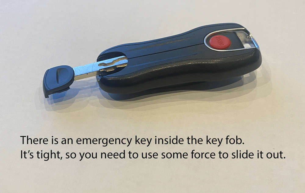

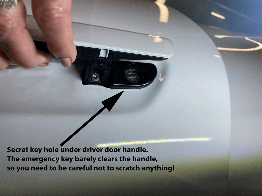

1. Getting into the Car. To get in the car, there is an emergency (physical) key inside the key fob, which is used to open the driver door using the hidden key hole under the door handle.

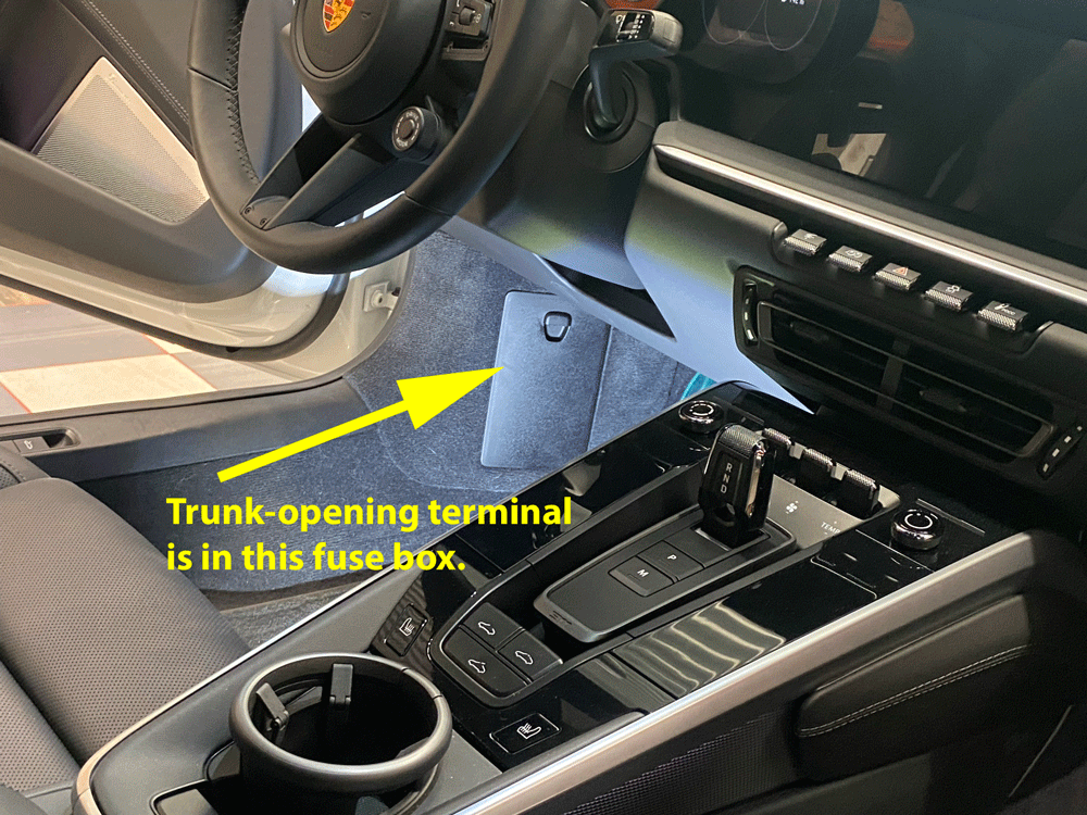

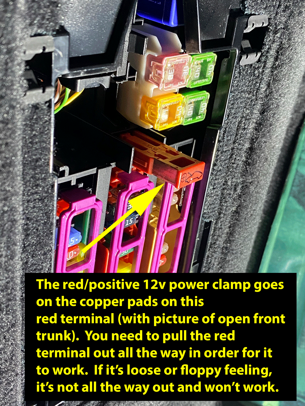

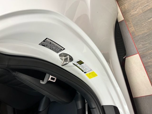

2. Emergency Trunk-Opening Terminal. Once inside, you then need to supply 12 volts to a special terminal inside the fuse box, which allows you to pop the trunk open using the button in the door sill. The special terminal is located in the driver footwell fuse box. It’s red with a drawing of an open trunk on it. You need to pull this red terminal all the way out, and put the red/positive jumper cable on it, and the black/negative jumper cable on the exposed metal catch in the door jamb (or any good chassis ground point). Once power is applied, it will allow you to pop the trunk using the button in the door sill.

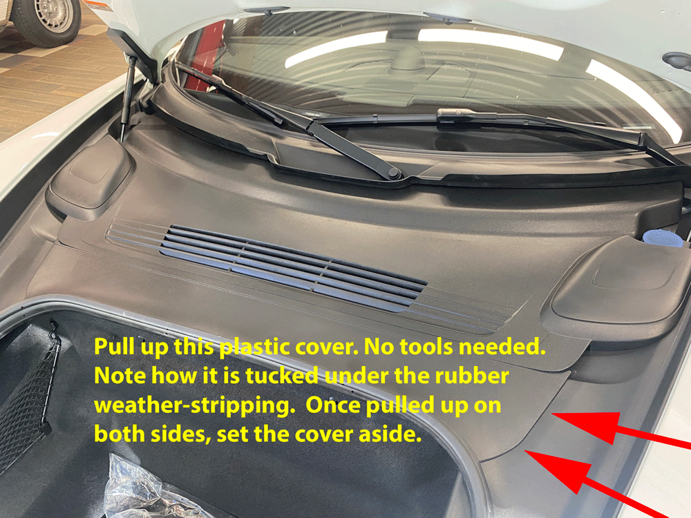

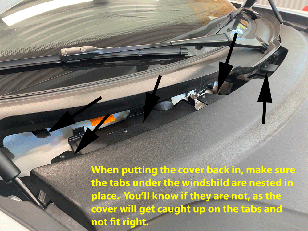

3. Getting to the Battery. To get to the battery, you need to pull off the black plastic cover at the front of the trunk. See pictures below. No tools needed, very simple.
4. Charging the Battery. To ‘reactivate’ the battery, you need to use a battery charger or jumper cables from another car to charge the battery, using all standard safety precautions. Red/positive goes on the positive battery terminal, and the black/negative clamp goes to the special chassis ground post show in the pictures below. It should only take 10 minutes or so for the car to spring back to life. At that point, you can start the car and drive it to further re-charge the battery.

Thanks Tom for this guide! I was going to put on the Bezels you sent me and the battery died after 2 months in the storage - no power there at my spot :-(
One thing I would add to this thought which took me a while to figure out.

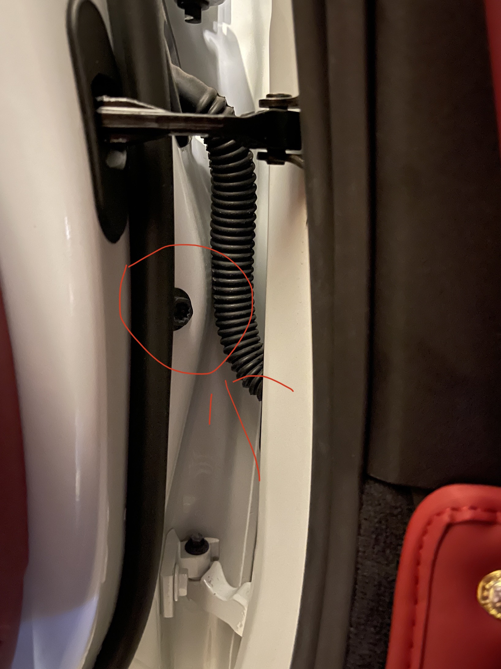

When connecting the 12V battery to the red fuser, the negative has to connect to a metal part of the car. However, seems the hinges are either insulated by the paint or the lubricants. I was not able to pop open the boot. Then I tried to connect the negative to the bolt (picture attached) and it worked!
Anyways, thought I’d share this.
Posts: 9095
Been thanked: 4080 times
Good call. I'll point that out in this post. In the PDF I posted below in the instructional section, it does mention this and says to attach the ground to the metal catch in the door jamb, since that's what the manual suggested iirc. This thing...

Tom wrote: Wed Feb 16, 2022 6:31 pm Good call. I'll point that out in this post. In the PDF I posted below in the instructional section, it does mention this and says to attach the ground to the metal catch in the door jamb, since that's what the manual suggested iirc. This thing...
Also, sorry that happened -- quite the nerve-racking pain I know....
I think the metal catch is a better place to connect the negative, much better grip
