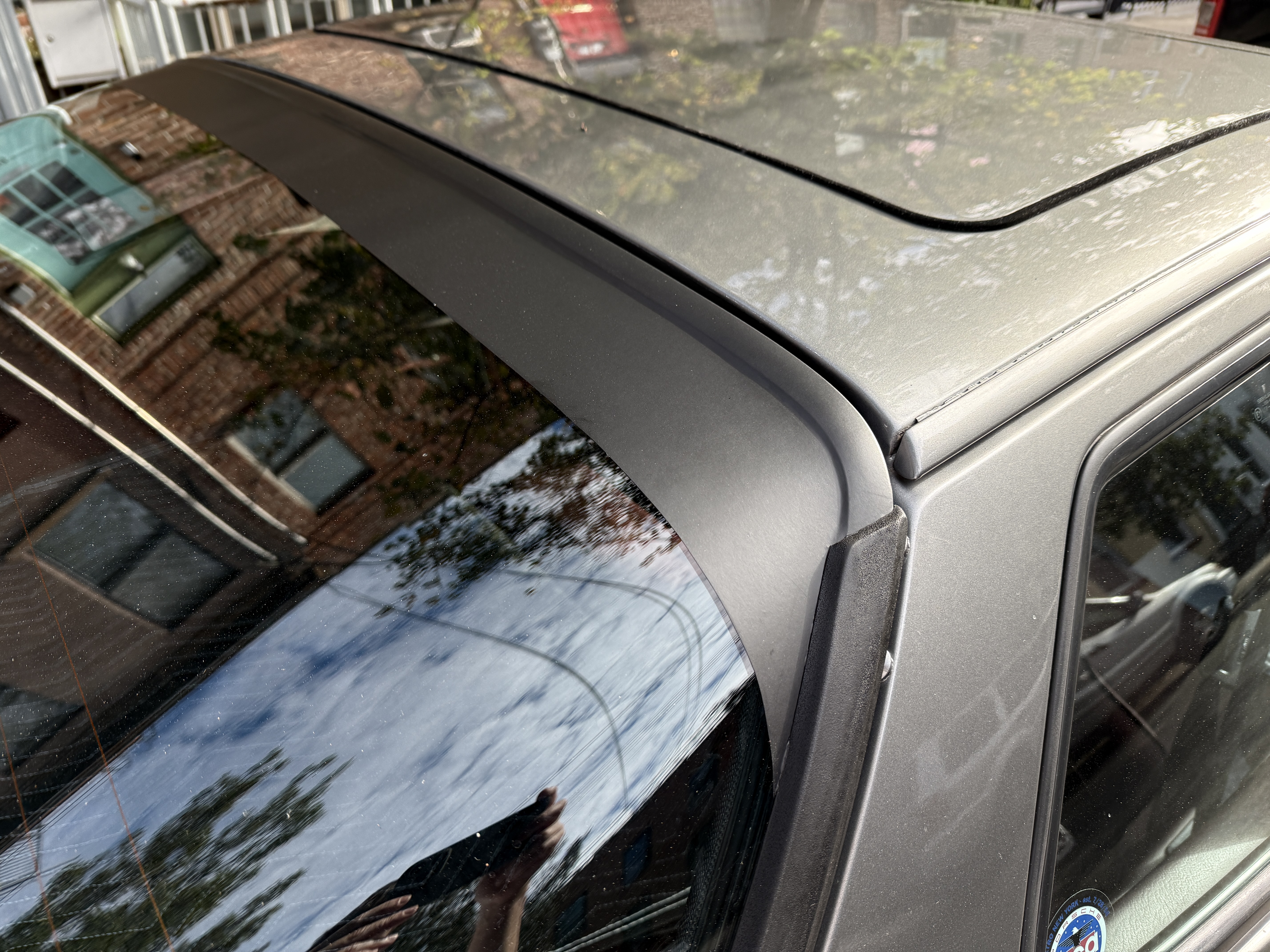

I recently added this strip of black vinyl wrap. Had the shop I get the car detailed at do it. I think it turned out nice. Will it hold? Time will tell.
- IMG_0982.jpeg (4.94 MiB) Viewed 828 times
