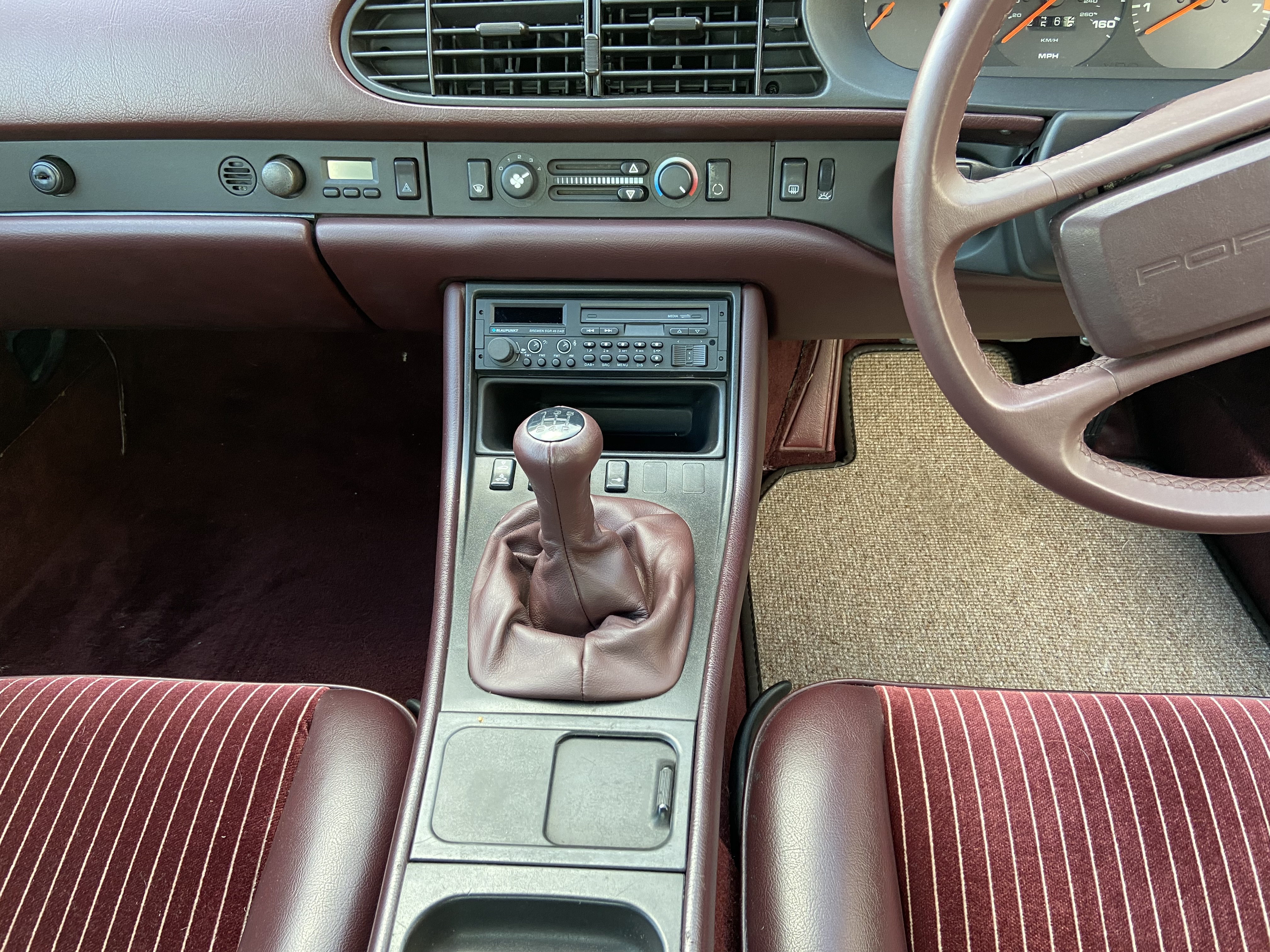

I put the Porsche retro radio in my 944 and like it. It's overpriced, but has the Porsche logo on the screen when it boots up, so that's got to be worth something.
Looks very much like something that might have come with the car.
