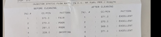

For some additional background, I had my injectors cleaned and flow-tested before the car sat. It ran great afterward, but then it sat for about 11 months. When I finally started it again, it felt like it wasn't firing on all cylinders. After checking everything over, I noticed it was running extremely lean (16-18 AFR). I pulled the injectors, had them checked and found they had all gone bad. Once I had them refurbished and reinstalled, the AFR came back to where it should be (around 14.7). The car still has a slightly rough idle, and the AFR oscillates between about 14.7 and 15.1 at idle, but it averages right around 14.7 while cruising.
