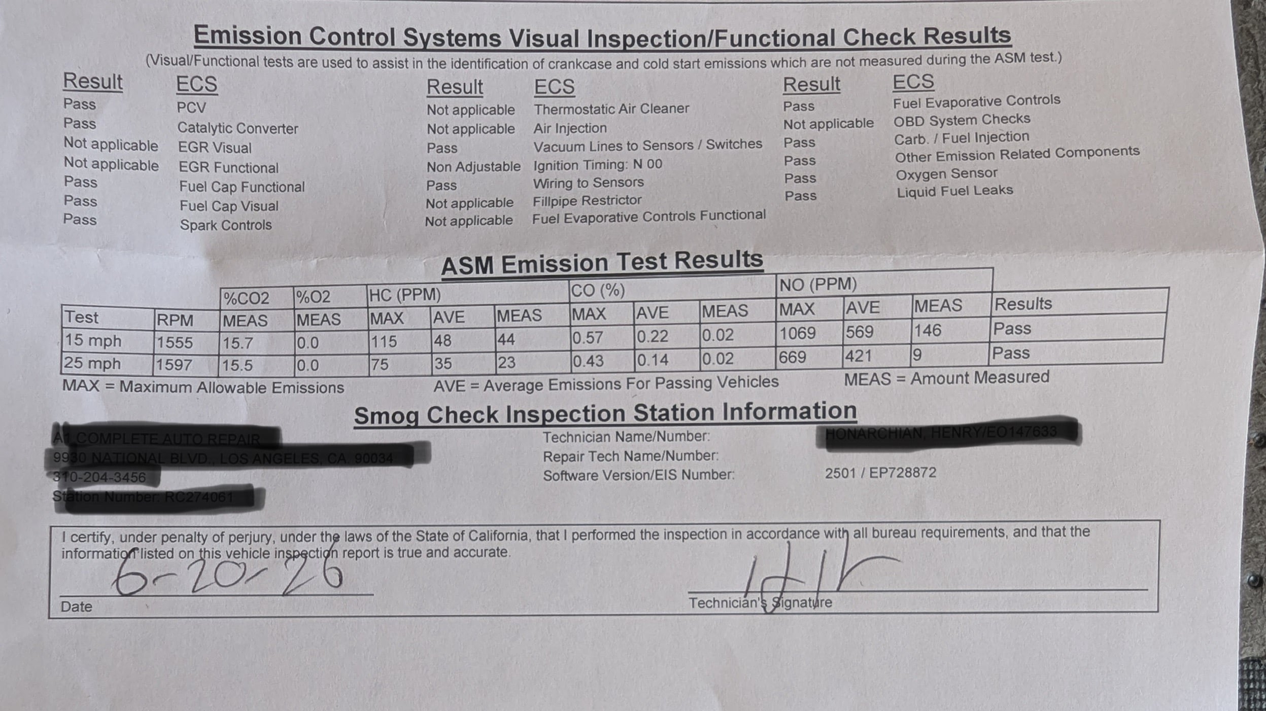

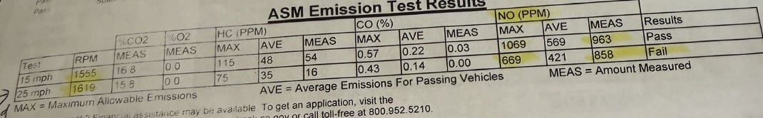

Fast forward another 2 years and happy to report I passed smog today, but not without some effort.

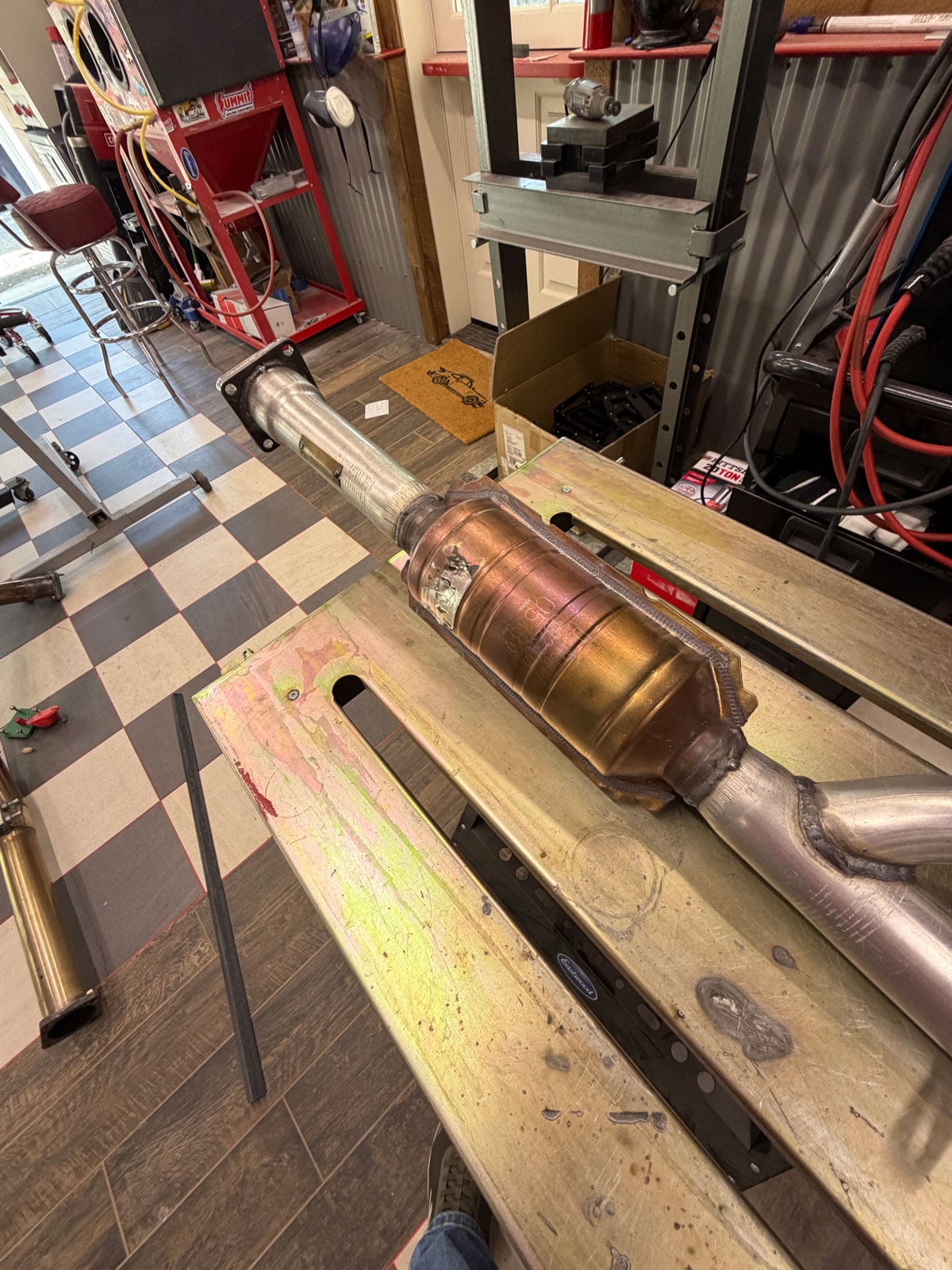

By way of background, I've been using an aftermarket cat made by DEC, which I bought before my 2018 smog test. It was a direct fit aftermarket cat I've documented in the past -- typical CARB-legal cat with minimal 5 year warranty. I had been preserving it between tests, but did a poor job of that since the last test in '24. Big mistake, since I was also burning chips and beating on the car in general.
Bottom line, it was already 3 years past its warranty period, and pushing the car on this cat seemed to cook it. With the car freshly tuned (new plugs, cap, rotor, oil, O2, etc.) and all my regular pre-test rituals complete, the car failed smog for the first time ever.
These aftermarket cats just don't seem to last very long sadly (at least compared to the NLA factory originals), but the tech also did the 25mph test in 3rd gear. Whether that was an honest mistake or good for re-testing business, I'll never know. See page 9 of the Smog Check Manual here, which says to use second gear. If you look at posted results across the internet, tests that show ~1700 rpms on the 25mph test (i.e., 3rd gear) consistently show higher NOx compared to cars tested at ~2400 rpms (2nd gear). Lugging it bumps the exhaust temps and NOx. This cat was clearly sick, so it's 50/50 whether it would have passed in second, but PSA: when going for CA smog, make sure the test is done in second gear -- per the state manual -- otherwise you will likely see higher numbers!

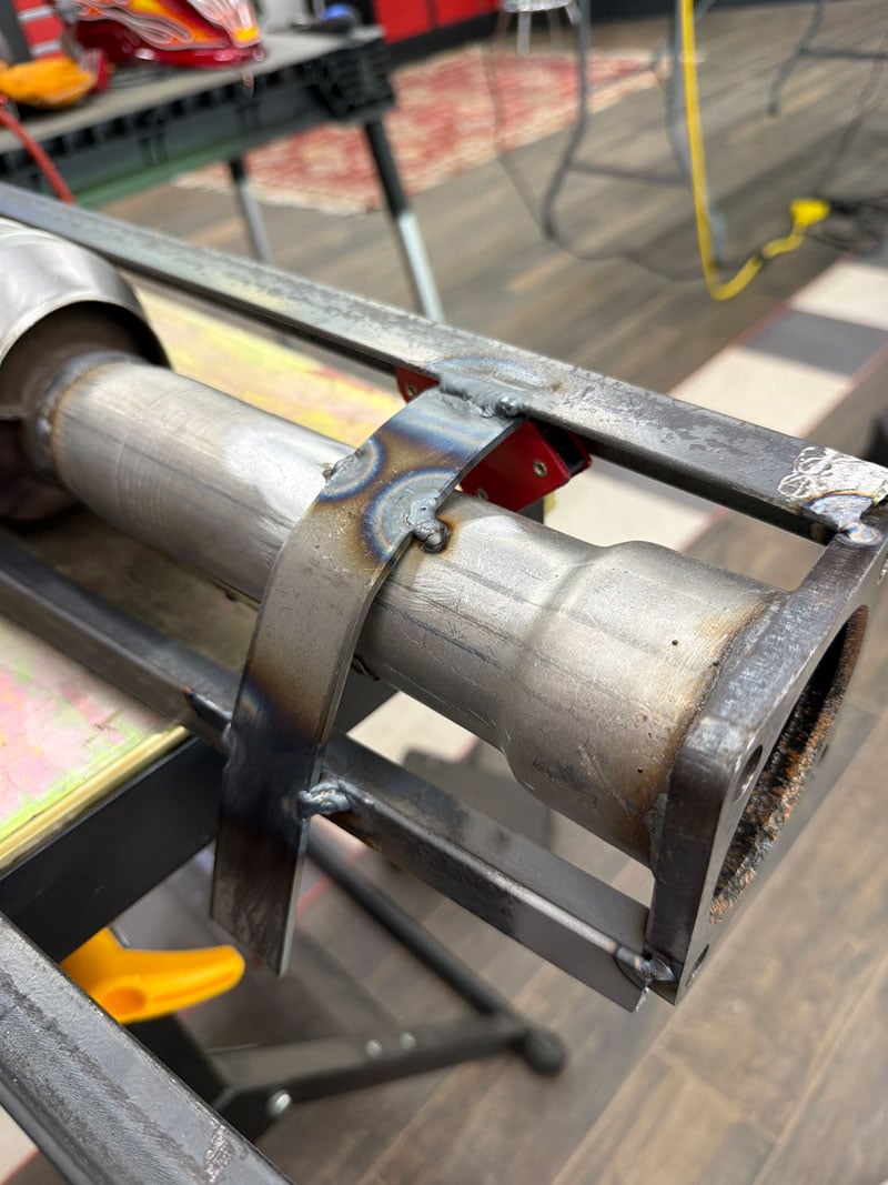

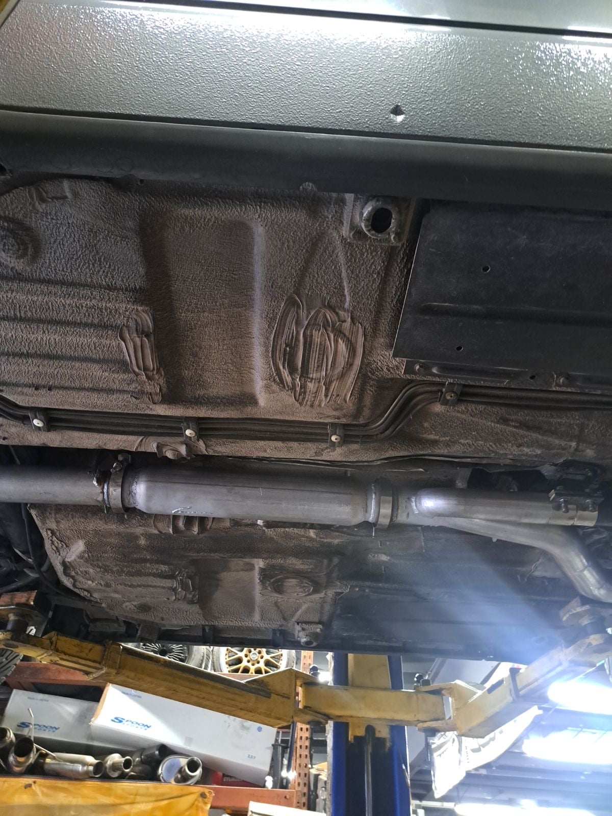

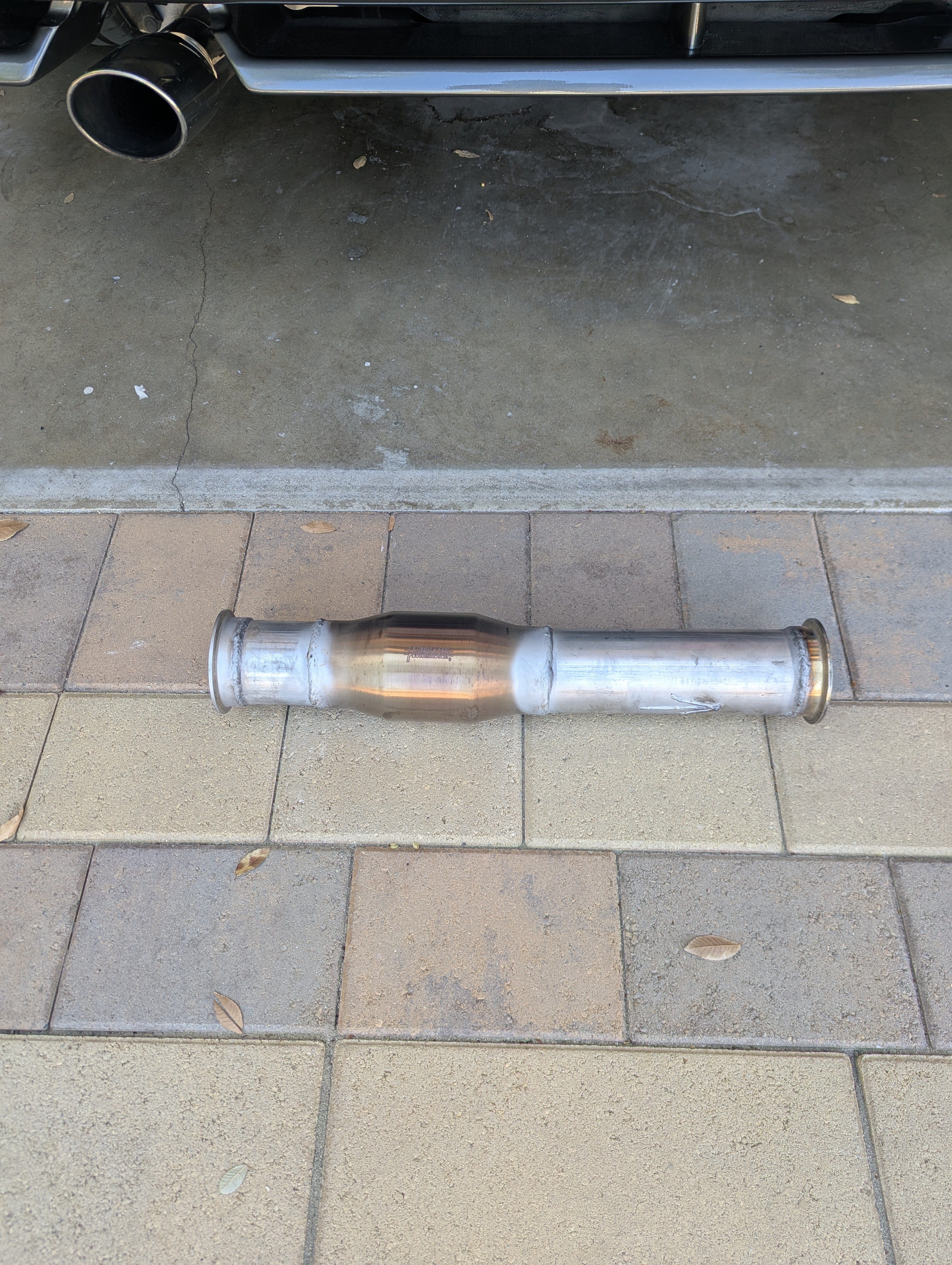

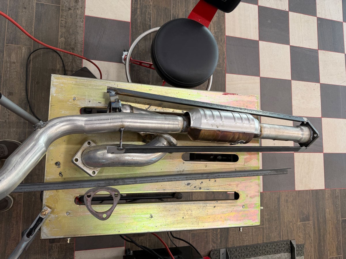

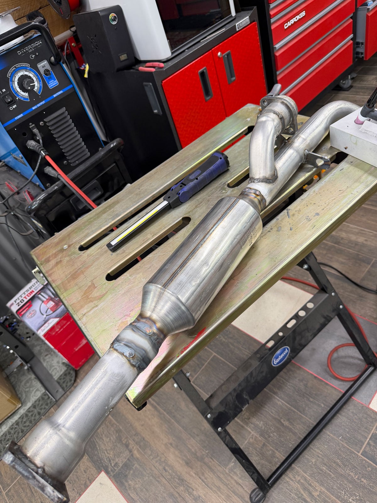

Since the cat was low-quality (IMO), old, and weak anyway, I opted to replace the cat rather than call the guy out for using the wrong gear. Unfortunately, I learned in the process that DEC no longer sells the direct fit cats. (They might make you one on request, but I didn't want to wait for that). Since there are no direct-fit, bolt-on CA-legal cats on the market, I opted to reuse the DEC pipes and just cut out the cat and weld in a new one. Turns out only MagnaFlow is currently making a CA-legal cat for the 944, with a choice between one with 2" inlet/outlets or 2.5". I chose the 2" to match the DEC pipes better.

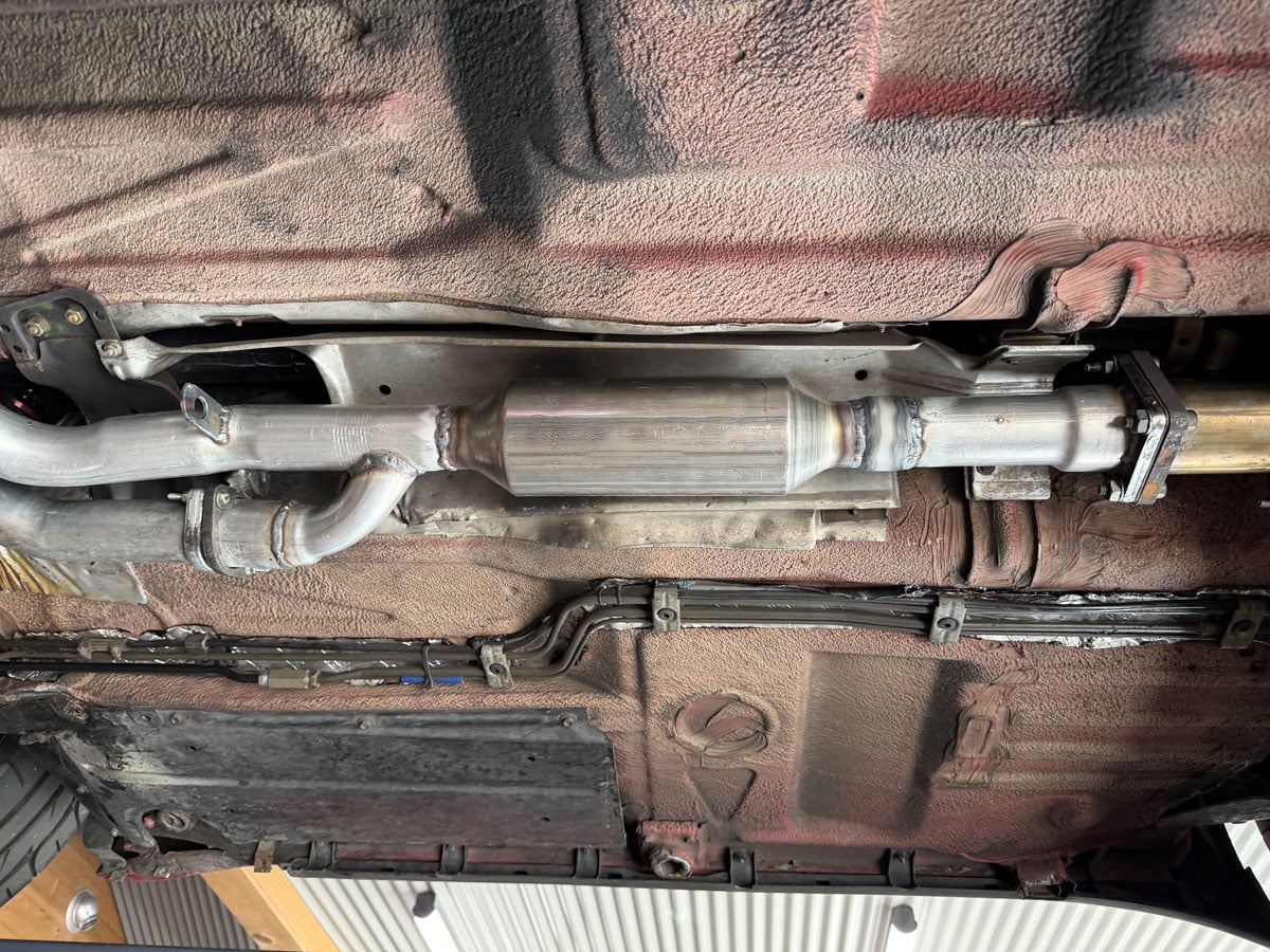

I opted to take the whole DEC unit out of the car, and brace it up so that I could cut out the cat and replace it without losing the correct orientation of the flanges. The alternative is to weld it in the car, but I'm just not that good of a welder. :) The Magnaflow is also stainless, and had to be welded to the aluminized steel pipes on the DEC, which was a whole other fiasco. After a climb up the learning curve, I ended up getting 309L filler rod, which allows you to TIG weld steel to stainless. Who knew... Resulting welds are not Insta-worthy with titanium rainbows, etc, but they are solid welds that did the trick.

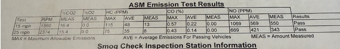

Car passed with good numbers! I will be taking very good care of this cat, and might even buy a spare. If MagnaFlow stops making this cat, there would be literally no available new CA-legal cats for these cars -- at least none I could find that are available to buy right now!
Worth noting that the new cat cut the 15mph NOx by 43% using the same gear and all other things the same as the first test. At 25mph, the NOx went down by 60%, some portion of which (17%?) was no doubt attributable to running it in the correct gear/rpm.

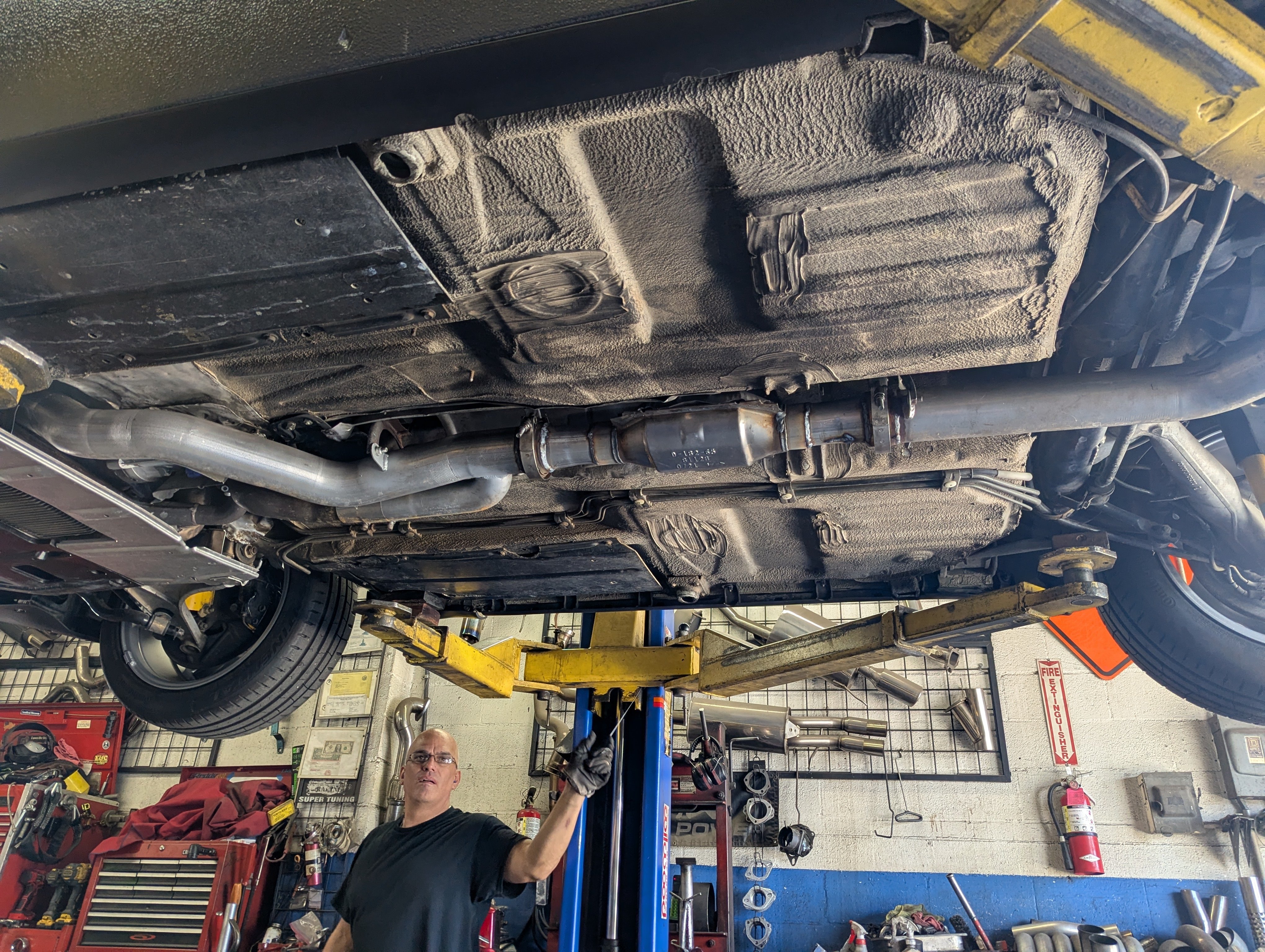

FWIW - I replaced mine with a 2.5” walker 81128 in 2020 and it passed again in 2022 and 2024, so we will see if it makes it later this year.
I did see that a walker 81328 is a fit, available and is on the CA eod list if magnaflow is nla. Always subject to change I suppose.

whalenlg wrote: Fri Jul 10, 2026 6:41 am FWIW - I replaced mine with a 2.5” walker 81128 in 2020 and it passed again in 2022 and 2024, so we will see if it makes it later this year.
Wish me luck - with a 1986, Leno is not going to save me.
Good call on the Walker 81328. It does seem available (and cheaper) so nice to know there's more than one option! Walker is lower quality in my experience (at least if the Walker muffler I got for my Mercedes is a guide), but for carb-legal cats, I'm guessing they all pretty much include the bare minimum to achieve certification. The Walker also appears to have heat shields, which are curiously missing on the MagnaFlow...
