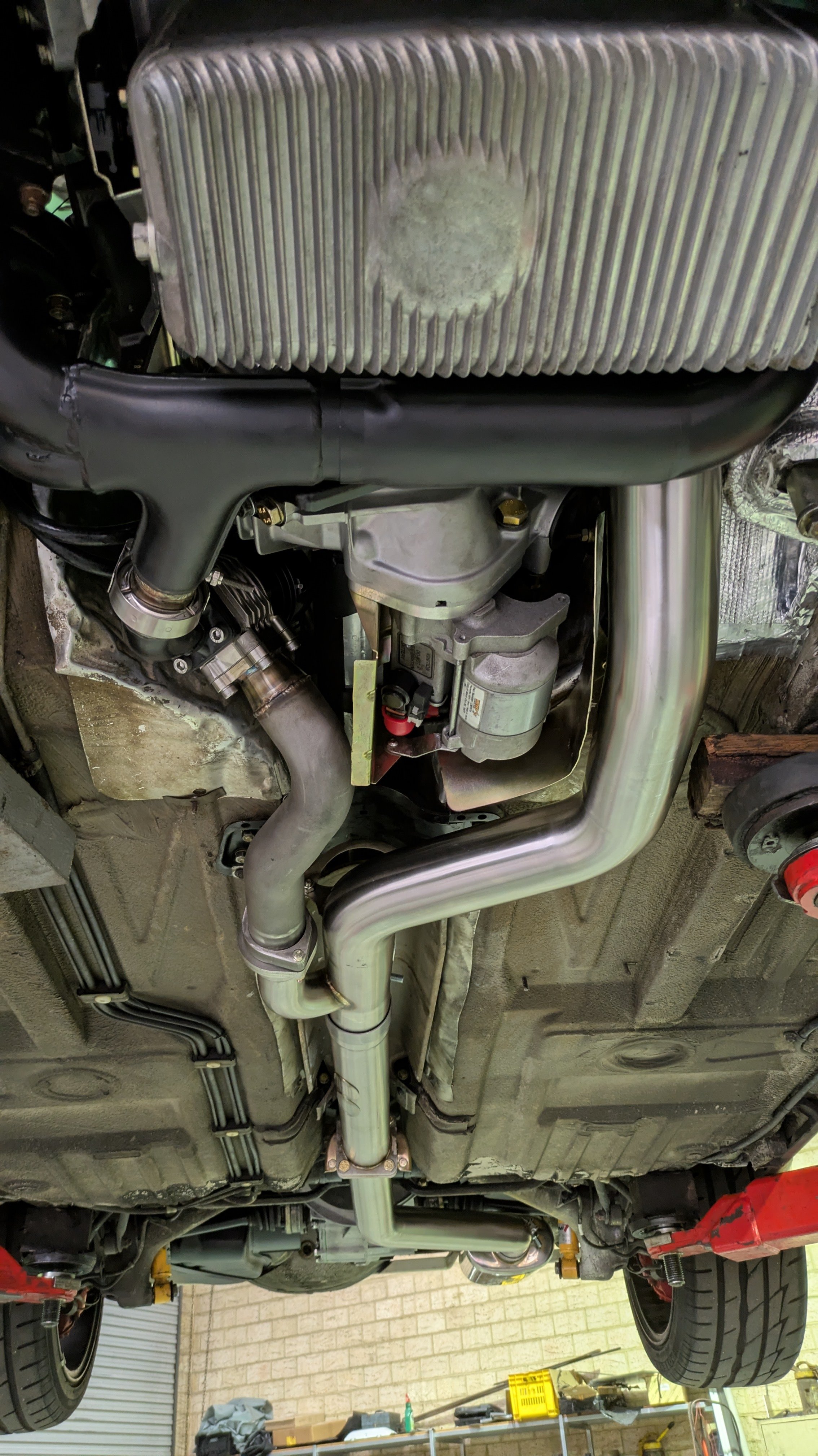

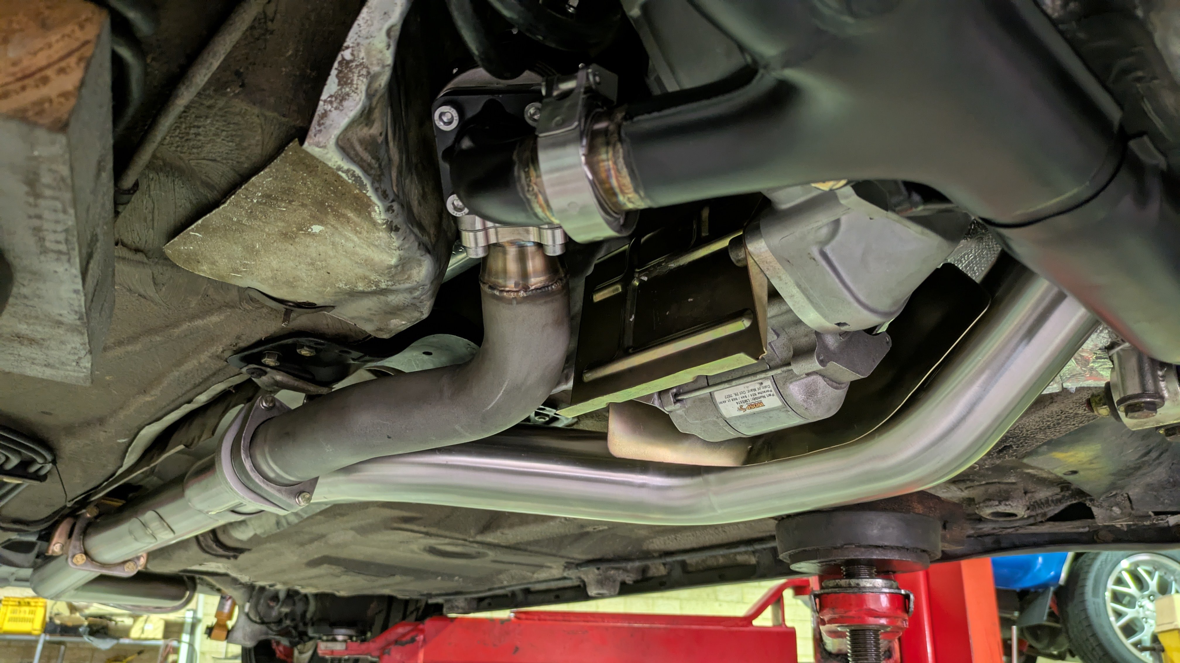

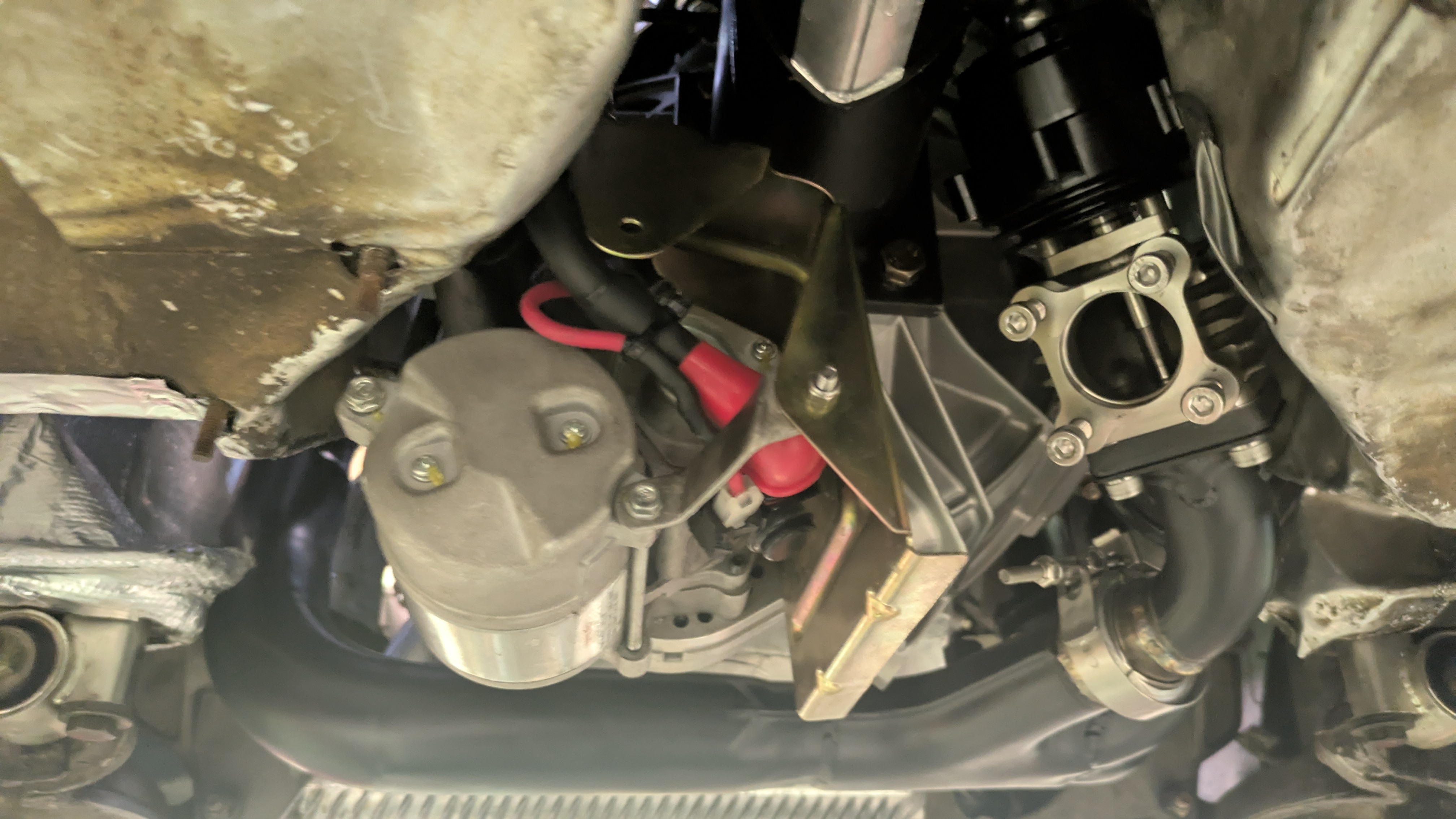

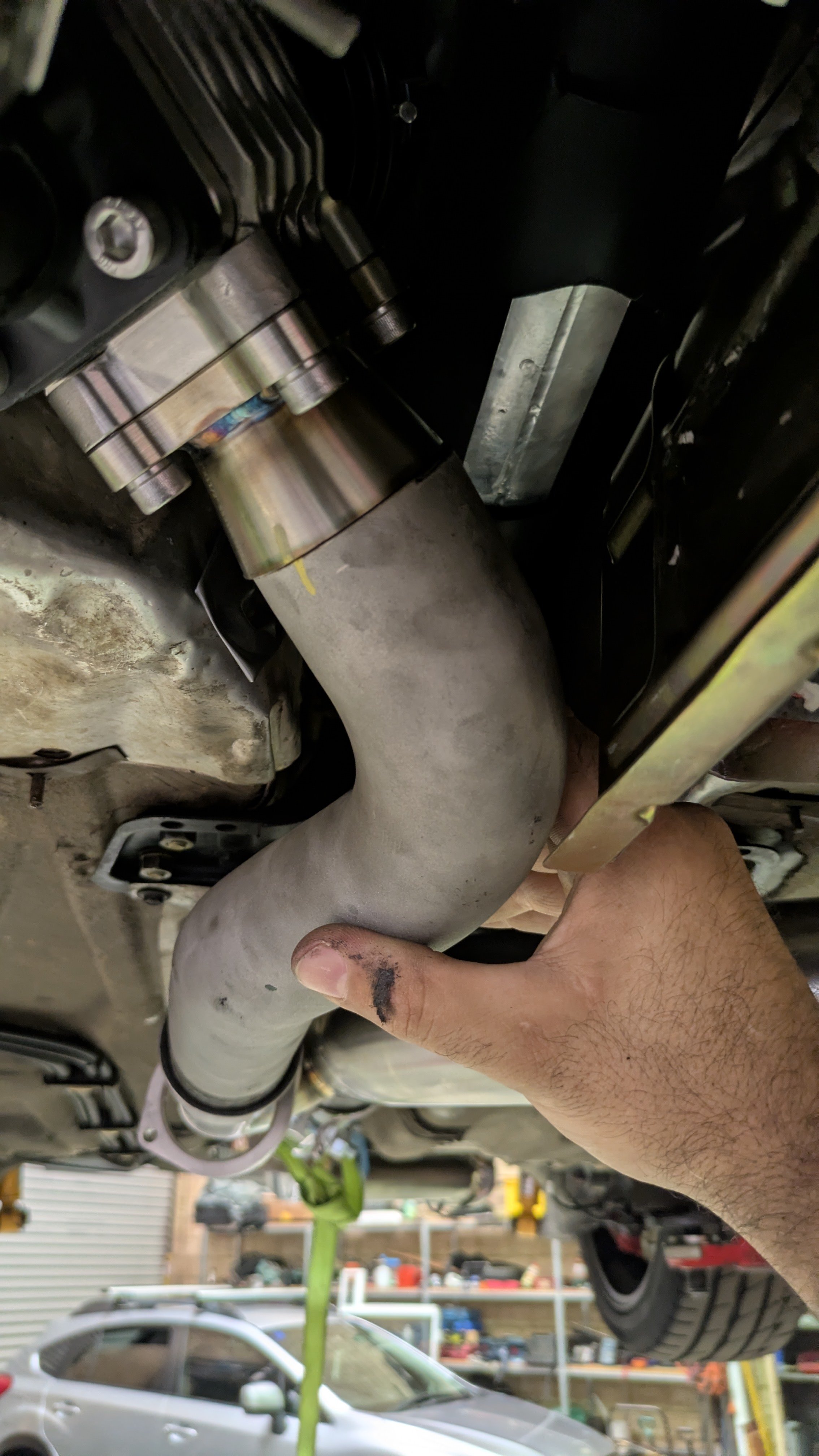

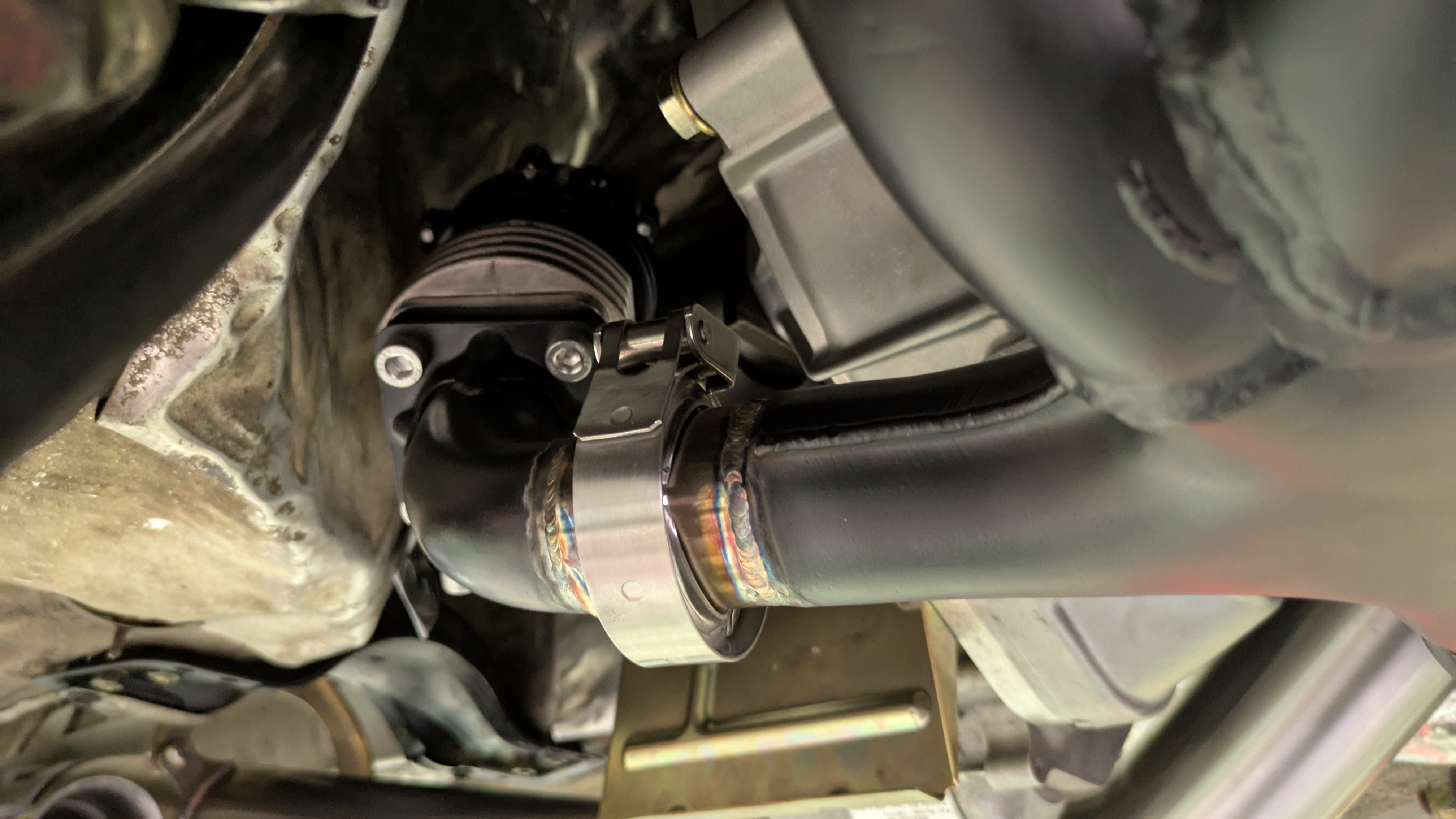

Pictures of my setup below, it seems to be working ok without the brace for now, I could only find a one piece crossover so I had to modify it with a v-band to get the wastegate at the right angle. Generally you go for the spring closest to half the max boost you want to run. Im running 18psi with a 10psi spring

Bergerac wrote: Mon Jul 06, 2026 9:24 pm Pictures of my setup below, it seems to be working ok without the brace for now, I could only find a one piece crossover so I had to modify it with a v-band to get the wastegate at the right angle. Generally you go for the spring closest to half the max boost you want to run. Im running 18psi with a 10psi spring

Thanks, this is really helpful! Factory wastegate and exhaust is out. I will install the TiAL, new exhaust and MBC tomorrow.
