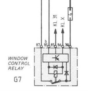

The power window relay remaining activated until the door contact switch closes was a feature on all the P-cars of the era, and is a common cause of battery drains----usually due to corroded door switches and/or body ground contacts. I've also seen a few bad window relays staying latched on with no external influence.
This was one of my first tests as an apprentice over 21 years ago, a customer 964 had a 250 mA drain, and my boss knew what it was right away. He handed me the factory electrical system manual with the wiring diagrams and told me to figure it out. It took me much of the day to figure out exactly why the power window relay was remaining activated, but I eventually figured it out, corroded door switch
