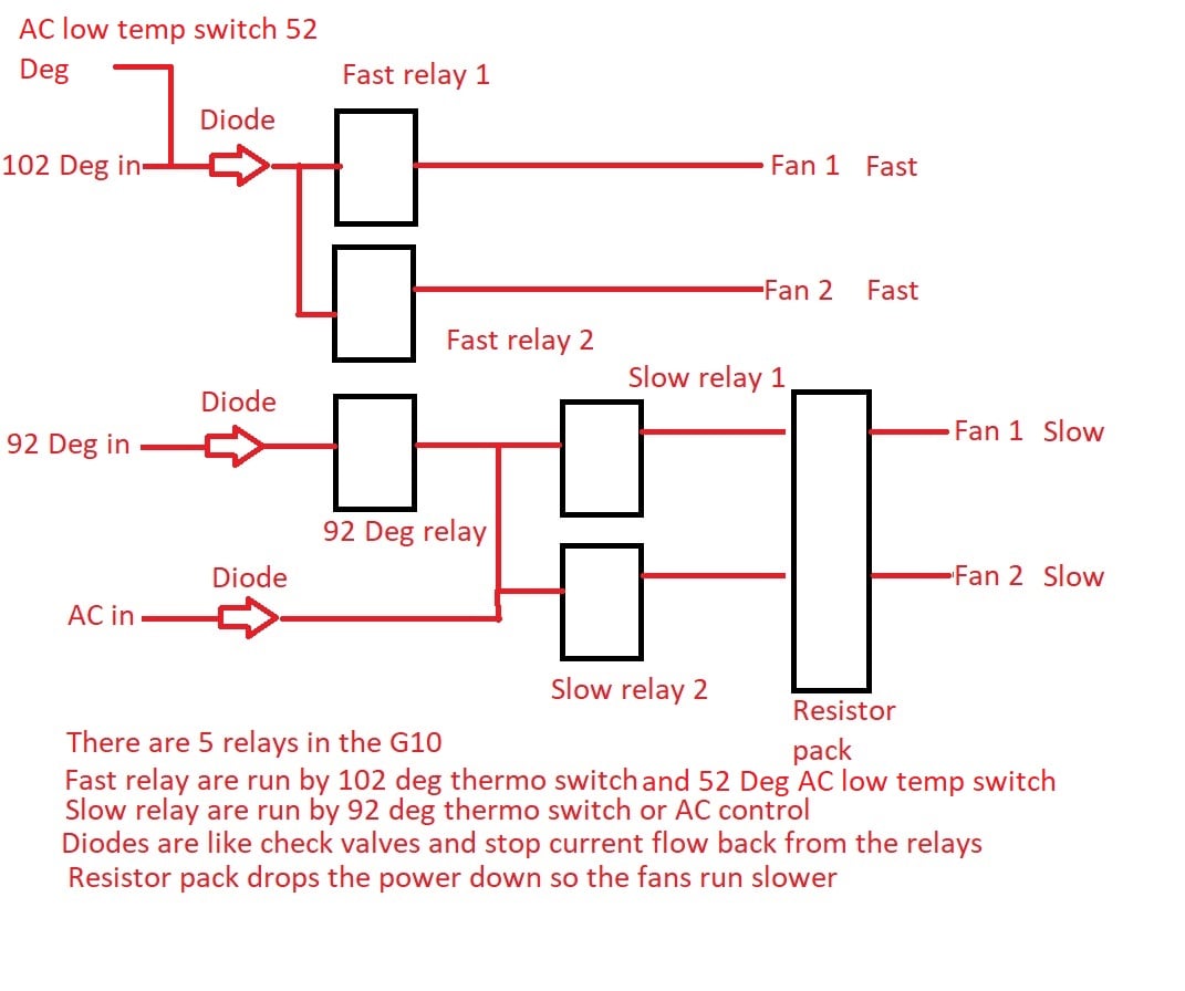

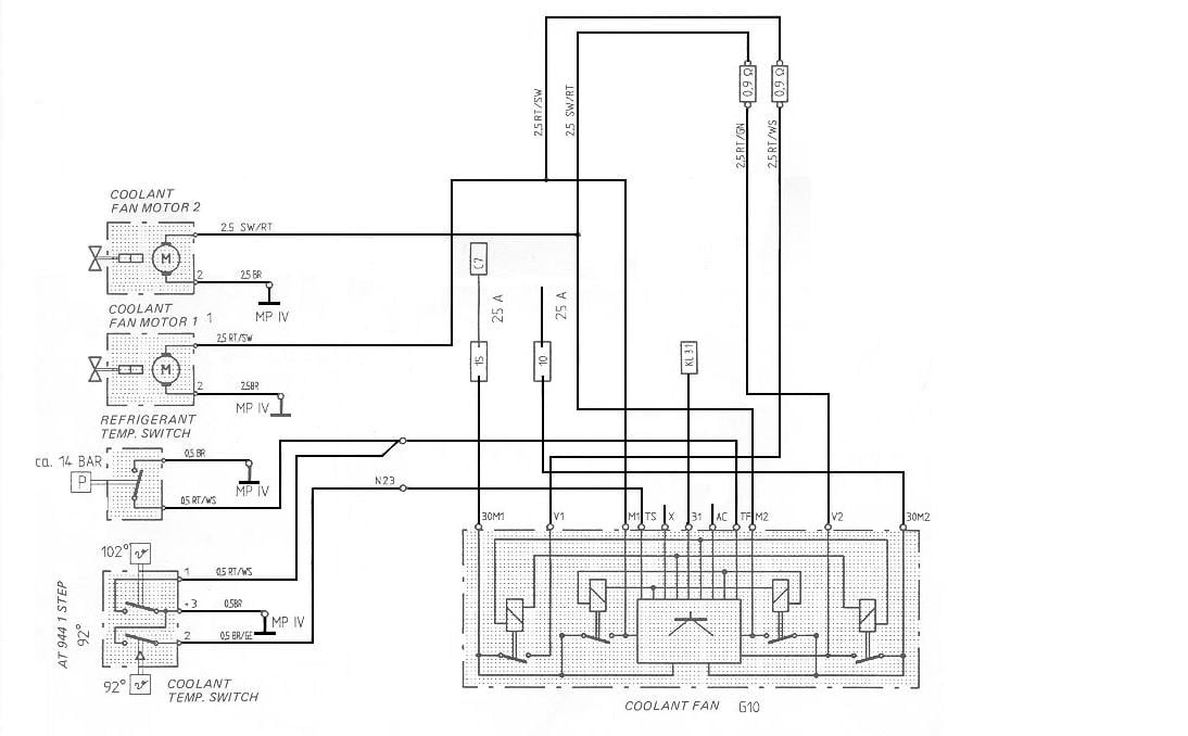

There is a whole bunch of info here if you like.
https://forums.pelicanparts.com/porsche ... ystem.html
Also inside of the fan relay.....
Sox
cooling fans circuit.jpg (123.07 KiB) Viewed 75 times
coolant fan relay G10 block.jpg (161.71 KiB) Viewed 75 times

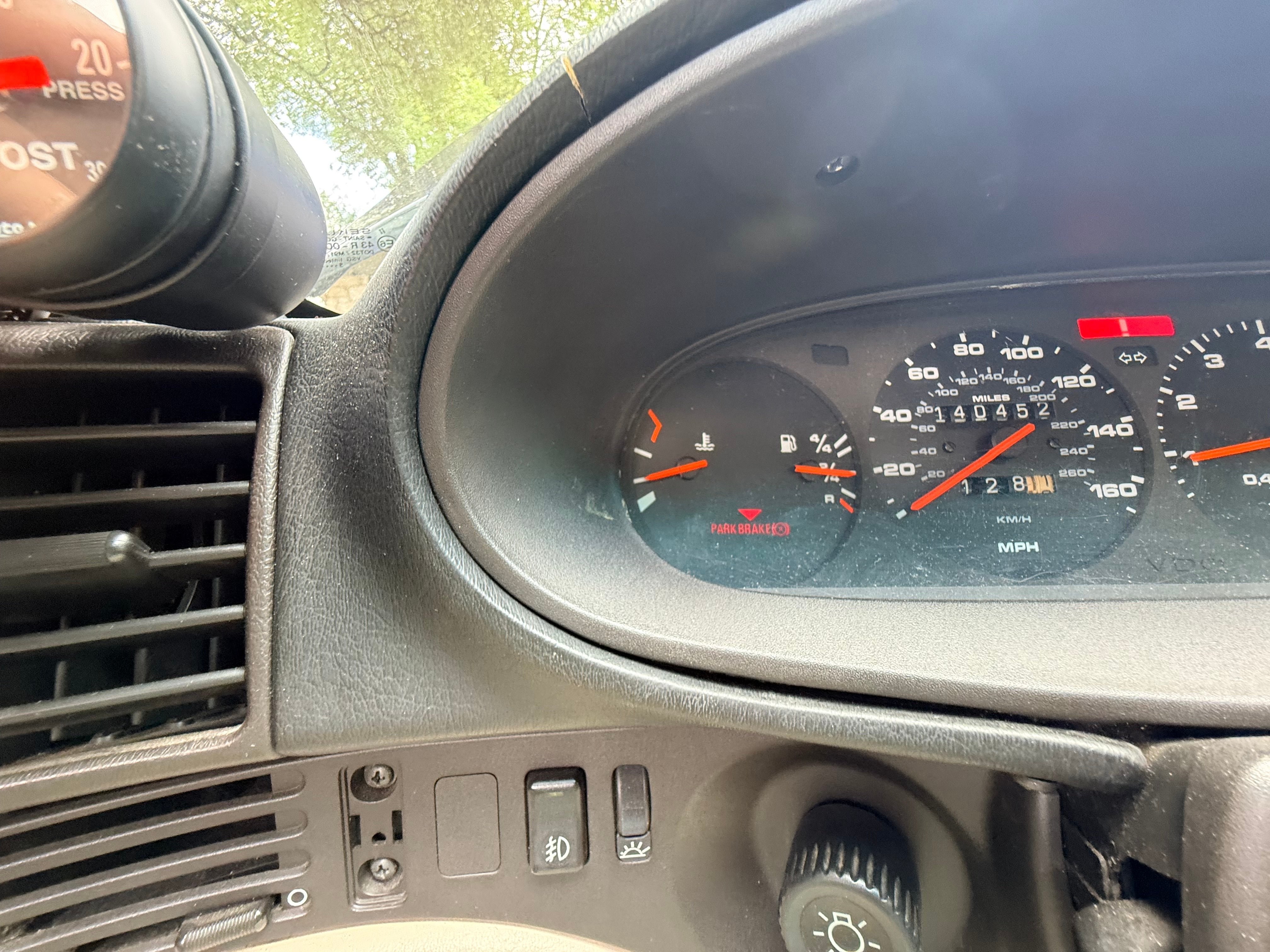

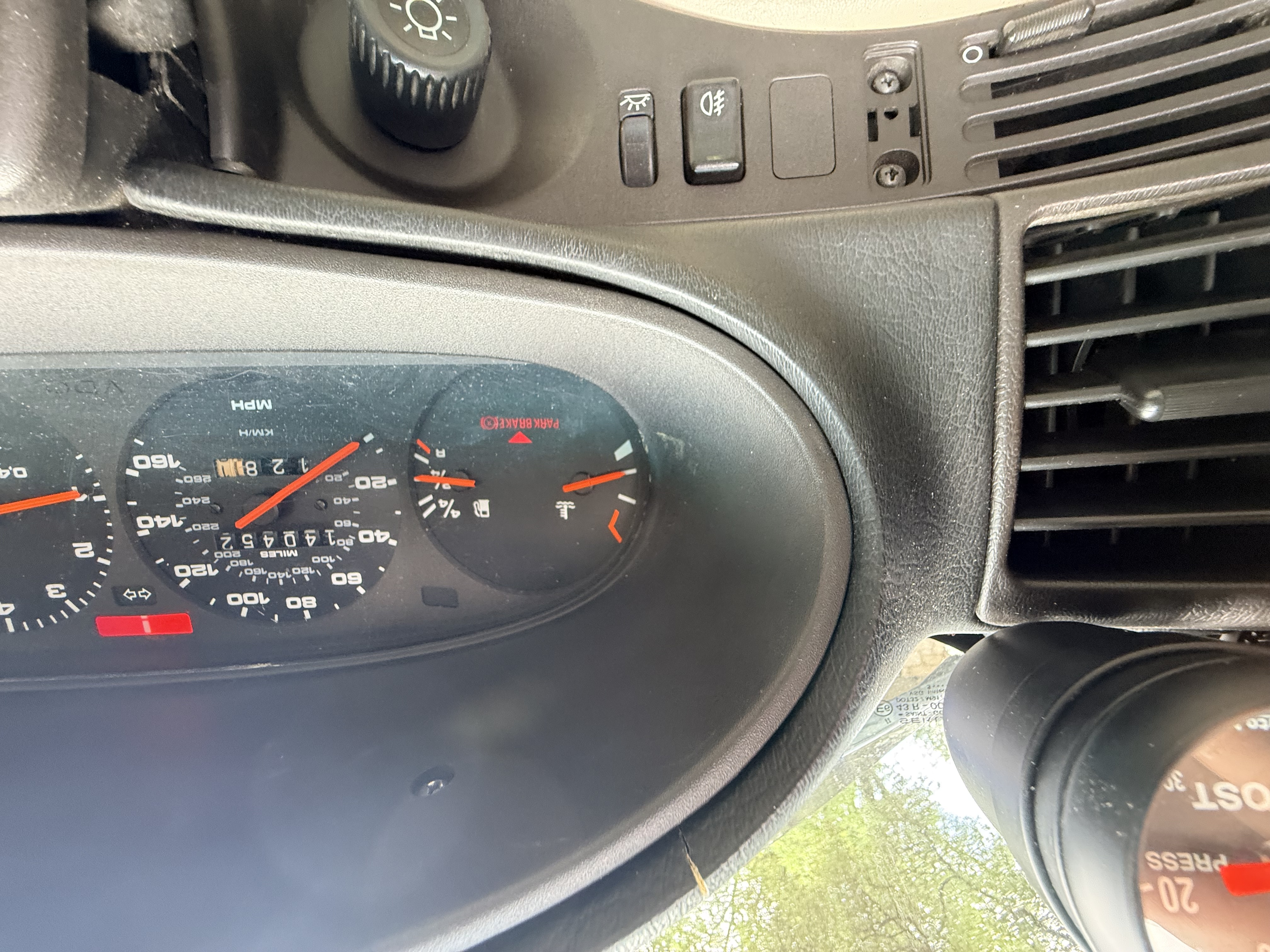

Unfortunately, I’m still seeing the same behavior. The fans run even when driving around for 15-20 mins. The only difference is that the car is running very cool(at least that’s what the gauge says), assuming that’s because of the 71C thermostat. It goes very slightly above that first mark and that’s. The fans will shut off the first two or three cycles but that’s it. After that, I can’t get them to shut off until I turn the car off whether I am driving or idling. They will run for about 5-6 mins after the car is off and shut off. I have tried to bleed the system all day today. I drive around 35-40 mph for 15-20 minutes. Come to a stop fans are still running. So driving does not seem to help, so curious what that means. Restricted airflow? Crack the bleeder and no bubbles, just steady stream of coolant.
So why does the dash gauge stay very cool on the first line but the Thermofan switch that when I tested it, kicks on at 98c and off at 92c presumably stays above 92c because the radiator temp? So it seems like the temp where the thermofan switch is located in the radiator just isn’t stabilizing below 92c after the car is fully up to temp. Any other ideas? I will keep trying to bleed the system but not convinced it’s just that at this point. This behavior has persisted through so many iterations of different parts..
I guess I could try the grease fitting/clear tube method of bleeding the system but I’m just not convinced that will do anything. @Tom I know you mentioned to pull the thermostat and run it but shouldn’t having a lower rated thermostat that I know fully opens before 79c be a good test? Attached is a pic of where my gauge sits now which looks great but the fans just run and run and run! I’m very stumped. Wondering if the thermostat is actually too low? I thought the 85C thermofan switch would be a better fit but apparently not.

Sounds to me like you debunked the mismatched thermoswitch/thermostat theory, so I agree it's not worth trying the no t-stat idea now. I'm now curious is the fans are running via the a/c circuit. Does your a/c work? When the ac is on, the fan relay gets a signal to turn the fans on low. I'm wondering if that signal is either incorrectly stuck on (high, 12v) or if that portion of your fan relay isn't working right? Have you tried a new fan relay? It's a fairly complicated relay with plenty to go bad inside. (F9 makes a nive solid state replacement.) I have a foggy recollection that @chris white discovered this exact failure mode back during the Hoover Administration....?
If you've tried new/multiple relays and still have the issue, you might check pin A8 of the climate control unit. It should only have power when the a/c is on. I would think your a/c would be running if that power were stuck on, which is why I ask if your a/c works, but stranger things have happened...
