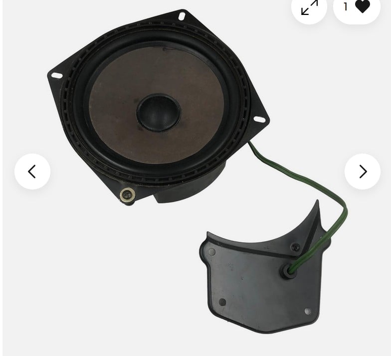

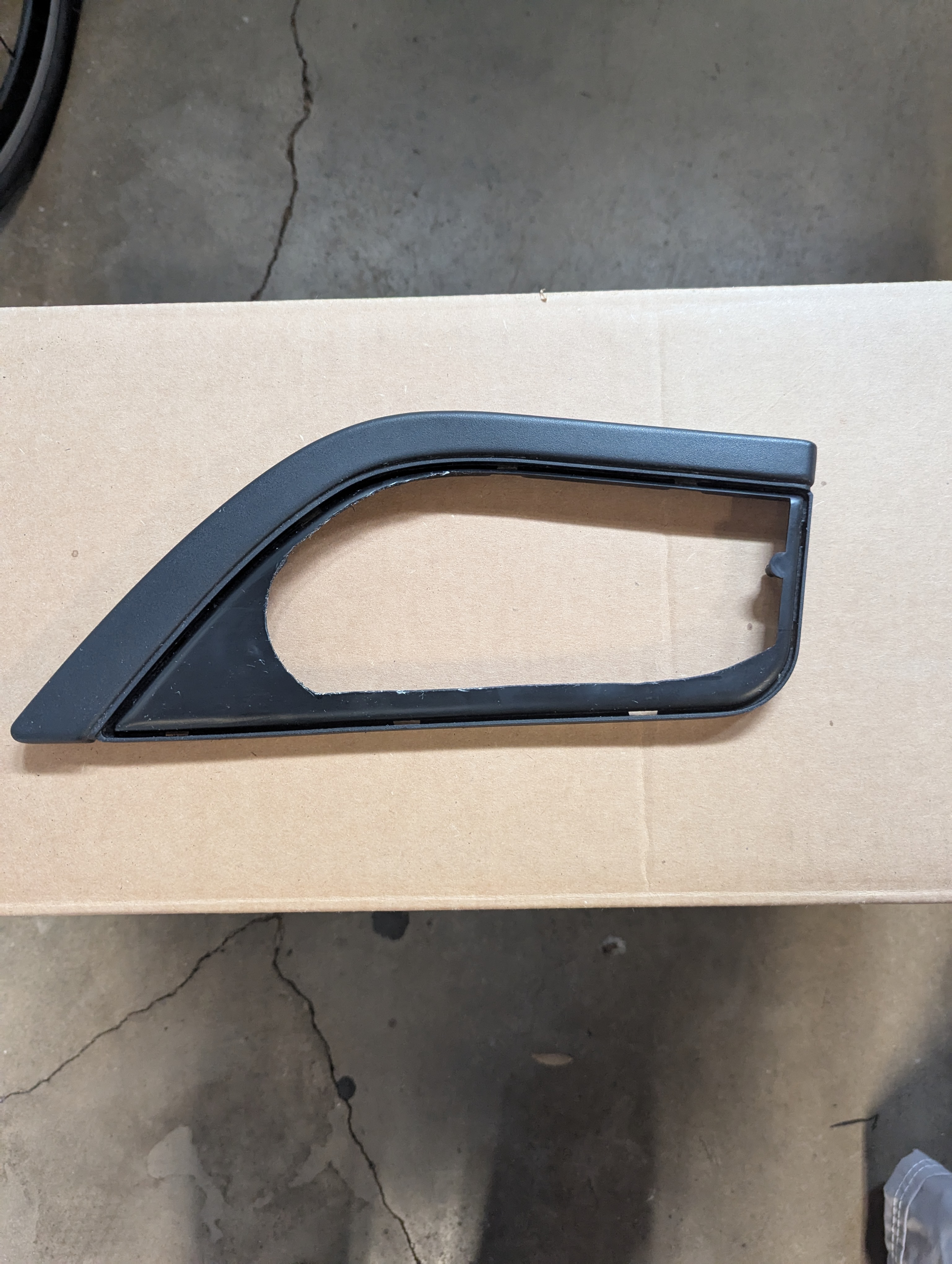

I think this is the stock round rear speaker and adapter. Is that small plastic piece on the bottom all that's needed to get any 6.5" speaker to fit? I saw this on ebay in the EU. From what I can gather, there is a L and a R side adapter plate. But, you're right that it wouldn't be too hard to fabricate your own, but the real piece is nice too.
Is this what you bought from Germany?
Regarding the front speakers, I struggled with many that didn't fit nicely so I just ordered directly from Porsche dealership. They sound fine and fit perfectly.
psperl
Posts: 5
Joined: Wed Apr 22, 2026 5:47 am
Been thanked: 5 times
chrischrischris wrote: Wed Jun 17, 2026 7:29 am I think this is the stock round rear speaker and adapter. Is that small plastic piece on the bottom all that's needed to get any 6.5" speaker to fit? I saw this on ebay in the EU. From what I can gather, there is a L and a R side adapter plate. But, you're right that it wouldn't be too hard to fabricate your own, but the real piece is nice too.
Yep it's just two small pieces of metal like in your photo and both sides are different.

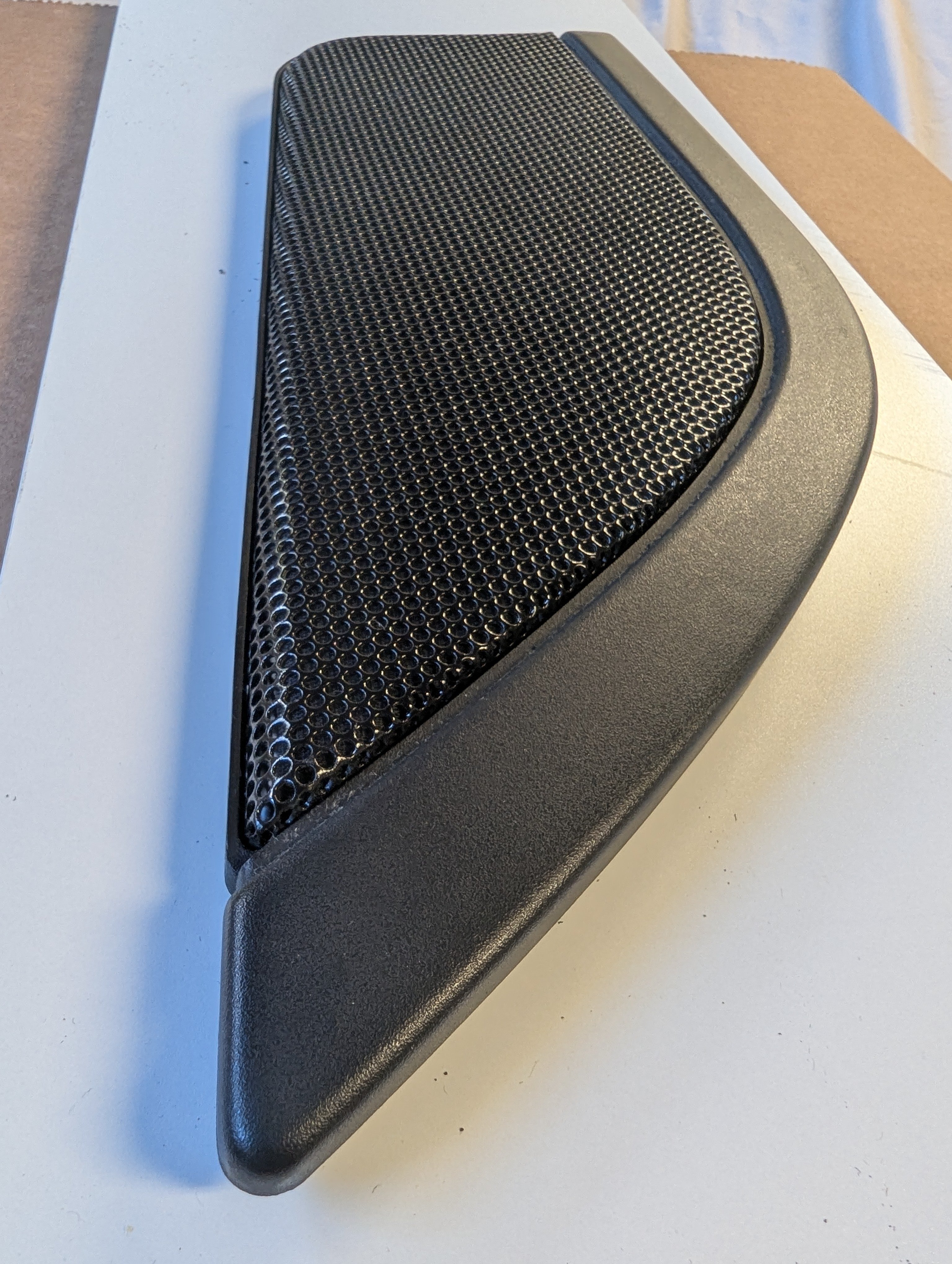

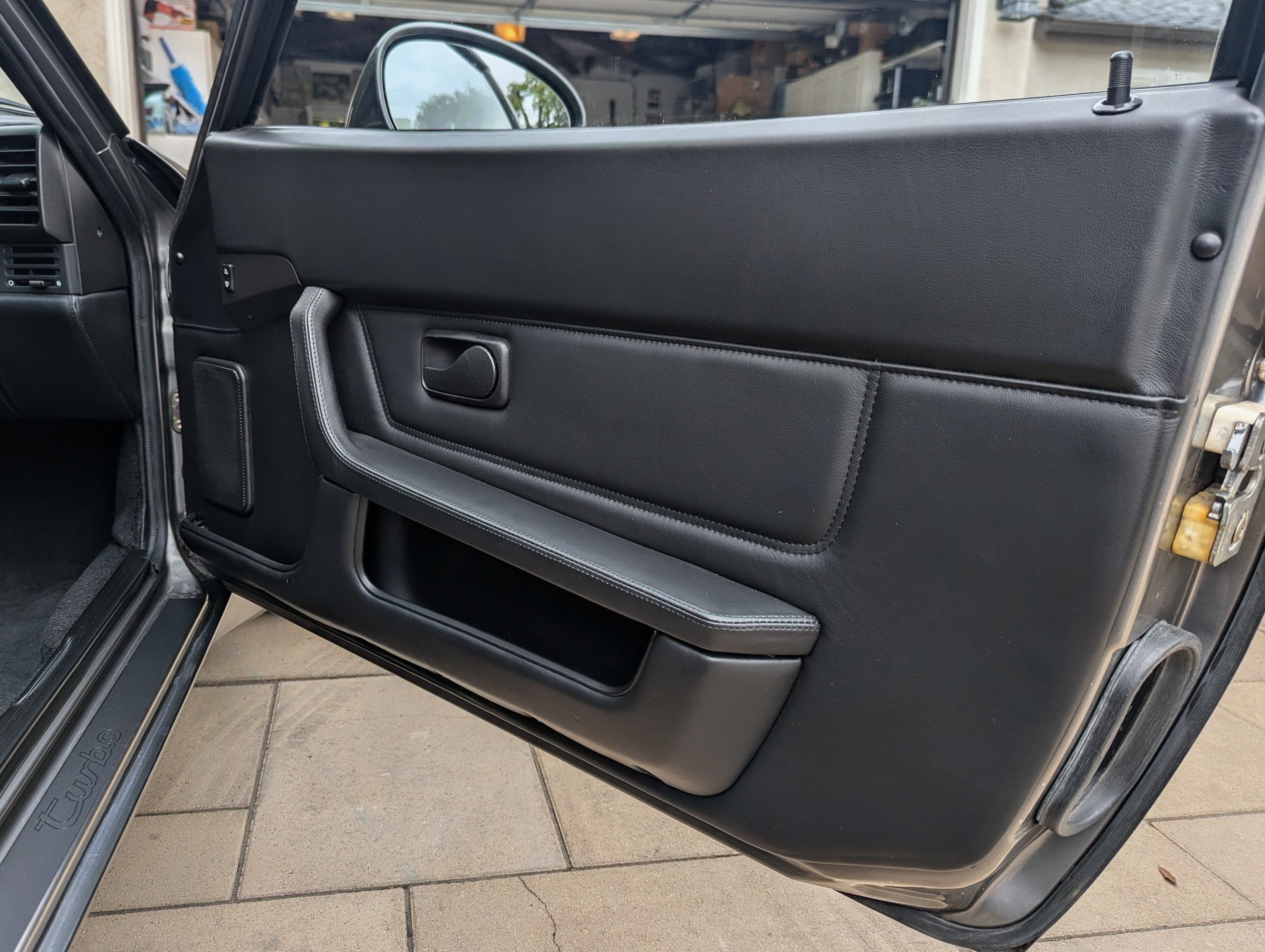

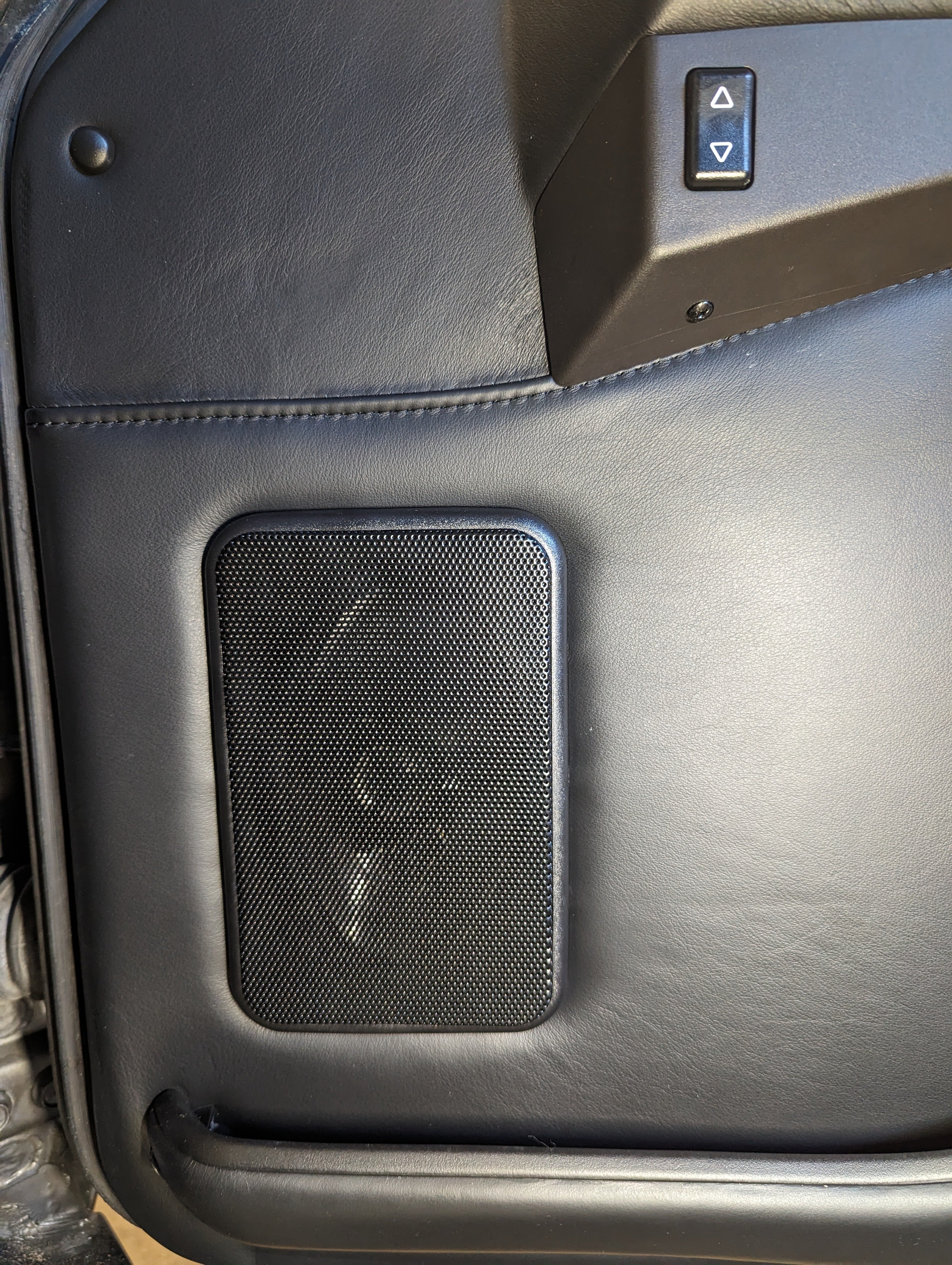

You can gain some space for the fronts by using 993 frames and grills. Gives you more speaker options and still has an OE appearance. I even think it looks cleaner than the original covers. I also replaced the flimsy rubber water guards with some covers that I made; it definitely helped improve the sound.
Grill close up
Grill close up
Speaker cover
Speaker cover
Door panel
Door panel

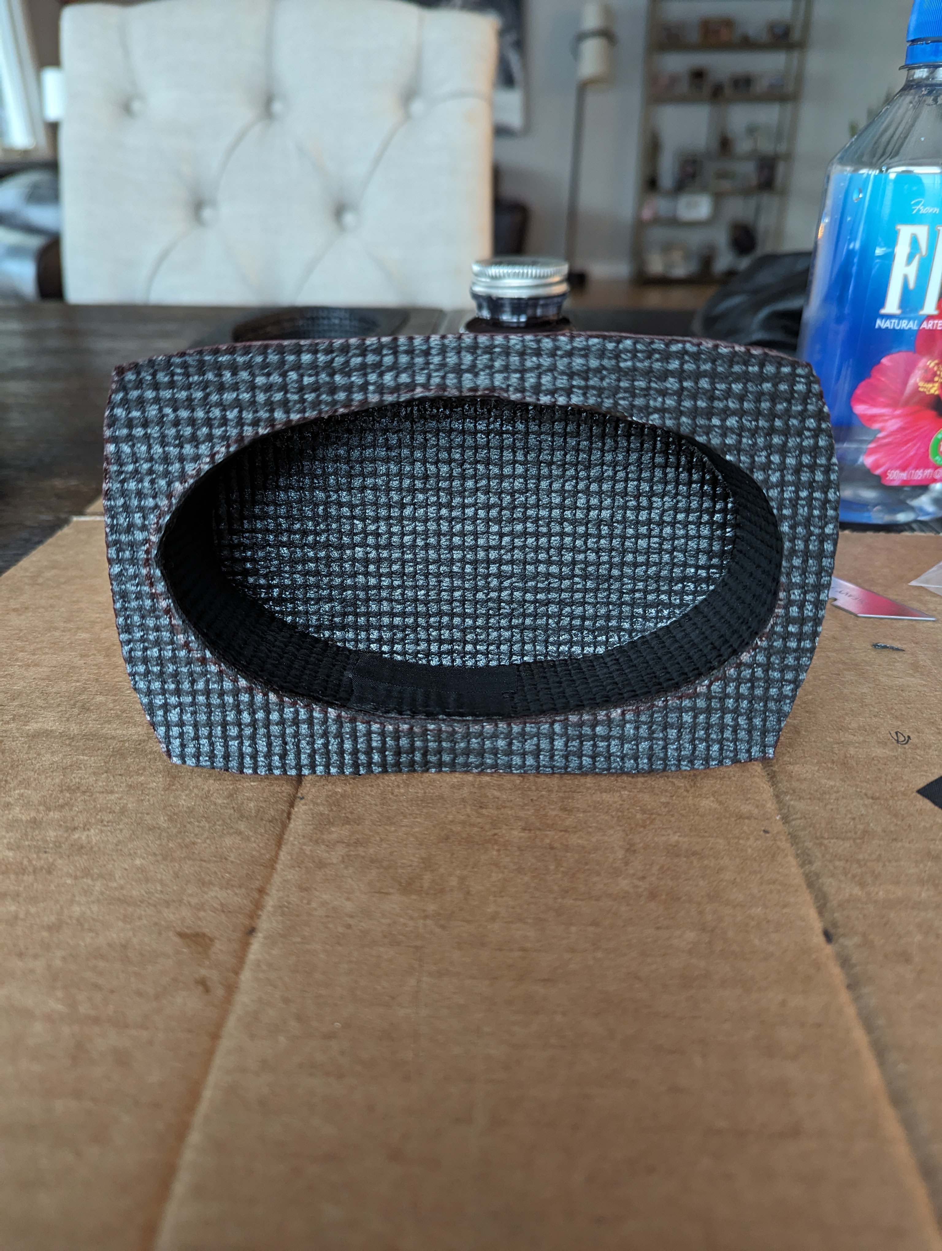

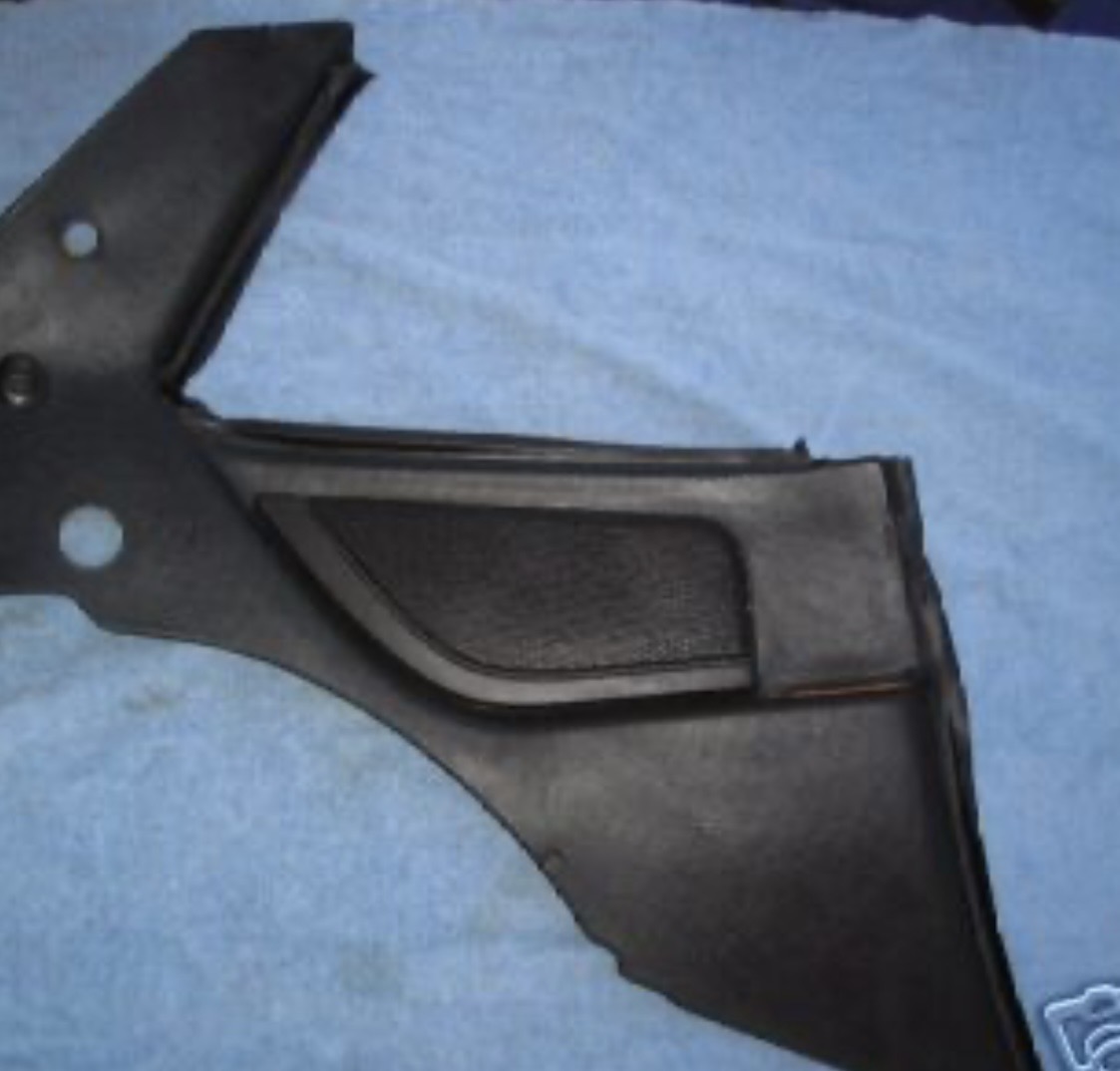

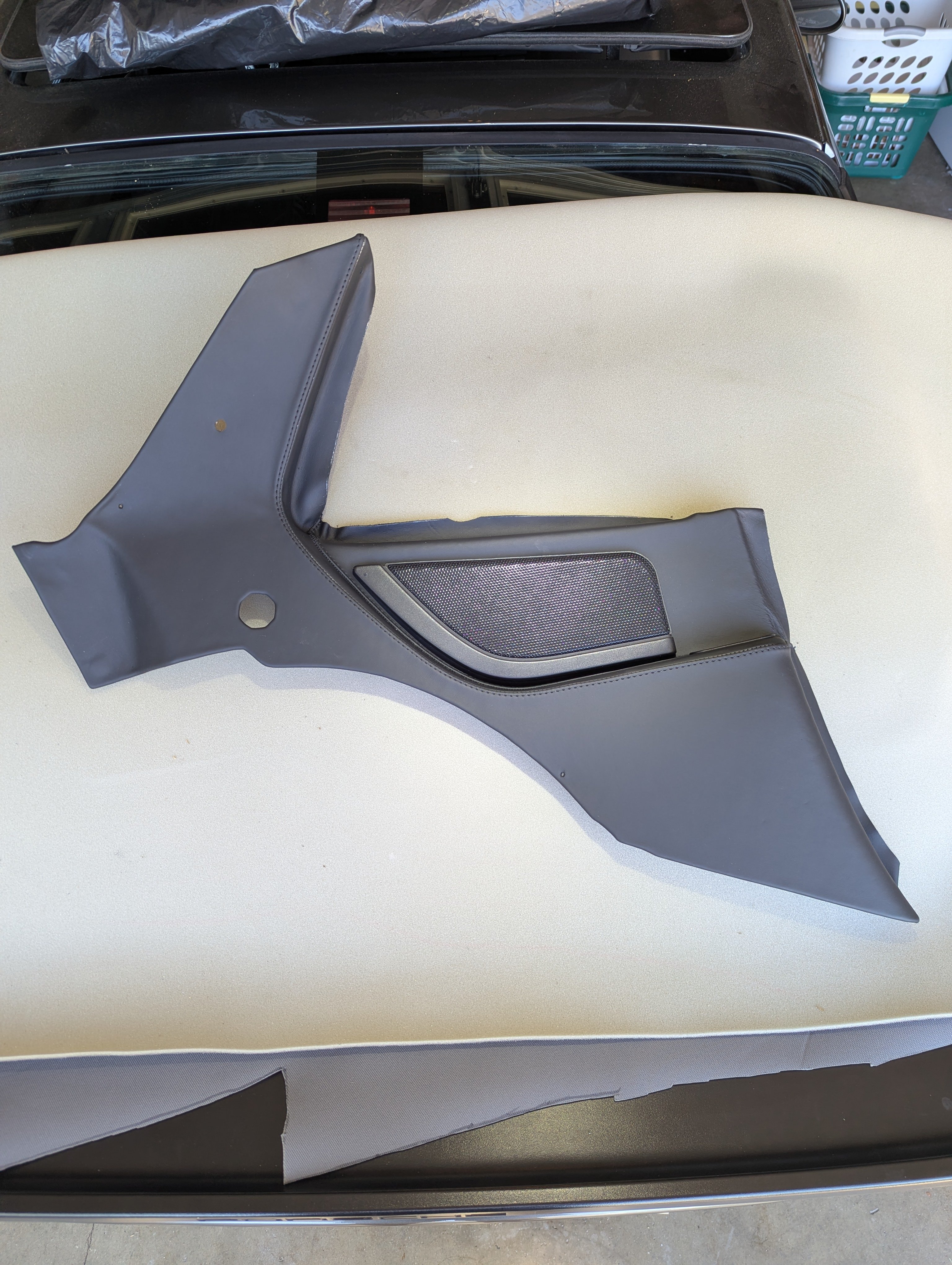

For the rears, I have an 86 so I had to stick with the 4x6's. So I purchased some grills from a later model and cut out the tweeter and excess plastic, then refurbished them. That opened them up and allowed more sound to pass through.
Rear grill cut out
Rear grill cut out
rear grill
rear grill
Rear qtr w/ grill
Rear qtr w/ grill
