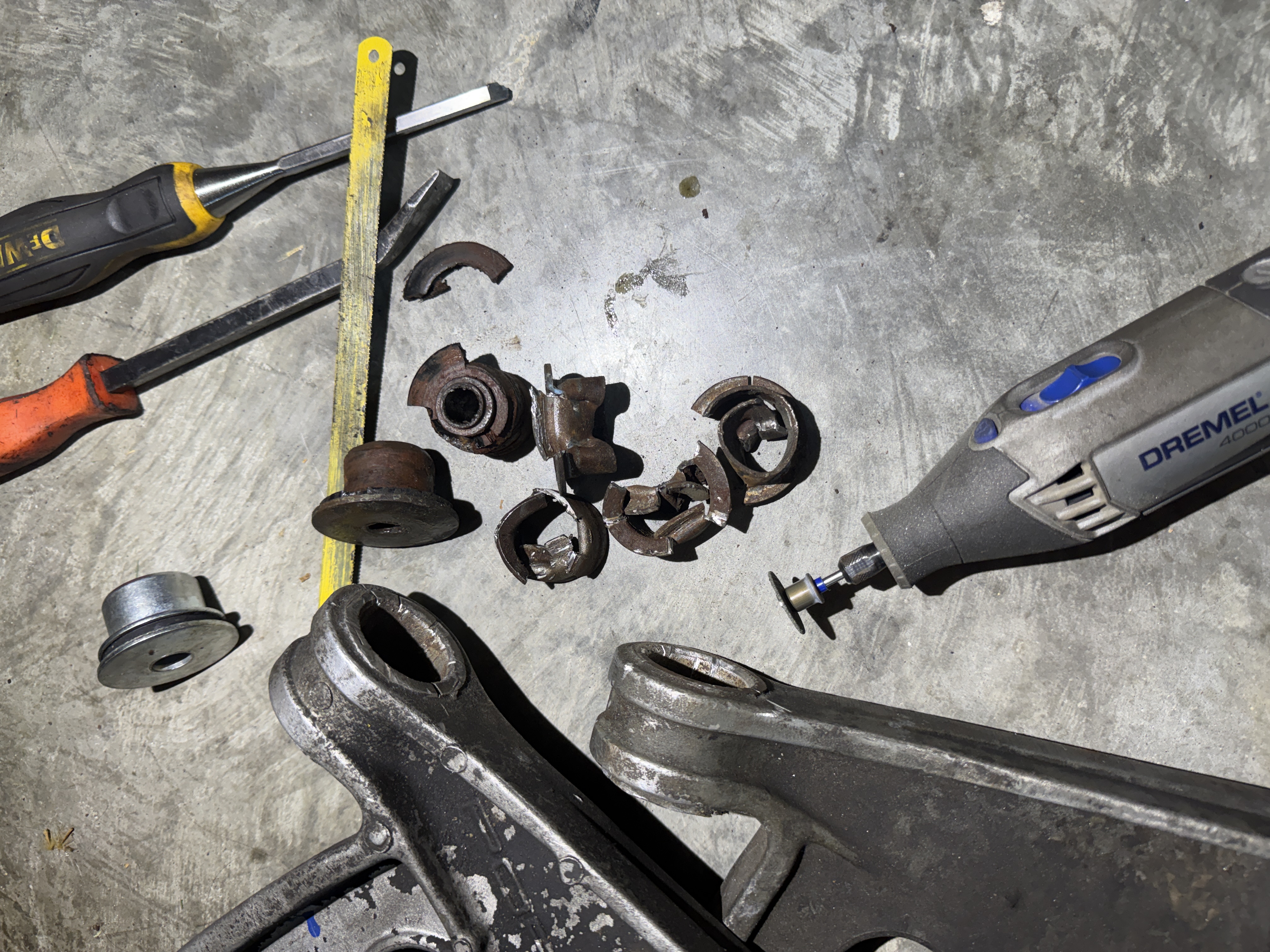

I know these things are subjective and difficult to quantify, but from 1 through 10 with 10 being a lot of NVH and 1 being barely noticeable at all, where would it fall.
The rubber is shot in my bushings. Have a new set but removing the old ones are not budging. Making a mess just bending over the edges if that makes sense. So considering just buying new ones and be done with it. But I hate NVH.

944m3 wrote: Fri Jun 12, 2026 7:11 am.... But I hate NVH.
I think you want to stick with stock then.
Take a propane torch and get the bushing rubber good and hot. (Burning is fine too.) Then the centre metal sleeve should push out with a big screwdriver or something. Now you can insert a hacksaw blade through the hole and carefully cut the outside metal race of the bushing. You don't have to cut all the way through -- once you get close it will release enough pressure that you can pound it out.

That’s what I was thinking, sticking to stock.
The center rubber piece basically fell out on its own. It’s the outer metal part that is killing me lol I even have the tool from Elephant.

Yeah, I've heard mixed reviews on the tool. I got my bushings from Elephant, but I passed on the tool.
But since you have the tool, try just cutting 1/2 way or 2/3 of the way through the outer wall with a hacksaw and then see if the tool will push them out.

I’ll try the hacksaw. I tried using a dremel but not easy. I think the tool in theory should work well but those things almost seem to be welded to the control arm.

That sucked. Another right of passage.
