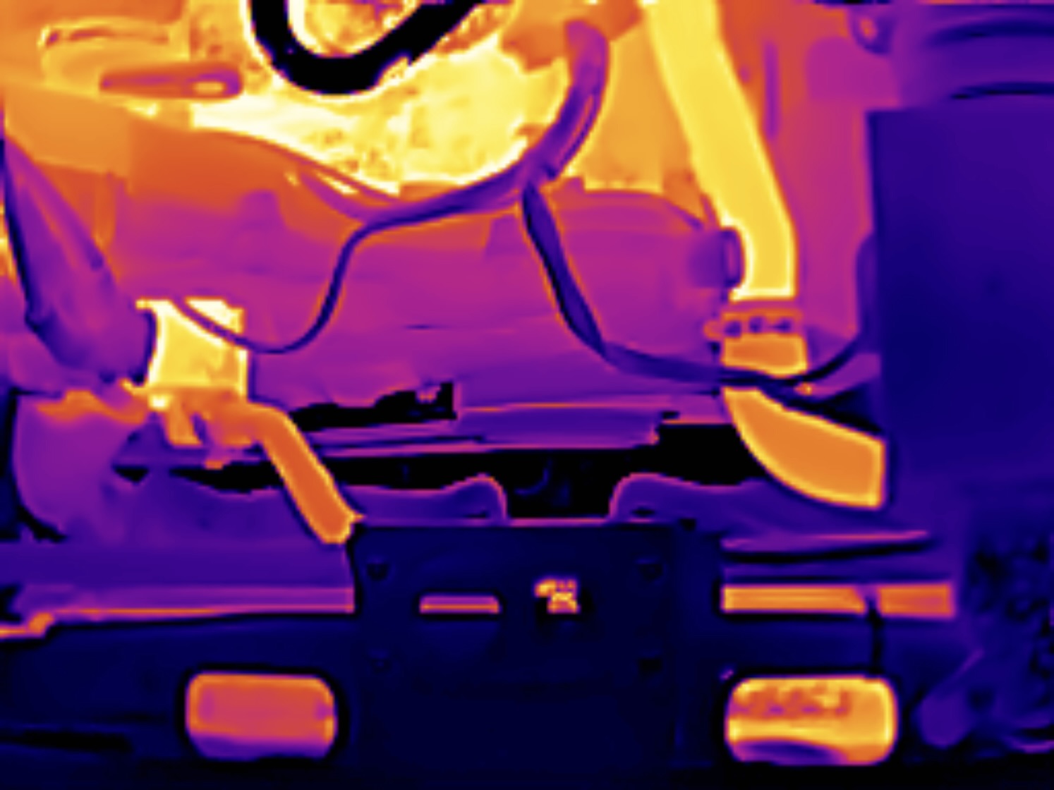

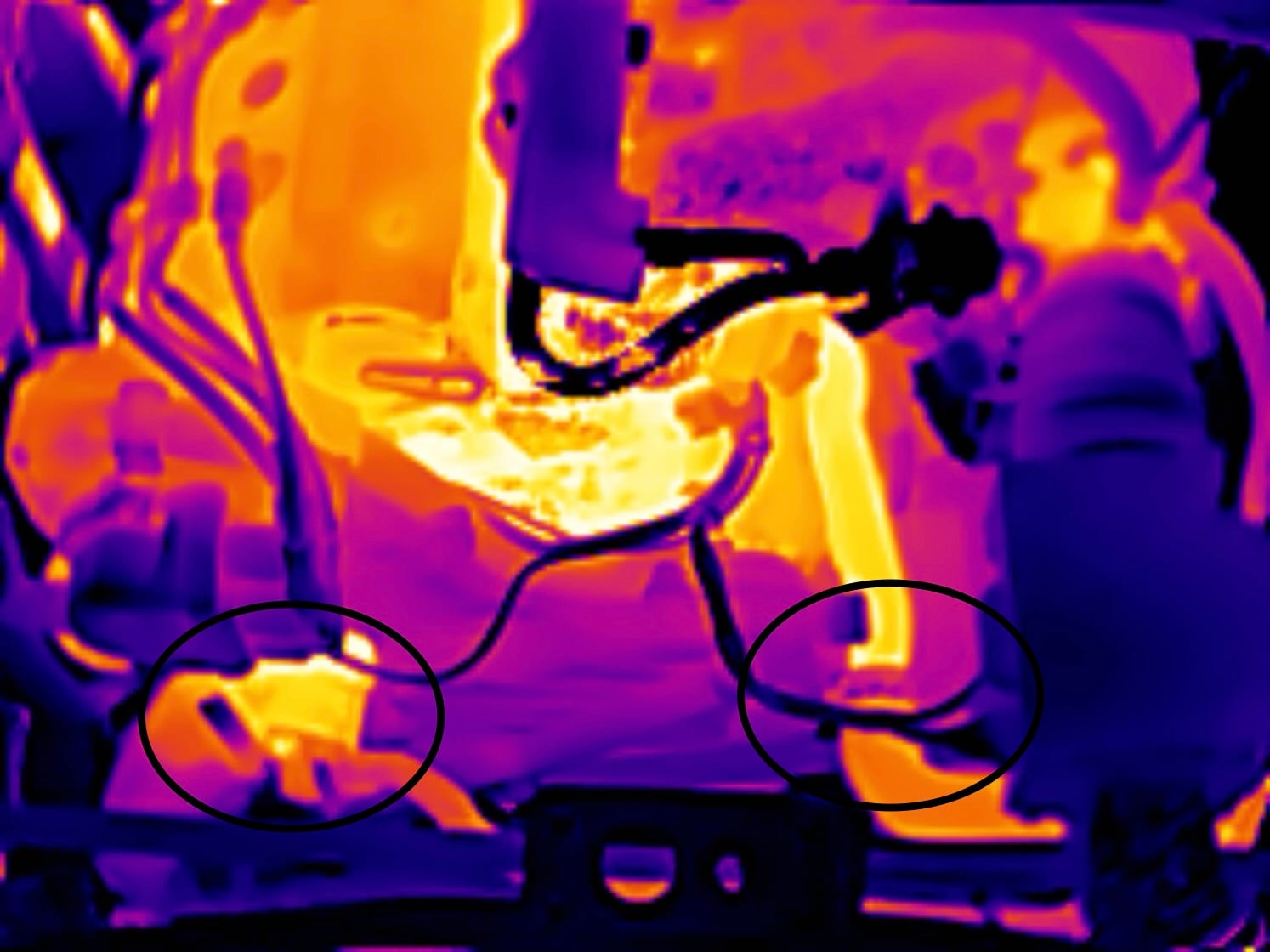

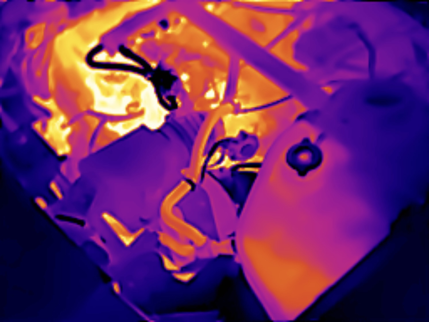

Hi Marc,
Here are a few pics I quickly snapped of my 944S2 engine while idling, using the IR camera attachment mentioned above. I am still figuring out the best way to save and share screen shots---the below are the low-resolution shots saved within the app. If one uses the normal screen shot function of the smart phone, the images are higher-res but show all the menu items within the IR camera app.
I wish I could figure out how to show a scale showing the correlation between the color and temperature, but one can see the general trend by studying the pictures. I also forgot to take a normal reference photo of the engine bay, but I added a couple of black circles to the first pic---the one at the lower right shows the intersection of the metal pipe from the cylinder head coolant outlet (bright yellow) to the upper radiator hose, which demostrates the disparity in IR emissions based on material that you mention. You can see the same at the circle in the lower right corner at intersection of the fat lower radiator hose where it meets the thermostat housing. The metal portion appears to be white hot, but the hose section is demonstrably cooler than the upper hose at the right.
Further proof of coolant flow is shown in the second pic---one can see the hood latch at the bottom center, and can see the top of the radiator through the "windows" to the left and right. The reduction in temperature is clearly demonstrated. The third pic shows the expansion tank and hoses.
You could determine the same with a cheap IR temp gun if you slowly trace the circuit while noting the differences of materials. You can establish a general trend if you do this numerous times and record the readings.

From the IR pics it looks like your thermostat isn't opening maybe? I know you just installed a new one, but maybe faulty.

Dkraven wrote: Wed Jun 03, 2026 11:12 pm From the IR pics it looks like your thermostat isn't opening maybe? I know you just installed a new one, but maybe faulty.
Thanks for the reply, but I posted these pics in an attempt to help the original poster, my pictured 944S2 engine temps are good :).
I can see why you might conclude this from the first pic, as the lower radiator hose inlet appears to be much cooler than the adjacent metal thermostat housing, but this has do to with metal parts having greater IR emissivity than rubber hoses. The proof of coolant flow through the radiator is shown in the second picture (and mentioned in the post above).
The infrared method takes a bit of practice to interpret the system, but with enough study one can establish the general thermal trend. It is quite rare for a thermostat to stick in the closed position, the usual failure mode is they hang open slightly and the engine takes quite a long time to warm up.

this is super helpful thanks! I’ve got one on order - seems a small price to pay for a LOT of troubleshooting info. The good news is my iphone is so old I’m still on a lightning connector, and the compatible cameras are all on clearance, lol

Hey thanks for the explanation, and sorry for not paying attention to who was posting!
