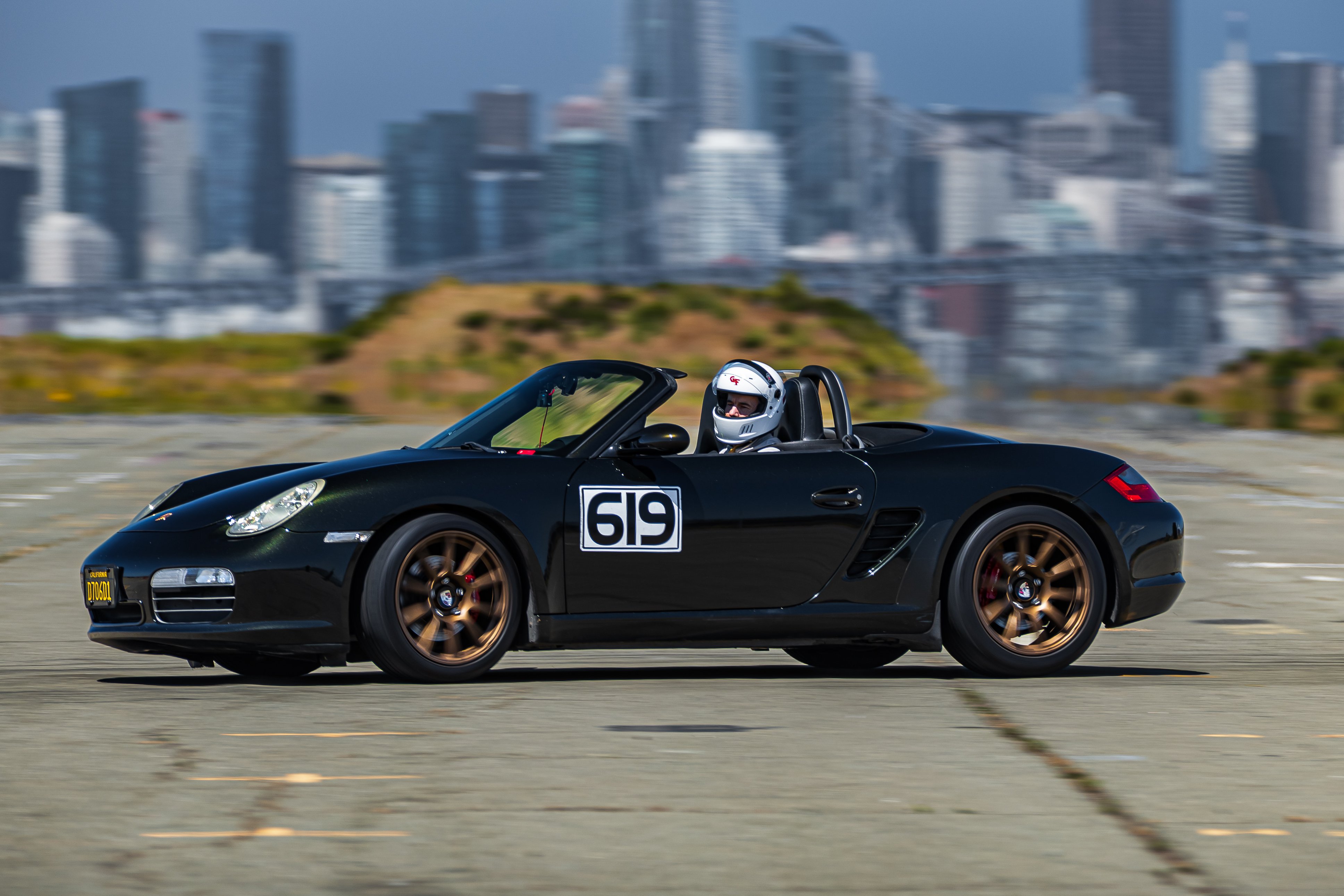

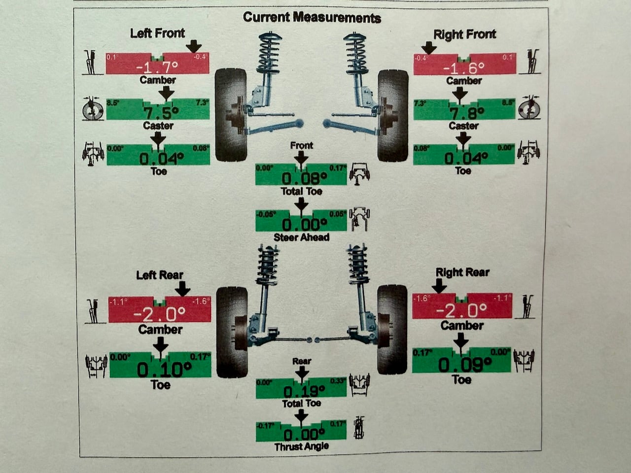

Yesterday was a PCA "Zone" event at Salinas, which meant we did things a little different. Basically, we ran the course in one layout in the morning, then it was sort of reversed (as much as possible given the venue limitations) for the afternoon. And overall rankings were based on the best run from each session.
The pavement did not have a lot of grip, so plenty of slides from everyone. I experienced a lot of oversteer. Someone else in my class compensated by substantially increasing the front tire pressure- to something like 36f/30r. I should have copied him as he finished 1 sec ahead of me 😆
Overall I do find the car pretty tail happy, so I should probably look into possible alignment changes, as there isn't much else I can do without getting bumped out of my class. Happy to hear any suggestions!

Just a wild guess, but maybe try getting the camber square? All four corners close to the same -2.0 (or more if you can get there).

Thanks! The camber is maxed out front and rear, and I’m not sure what would happen with less rear camber. I think the only things I have to play with are camber (within the current range), toe, and tire pressure. Unless I can find a thicker non-adjustable front sway bar. I need to do some research and get a better understanding of how all this stuff works. And maybe look into DIY alignment options so I can run more comparisons.

Thanks for the feedback. I think maybe we've discussed tires before. Right now I'm running Conti ECS02 in 245/40R18 front, 275/40R18 rear on 9x18f and 10x18r Apex wheels.
For my PCA class I can't go any wider. And the choices for 200TW are quite limited in size 275/40R18 (Nankang CR-S, Yoko A052/AD09, Hankook RS-4). Since the season is 60% done I'm not switching tires now; next year I will get something stickier.
There are definitely more options for the rear in 275/35R18. On many of our courses I am already hitting the rev limiter in 2nd, and a shorter rear will make that even more common. Plus I like the way the bigger sidewall looks.
Lots to think about!
