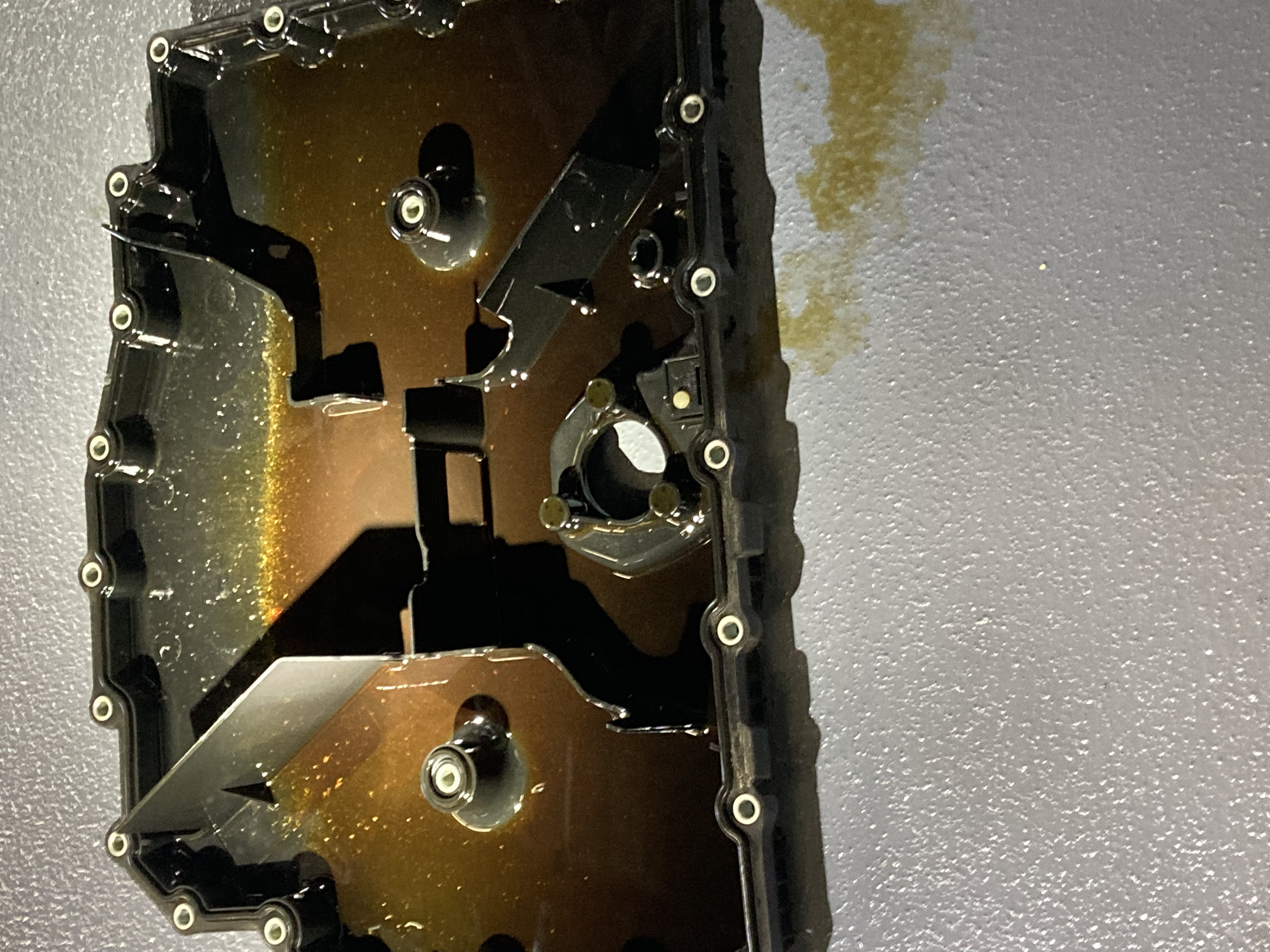

Here's a pic of my oil pan, notice the flecks of metal from who knows what. New engine is on order. [img]

Did they say why they thought it was the oil pump and not the con rod issue? Cool that they let you see the oil pan like that. I assumed Porsche would want those motors sealed up and shielded from mortal eyes until back in Germany for forensics... Not that it helps, but based on the bang you reported, I would have expected even worse in there.

The oil pump is just a guess so far, but based on past experiences I think. They won't know for sure until the engine is opened up, which I assume will be done in Germany.
