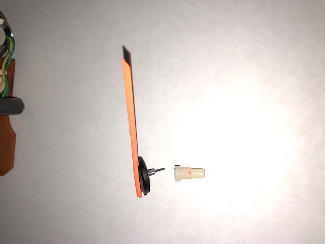

While reassembling the speedometer, I pressed the speedometer needle back on and it was slightly off zero. While carefully removing it again to re-position, it pulled the center pin out of the plastic screw that attaches to the speedometer itself (see pictures).
My plan is to "re-glue" the pin back into the plastic screw (or as a back-up plan, find a donor in-operable speedometer if that doesn't work).
My question is: How tight do you tighten down the plastic screw onto the speedometer? It seems like it should be snug, but I worry that too loose and it will come free and too tight it might either damage the speedometer or cause unnecessary drag on the speedometer mechanism.

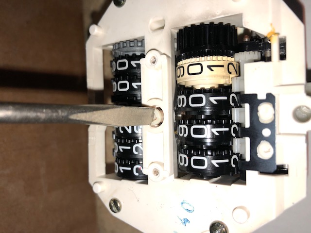

Well...... if yours is like my spare, it looks like you broke the little pin/axle that the needle sits on. The white plastic piece appears to be a bushing to support the outer end of the pin. It was glued in place, but I was able to pick the glue out and get it turning. It does screw in an out, I assume to keep the face pushed out so that the needle is always tight against the face. The bad news is that pin, at least on my spare, is one piece that is connected into the mechanism below. See video. You can't glue the pin in the white bushing, because it needs to rotate inside the there. In theory, you could replace it with a spare like mine, but at some point I suspect it would just be easier to find a used one that works. Resetting the odometer is disturbingly easy if you wanted to keep the miles accurate. Maybe someone else has a better idea, but yours looks broken to me unfortunately.

Thank you so much for tearing down your spare and taking a look. I believe you are absolutely correct. That pin must have actually snapped off in mine.
While that's disappointing, at least I now have a well documented answer.
