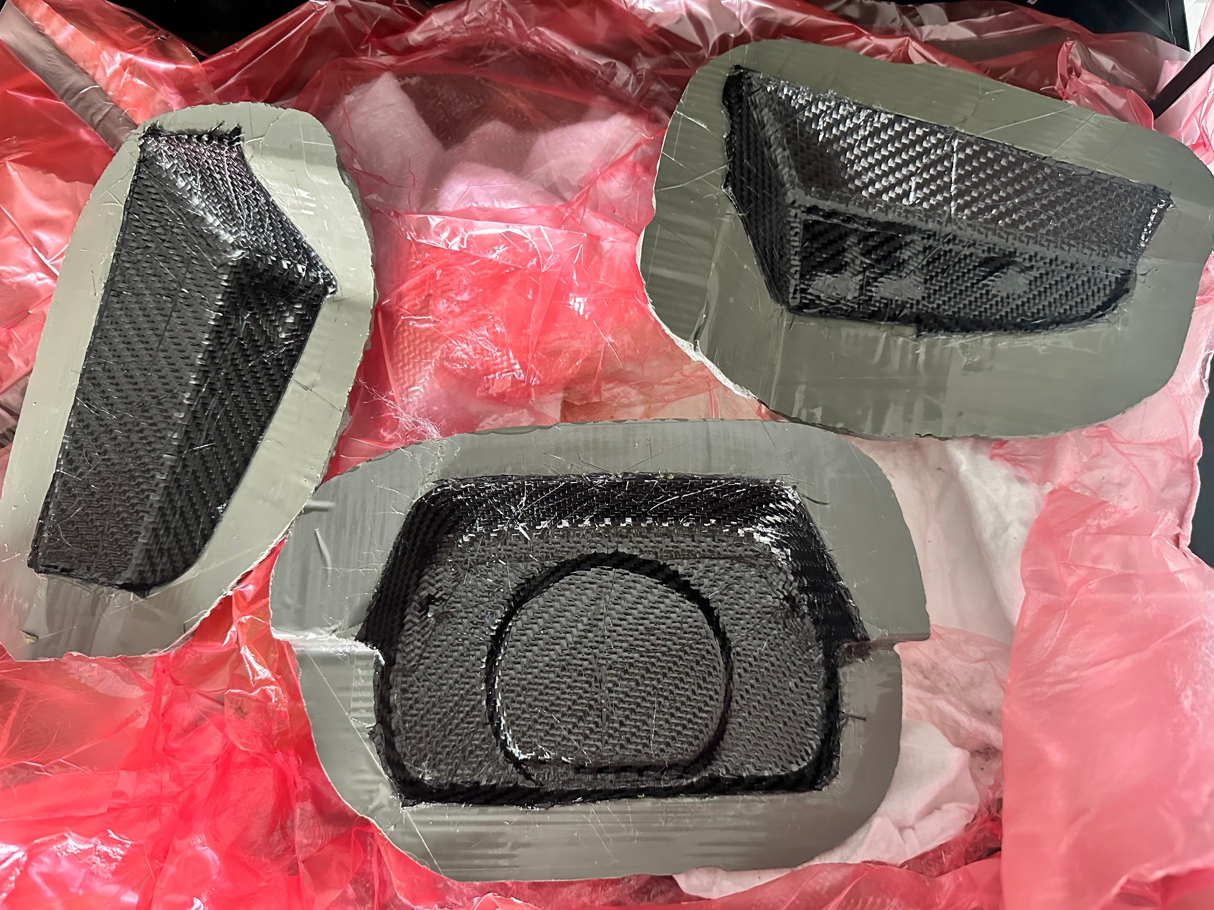

I've embarked on some custom carbon fibre parts for my car. I'm starting with the dash trim a piece that isn't currently available off the shelf. The moulds are around 60% complete at this point.
I'm going for a matt finish; something subtle that lifts the interior without being too in your face. I'll be using prepreg with a satin or matt clear, and whilst there are far easier routes, I was never going to use a wrap or carbon skinned panels.
In the meantime, I had some spare dry carbon lying around, so I knocked up a mould and pulled a couple of front brake air directors between mould making sessions. Really pleased with how they turned out. For those interested, they came in 57g lighter per side.

Very nice. If you ever decide to make more and put them up for sale I'd be interested.

Wow, very nice. Think of the possibilities! :shifty:

Definetly going to make some more parts. In the winter I need to change my wings. I'm going to mould some carbon ones and of course paint to match. They'll be much lighter and wont rust again! I might set up a micro site for 944 carbon parts if things work out well.

How durable do you think the carbon brake scoops are relative to the metal parts?
Can you make a carbon sunroof panel? The factory one is so heavy and now I know why people put their elbows on the roof when installing them (which leaves dents in the roof).

The outer skin of the roof panel is already made of fiberglass, right? Not sure if it will make a meaningful difference to swap fiberglass for carbonfiber.

They are certainly heavy and even more so when everything is bolted on. They are a composite material already but a solid one much like the front/rear bumper which appears to be a sold FGRP type? I probably wont do the sunroof as wight isn't my sole aim on this but maybe in future I would review it.

First pull of the moulds for the door switch panels and the steering column trim.will be trimmed and clear coated soon. This is the back of the units of course :)
