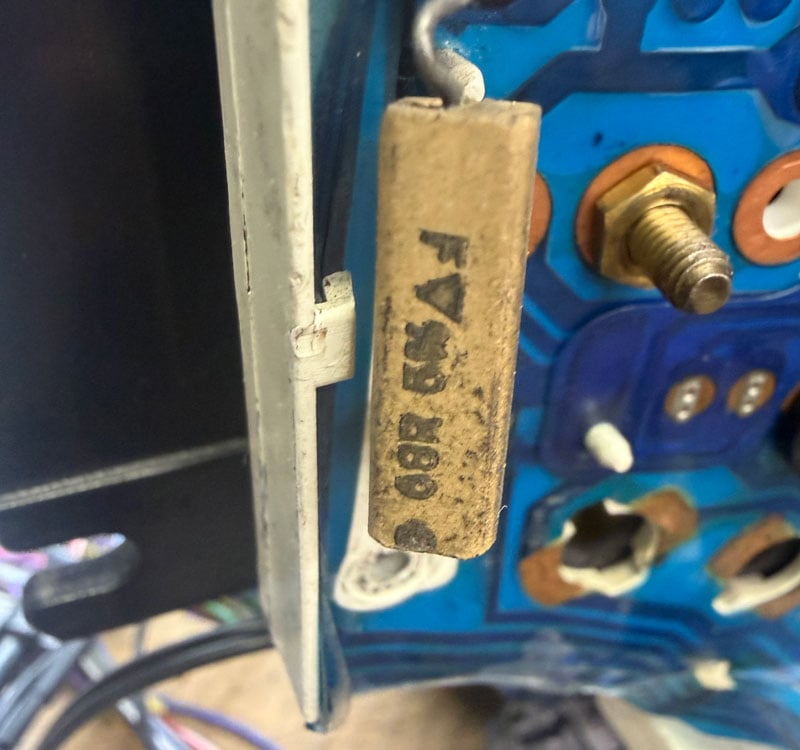

Hi - I have an '87 944 NA that I am slowly bringing back to life. I took the car for a 20 ish mile ride on Friday, parked it and got back in it Sunday afternoon for another 20 ish mile ride. On Sunday when I got in, the part in the picture was sitting in the driver footwell on the right side. The car started right up and everything that worked on Friday and still worked and everything that didn't work, still didn't work. I've been under the under the dash for various projects and never noticed any bad wiring (scotch clips, wire nuts, etc.). This doesn't have any solder marks that I can see. Any idea of this should be somewhere or if this is just random?

Looks like a 68 Ohm 5% resistor. It likely is just random however someone may have been using that to fix a two speed radiator fan controller function or something similar. I would add it to your parts stash as one day maybe you will need to make a voltage divider circuit.

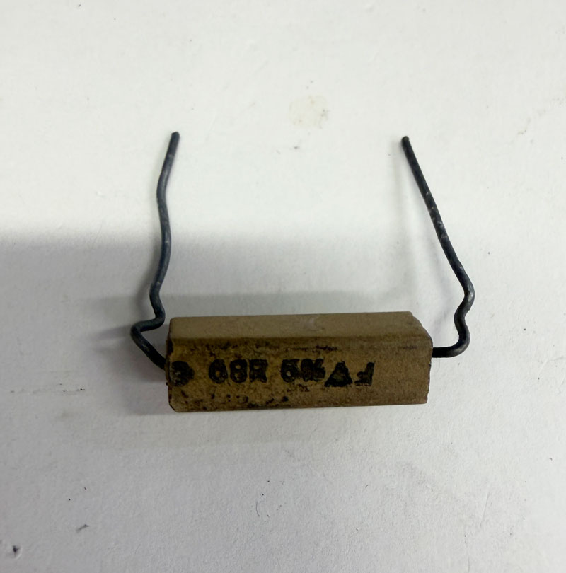

That’s an important resistor that fell out of the back of your instrument cluster. It sits in parallel with the alternator warning light and is part of the alternator exciter circuit. The resistor provides a current path to the exciter wire even if the bulb burns out, and also adds extra current to help ensure the alternator begins charging reliably.

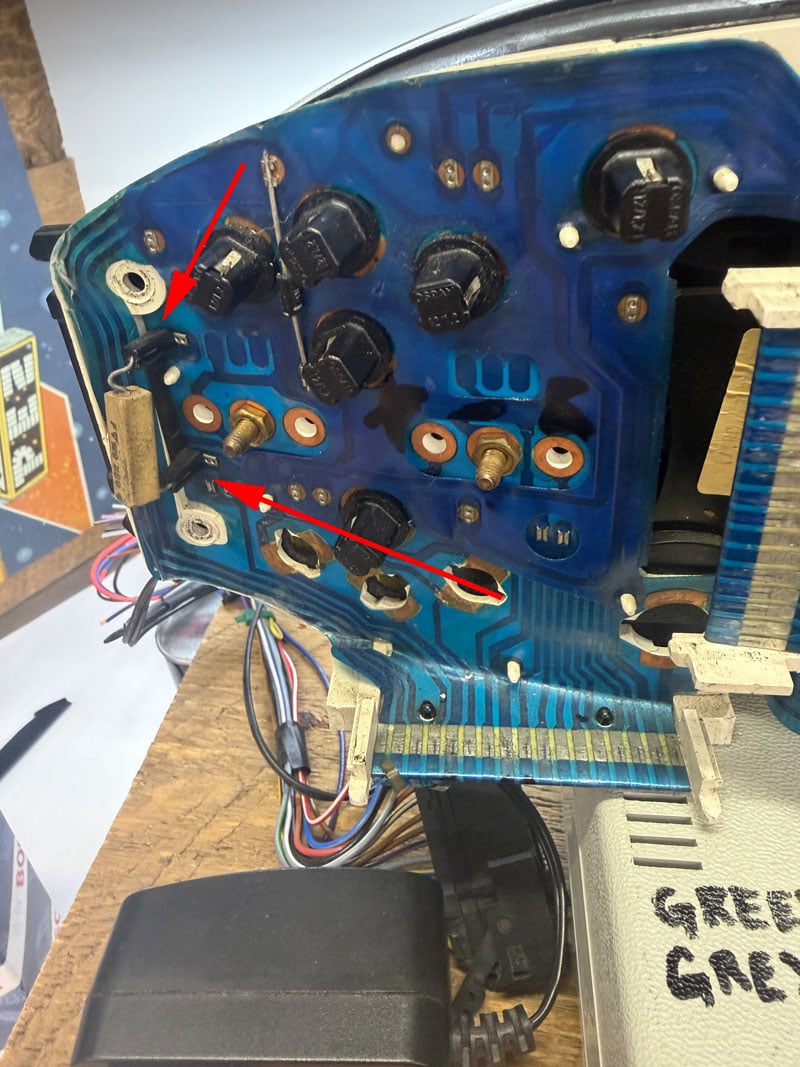

It plugs into two little individual sockets behind the voltmeter. If you pull your cluster, you should be able to plug it back into place. See pictures below.
I’d take the time to do that to make sure the alternator is working as designed. You might clean the leads with fine sandpaper or the like, and put a few small kinks in the leads so the sockets grip them better and it doesn’t keep falling out. You might also check it with a multimeter before putting it back in, just to make sure it’s still working. If not, you can replace it with another 68 ohm resistor, but be sure it’s rated for at least 5 watts, or 4 watts at the very minimum. It can pass a little over 0.2 amps and dissipate a few watts when the alternator warning circuit is active.

Exactly that - missing! Thank you so much!!

That resistor caught my attention while diagnosing cluster issues, primarily because of the way it's socket mounted. Can't say I can recall seeing a socket mounted resistor in a final product before. My guess is they couldn't solder to the flexible circuit board. For the big diodes on the flexible pcb, they used interesting little crimp clips presumably for the same reason. For the resistor, I suspect they were worried about heat from the resistor so mounted it in those little sleeve sockets so the heat wouldn't compromise the membrane over time... Just a theory.
