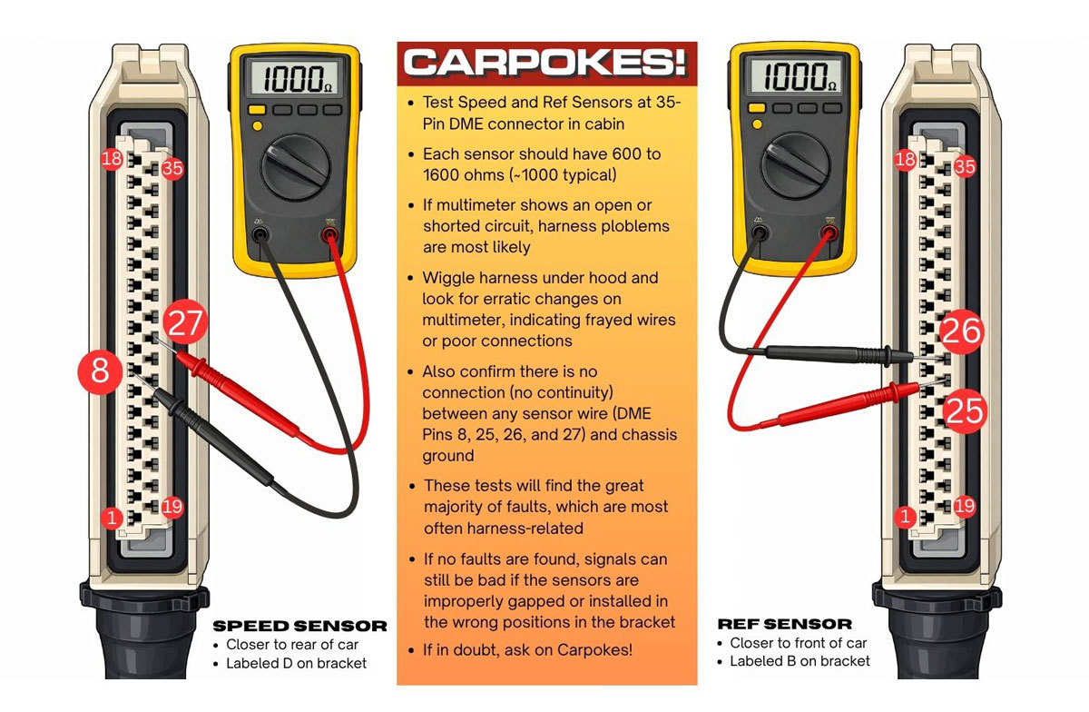

As part of a new 944 Handbook entry found here, I did this quick visual guide on how to test the Speed and Reference Sensors. Opening this thread to give people a place to comment and/or ask questions. :)
