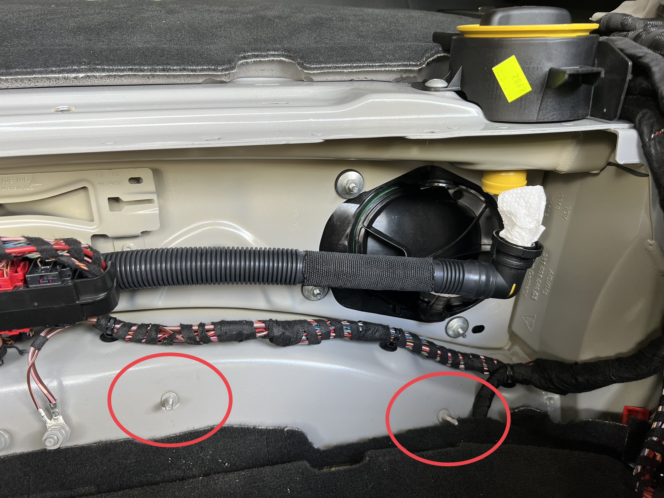

Today I successfully replaced the engine air filters on my CGTS4.0.
First, some disassembly photos. 6 trim pieces need to come out.

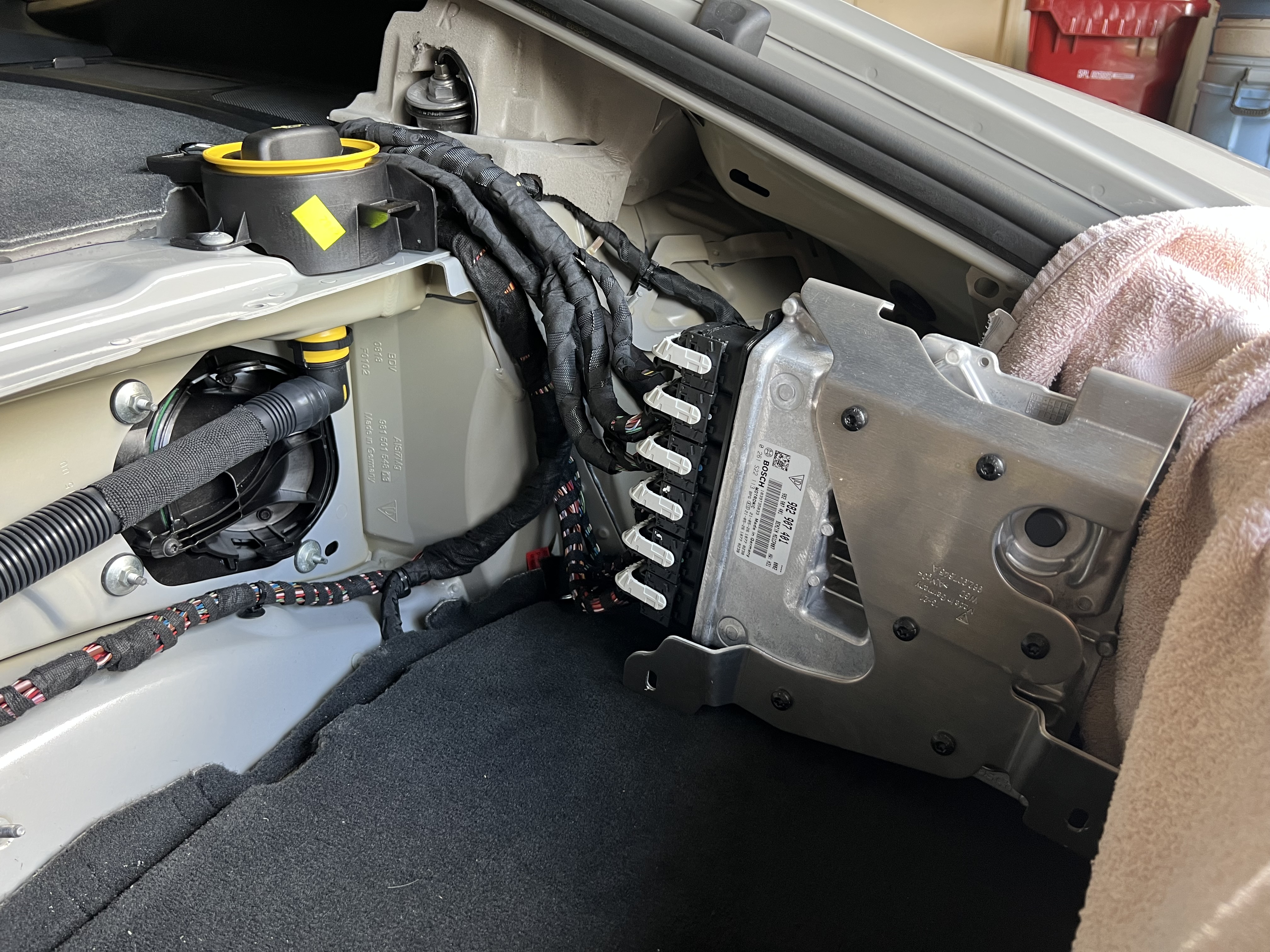

ECU dismounted and placed to the side. Note that the lower mount points are different from the widely viewed YouTube video of the 981 GT4. On my car the lower mounts are nuts on rather large posts. The 10mm socket I had was not quite deep enough to accommodate the posts, but I managed.

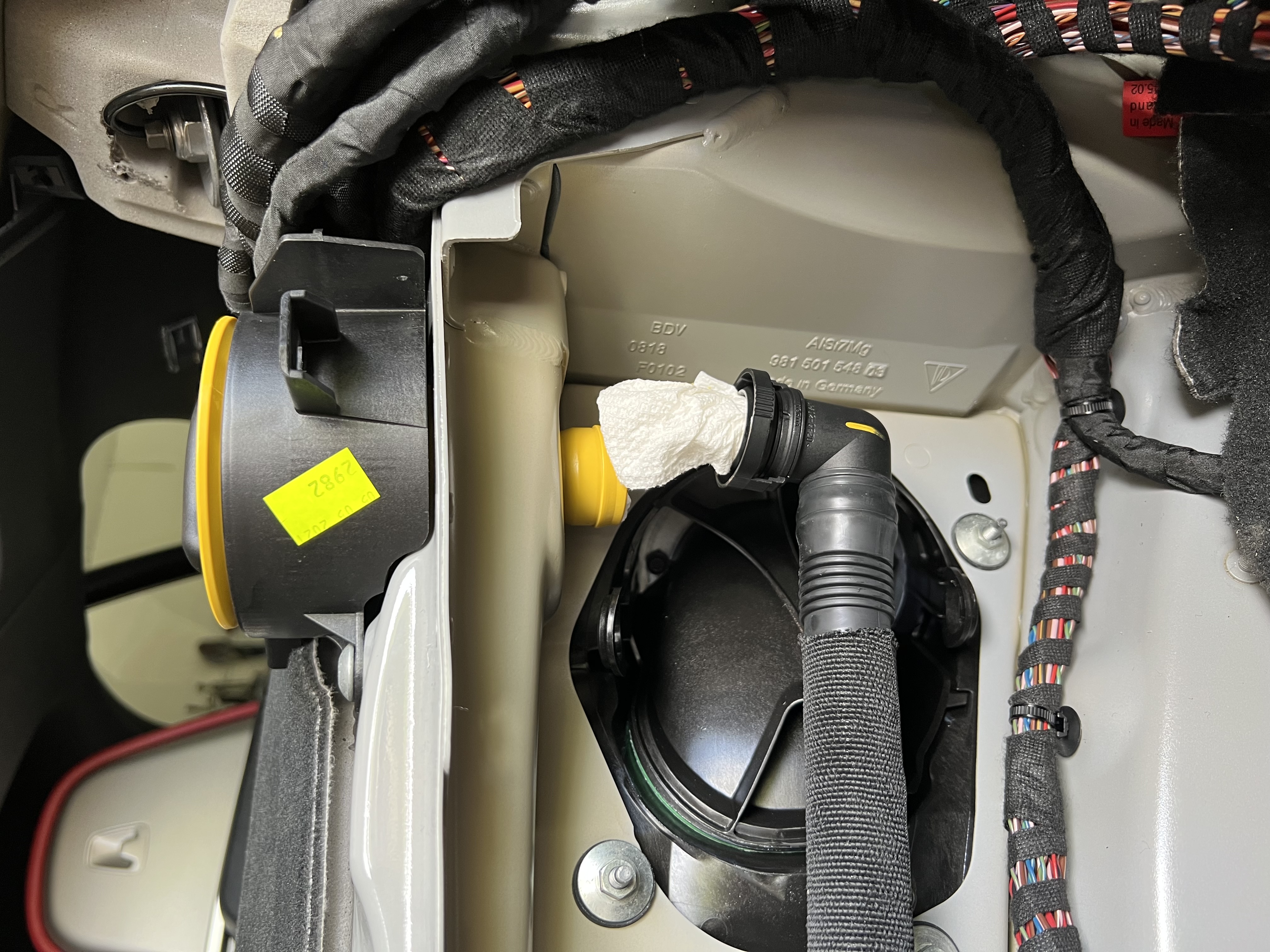

Oil filler detached and plugged with paper towels.

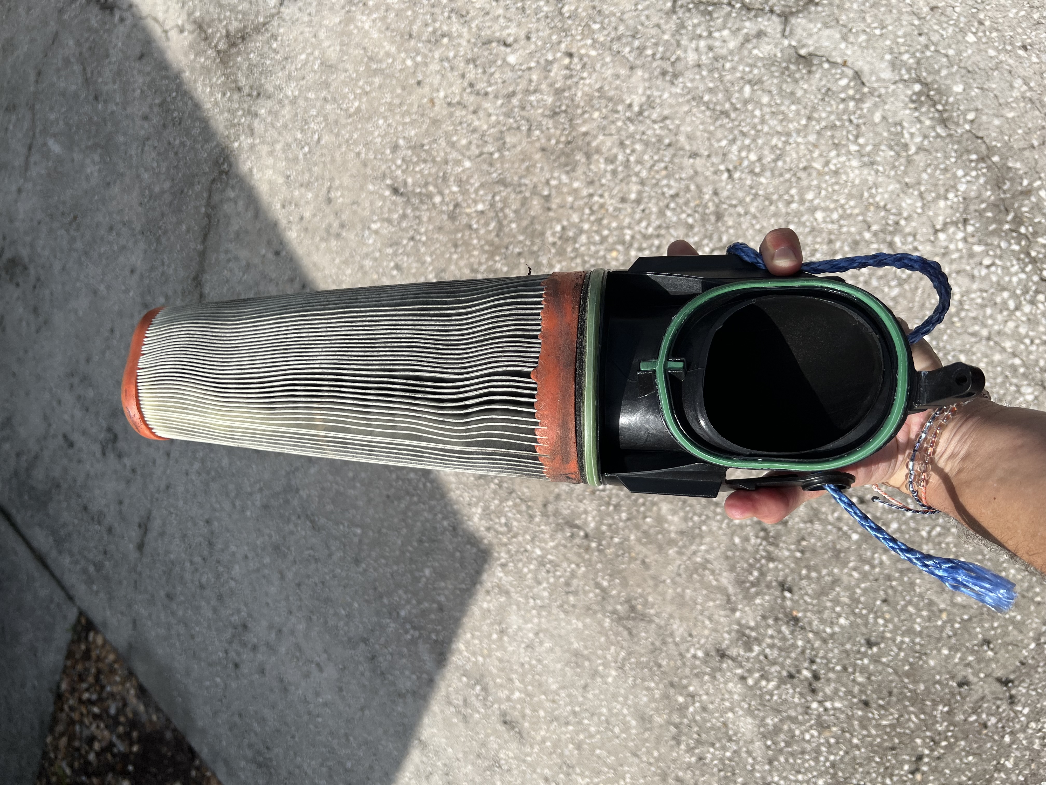

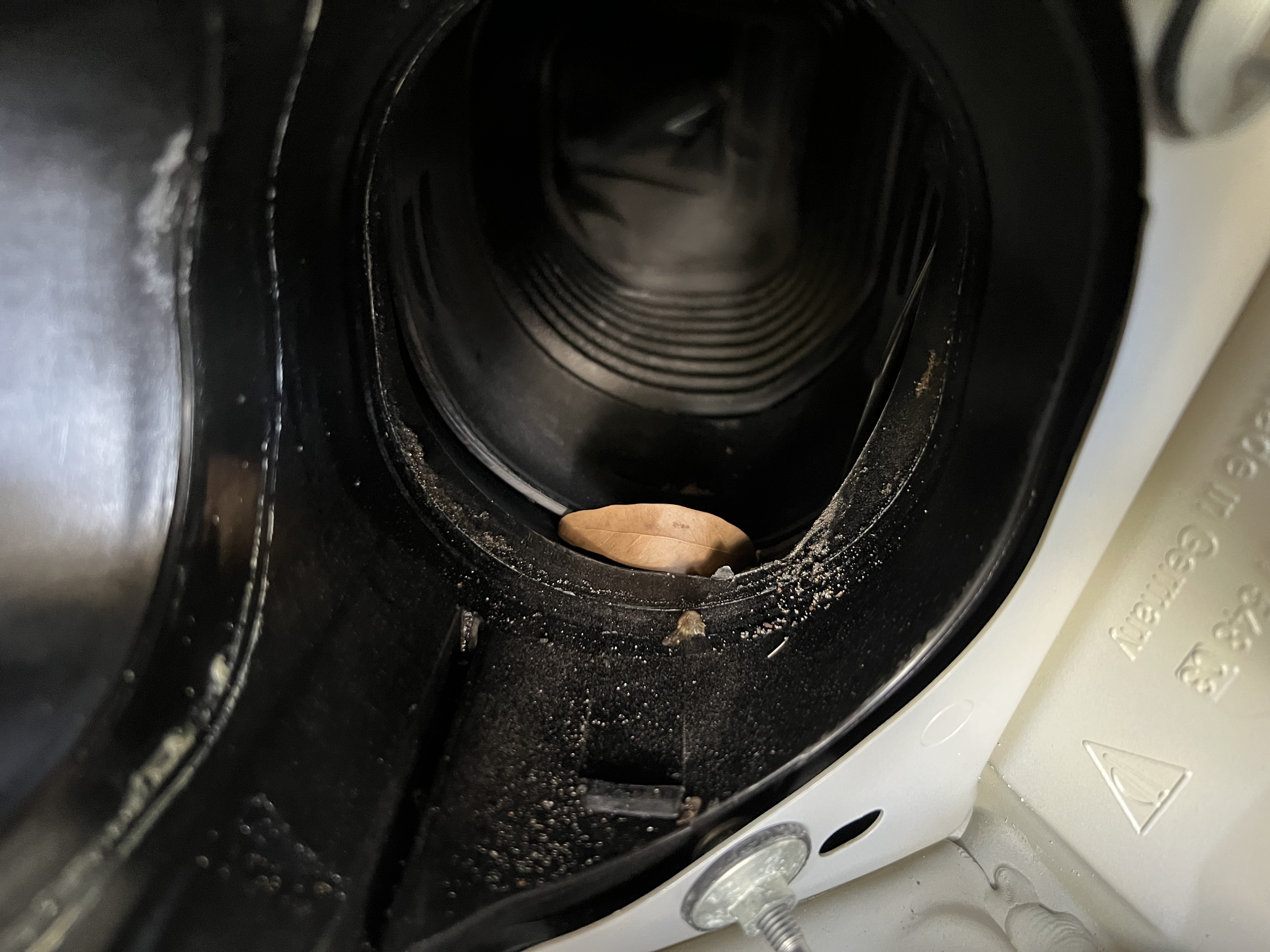

After removing the filters you can see things were quite dirty after 20,000 miles.

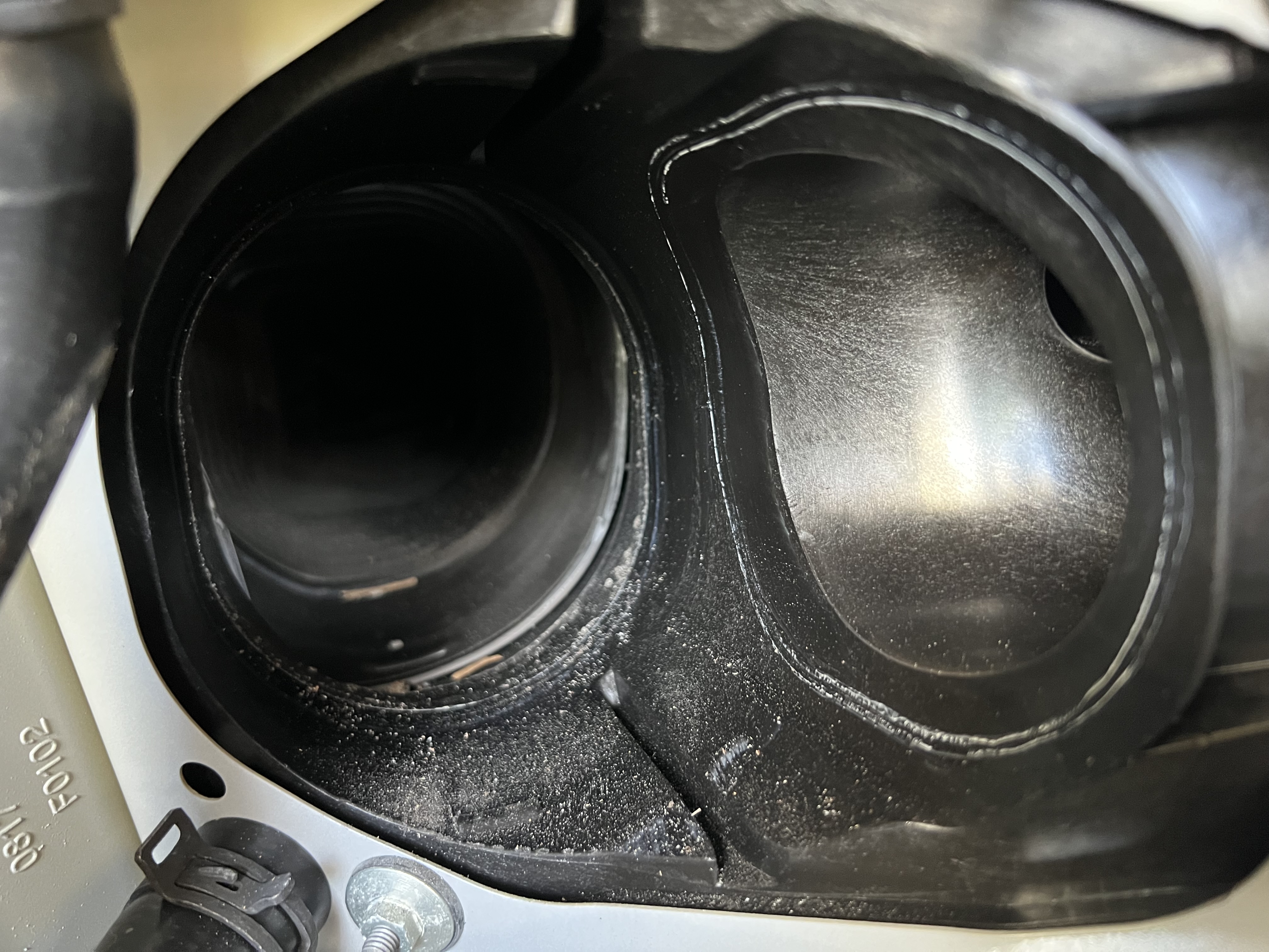

One of the new BMCs mounted.

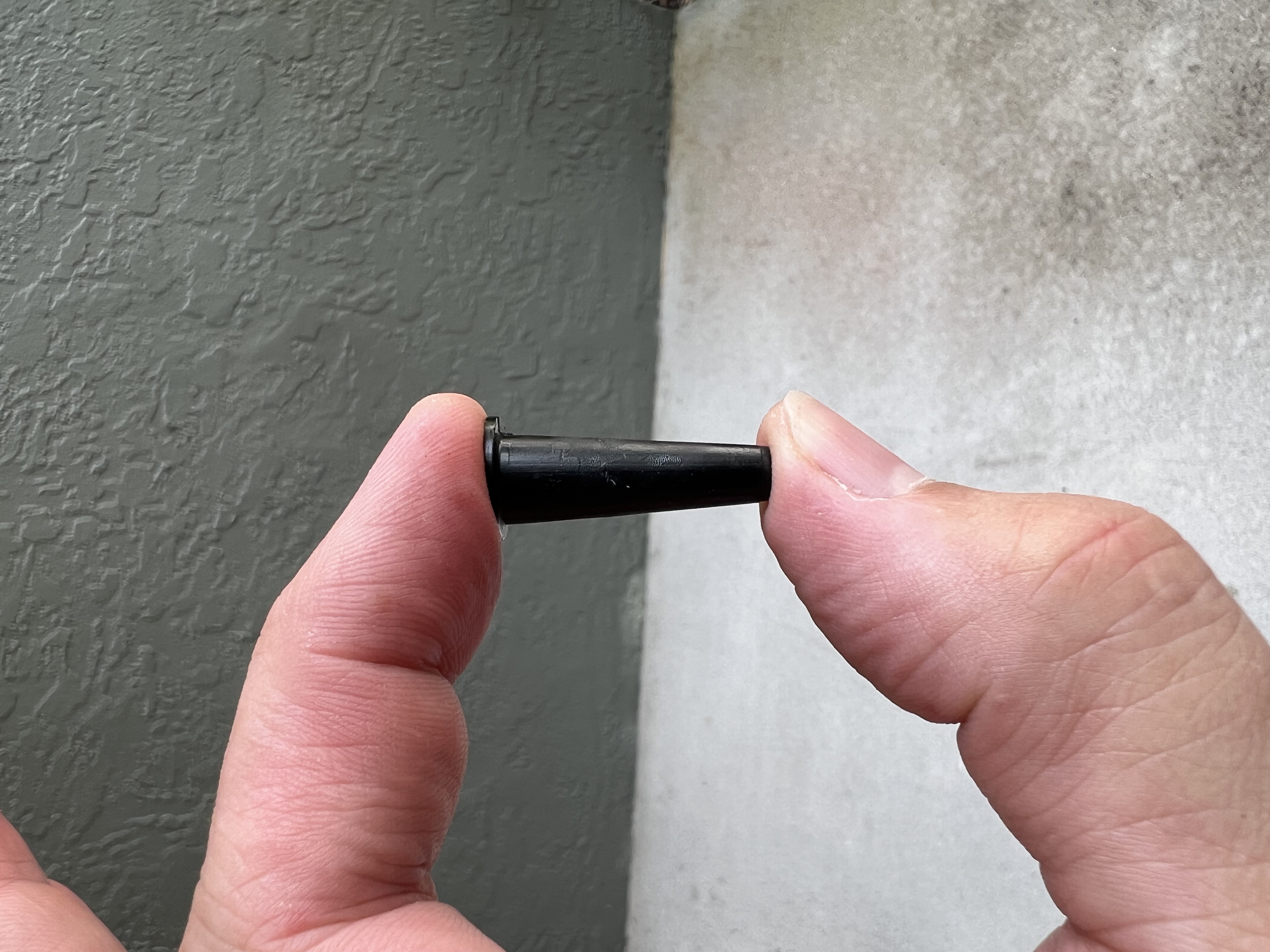

Now for the biggest tip. All the guide posts for the trim pieces have these silly cones that fit very loosely and are easily lost - dumb design. If you try to put the panels back on with the cones in place on the panels, or in their respective holes, you’re sure to lose one or more. I placed a tiny piece of blue poster-tack in each cone and jammed it on the post to keep it in place - no problems!

A cone shown next to its post followed by the cone with some poster-tack.
